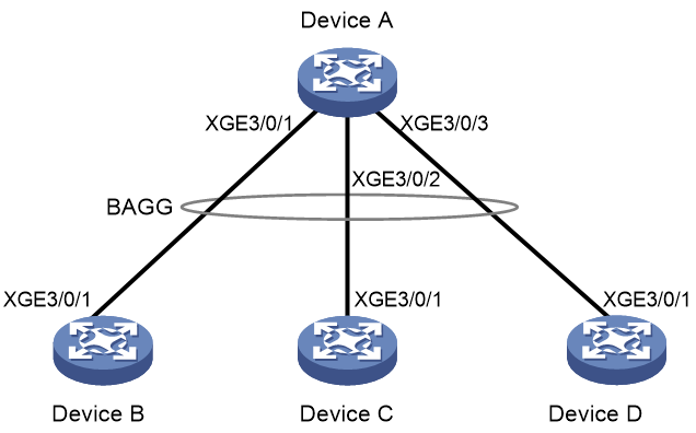

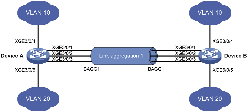

Ethernet link aggregation application scenario
As shown in Figure 1, Device A and Device B are connected by three physical Ethernet links. These physical Ethernet links are combined into an aggregate link called link aggregation 1. The bandwidth of this aggregate link can reach up to the total bandwidth of the three physical Ethernet links. At the same time, the three Ethernet links back up one another. When a physical Ethernet link fails, the traffic transmitted on the failed link is switched to the other two links.
Figure 1 Ethernet link aggregation diagram

S-MLAG
Simple multichassis link aggregation (S-MLAG) enhances dynamic link aggregation to establish an aggregation that spans multiple standalone devices to a remote device.
An S-MLAG multichassis aggregation connects one dynamic Layer 2 aggregate interface on each S-MLAG device to the remote device, as shown in Figure 5.
S-MLAG uses an S-MLAG group to manage the aggregate interfaces for each aggregation, and it runs LACP to maintain each aggregation as does dynamic link aggregation. To the remote device, the S-MLAG devices appear as one peer aggregation system.
Use S-MLAG only to establish aggregate links with servers.
Figure 5 S-MLAG application scenario

Example: Configuring a Layer 2 static aggregation group
On the network shown in Figure 6, perform the following tasks:
·     Configure a Layer 2 static aggregation group on both Device A and Device B.
·     Enable VLAN 10 at one end of the aggregate link to communicate with VLAN 10 at the other end.
·     Enable VLAN 20 at one end of the aggregate link to communicate with VLAN 20 at the other end.
Figure 6 Network diagram
1.     Configure Device A:
# Create VLAN 10, and assign port Ten-GigabitEthernet 3/0/4 to VLAN 10.
<DeviceA> system-view
[DeviceA] vlan 10
[DeviceA-vlan10] port ten-gigabitethernet 3/0/4
[DeviceA-vlan10] quit
# Create VLAN 20, and assign port Ten-GigabitEthernet 3/0/5 to VLAN 20.
[DeviceA] vlan 20
[DeviceA-vlan20] port ten-gigabitethernet 3/0/5
[DeviceA-vlan20] quit
# Create Layer 2 aggregate interface Bridge-Aggregation 1.
[DeviceA] interface bridge-aggregation 1
[DeviceA-Bridge-Aggregation1] quit
# Assign ports Ten-GigabitEthernet 3/0/1 through Ten-GigabitEthernet 3/0/3 to link aggregation group 1.
[DeviceA] interface ten-gigabitethernet 3/0/1
[DeviceA-Ten-GigabitEthernet3/0/1] port link-aggregation group 1
[DeviceA-Ten-GigabitEthernet3/0/1] quit
[DeviceA] interface ten-gigabitethernet 3/0/2
[DeviceA-Ten-GigabitEthernet3/0/2] port link-aggregation group 1
[DeviceA-Ten-GigabitEthernet3/0/2] quit
[DeviceA] interface ten-gigabitethernet 3/0/3
[DeviceA-Ten-GigabitEthernet3/0/3] port link-aggregation group 1
[DeviceA-Ten-GigabitEthernet3/0/3] quit
# Configure Layer 2 aggregate interface Bridge-Aggregation 1 as a trunk port and assign it to VLANs 10 and 20.
[DeviceA-Bridge-Aggregation1] port link-type trunk
[DeviceA-Bridge-Aggregation1] port trunk permit vlan 10 20
2.     Configure Device B in the same way Device A is configured. (Details not shown.)
# Display detailed information about all aggregation groups on Device A.
[DeviceA] display link-aggregation verbose
Loadsharing Type: Shar -- Loadsharing, NonS -- Non-Loadsharing
Port Status: S -- Selected, U -- Unselected, I -- Individual
Port: A -- Auto port, M -- Management port, R -- Reference port
Flags:  A -- LACP_Activity, B -- LACP_Timeout, C -- Aggregation,
        G -- Defaulted, H -- Expired
Aggregate Interface: Bridge-Aggregation1
Aggregation Mode: Static
Management VLANs: None
  Port             Status  Priority Oper-Key
  XGE3/0/1(R)      S       32768    1
  XGE3/0/2         S       32768    1
  XGE3/0/3         S       32768    1

Example: Configuring a Layer 2 dynamic aggregation group
On the network shown in Figure 7, perform the following tasks:
·     Configure a Layer 2 dynamic aggregation group on both Device A and Device B.
Figure 7 Network diagram
# Create VLAN 10, and assign the port Ten-GigabitEthernet 3/0/4 to VLAN 10.
[DeviceA] vlan 10
# Create VLAN 20, and assign the port Ten-GigabitEthernet 3/0/5 to VLAN 20.
[DeviceA] vlan 20
# Create Layer 2 aggregate interface Bridge-Aggregation 1, and set the link aggregation mode to dynamic.
[DeviceA-Bridge-Aggregation1] link-aggregation mode dynamic
Creation Mode: Manual
Aggregation Mode: Dynamic
System ID: 0x8000, 000f-e267-6c6a
Local:
  Port                Status   Priority Index    Oper-Key               Flag
  XGE3/0/1(R)         S        32768    11       1                      {ACDEF}
  XGE3/0/2            S        32768    12       1                      {ACDEF}
  XGE3/0/3            S        32768    13       1                      {ACDEF}
Remote:
  Actor               Priority Index    Oper-Key SystemID               Flag
  XGE3/0/1            32768    81       1        0x8000, 000f-e267-57ad {ACDEF}
  XGE3/0/2            32768    82       1        0x8000, 000f-e267-57ad {ACDEF}
  XGE3/0/3            32768    83       1        0x8000, 000f-e267-57ad {ACDEF}
The output shows that link aggregation group 1 is a Layer 2 dynamic aggregation group that contains three Selected ports.

Example: Configuring S-MLAG
Device B, Device C, and Device D are standalone devices. As shown in Figure 11, configure Device B, Device C, and Device D as S-MLAG devices to establish a multidevice aggregate link with Device A.
Figure 11 Network diagram
# Create Layer 2 aggregate interface Bridge-Aggregation 10, and set the link aggregation mode to dynamic.
[DeviceA] interface bridge-aggregation 10
[DeviceA-Bridge-Aggregation10] link-aggregation mode dynamic
[DeviceA-Bridge-Aggregation10] quit
# Assign Ten-GigabitEthernet 3/0/1 through Ten-GigabitEthernet 3/0/3 to aggregation group 10.
[DeviceA-Ten-GigabitEthernet3/0/1] port link-aggregation group 10
[DeviceA-Ten-GigabitEthernet3/0/2] port link-aggregation group 10
[DeviceA-Ten-GigabitEthernet3/0/3] port link-aggregation group 10
2.     Configure Device B:
# Set the LACP system MAC address to 0001-0001-0001.
<DeviceB> system-view
[DeviceB] lacp system-mac 1-1-1
# Set the LACP system priority to 123.
[DeviceB] lacp system-priority 123
# Set the LACP system number to 1.
[DeviceB] lacp system-number 1
# Create Layer 2 aggregate interface Bridge-Aggregation 2, and set the link aggregation mode to dynamic.
[DeviceB] interface bridge-aggregation 2
[DeviceB-Bridge-Aggregation2] link-aggregation mode dynamic
# Assign Bridge-Aggregation 2 to S-MLAG group 100.
[DeviceB-Bridge-Aggregation2] port s-mlag group 100
# Assign Ten-GigabitEthernet 3/0/1 to aggregation group 2.
[DeviceB] interface ten-gigabitethernet 3/0/1
[DeviceB-Ten-GigabitEthernet3/0/1] port link-aggregation group 2
[DeviceB-Ten-GigabitEthernet3/0/1] quit
3.     Configure Device C:
<DeviceC> system-view
[DeviceC] lacp system-mac 1-1-1
[DeviceC] lacp system-priority 123
# Set the LACP system number to 2.
[DeviceC] lacp system-number 2
# Create Layer 2 aggregate interface Bridge-Aggregation 3, and set the link aggregation mode to dynamic.
[DeviceC] interface bridge-aggregation 3
[DeviceC-Bridge-Aggregation3] link-aggregation mode dynamic
# Assign Bridge-Aggregation 3 to S-MLAG group 100.
[DeviceC-Bridge-Aggregation3] port s-mlag group 100
# Assign Ten-GigabitEthernet 3/0/1 to aggregation group 3.
[DeviceC] interface ten-gigabitethernet 3/0/1
[DeviceC-Ten-GigabitEthernet3/0/1] port link-aggregation group 3
[DeviceC-Ten-GigabitEthernet3/0/1] quit
4.     Configure Device D:
<DeviceD> system-view
[DeviceD] lacp system-mac 1-1-1
[DeviceD] lacp system-priority 123
# Set the LACP system number to 3.
[DeviceD] lacp system-number 3
# Create Layer 2 aggregate interface Bridge-Aggregation 4, and set the link aggregation mode to dynamic.
[DeviceD] interface bridge-aggregation 4
[DeviceD-Bridge-Aggregation4] link-aggregation mode dynamic
# Assign Bridge-Aggregation 4 to S-MLAG group 100.
[DeviceD-Bridge-Aggregation4] port s-mlag group 100
# Assign Ten-GigabitEthernet 3/0/1 to aggregation group 4.
[DeviceD] interface ten-gigabitethernet 3/0/1
[DeviceD-Ten-GigabitEthernet3/0/1] port link-aggregation group 4
[DeviceD-Ten-GigabitEthernet3/0/1] quit
# Verify that Ten-GigabitEthernet 3/0/1 through Ten-GigabitEthernet 3/0/3 on Device A are Selected ports.
Aggregate Interface: Bridge-Aggregation10
System ID: 0x8000, 40fa-264f-0100
Local:
  XGE3/0/1(R)         S        32768    1        1                      {ACDEF}
  XGE3/0/2            S        32768    2        1                      {ACDEF}
  XGE3/0/3            S        32768    3        1                      {ACDEF}
Remote:
  XGE3/0/1            32768    16385    50100    0x7b  , 0001-0001-0001 {ACDEF}
  XGE3/0/2            32768    32769    50100    0x7b  , 0001-0001-0001 {ACDEF}
  XGE3/0/3            32768    49153    50100    0x7b  , 0001-0001-0001 {ACDEF}
