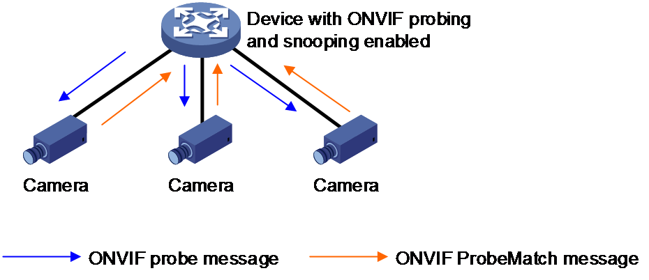

ONVIF probing mechanism
Non-SmartMC networking
As shown in Figure 1, after you enable ONVIF probing for an interface on the device with ONVIF snooping configured:
1.     The interface periodically sends ONVIF probe messages.
¡     If the interface is configured with an IPv4 address, it sends IPv4 probe messages.
¡     If the interface is configured with an IPv6 global unicast address or IPv6 link-local address, it sends IPv6 probe messages.
¡     If the interface is configured with both an IPv4 address and an IPv6 global unicast address or IPv6 link-local address, it sends both IPv4 and IPv6 probe messages.
2.     After receiving an ONVIF probe message, an ONVIF endpoint returns an IPv4 or IPv6 ProbeMatch message.
3.     After receiving the ProbeMatch response, the device considers the endpoint to be online and records the endpoint information.
Figure 1 Non-SmartMC networking

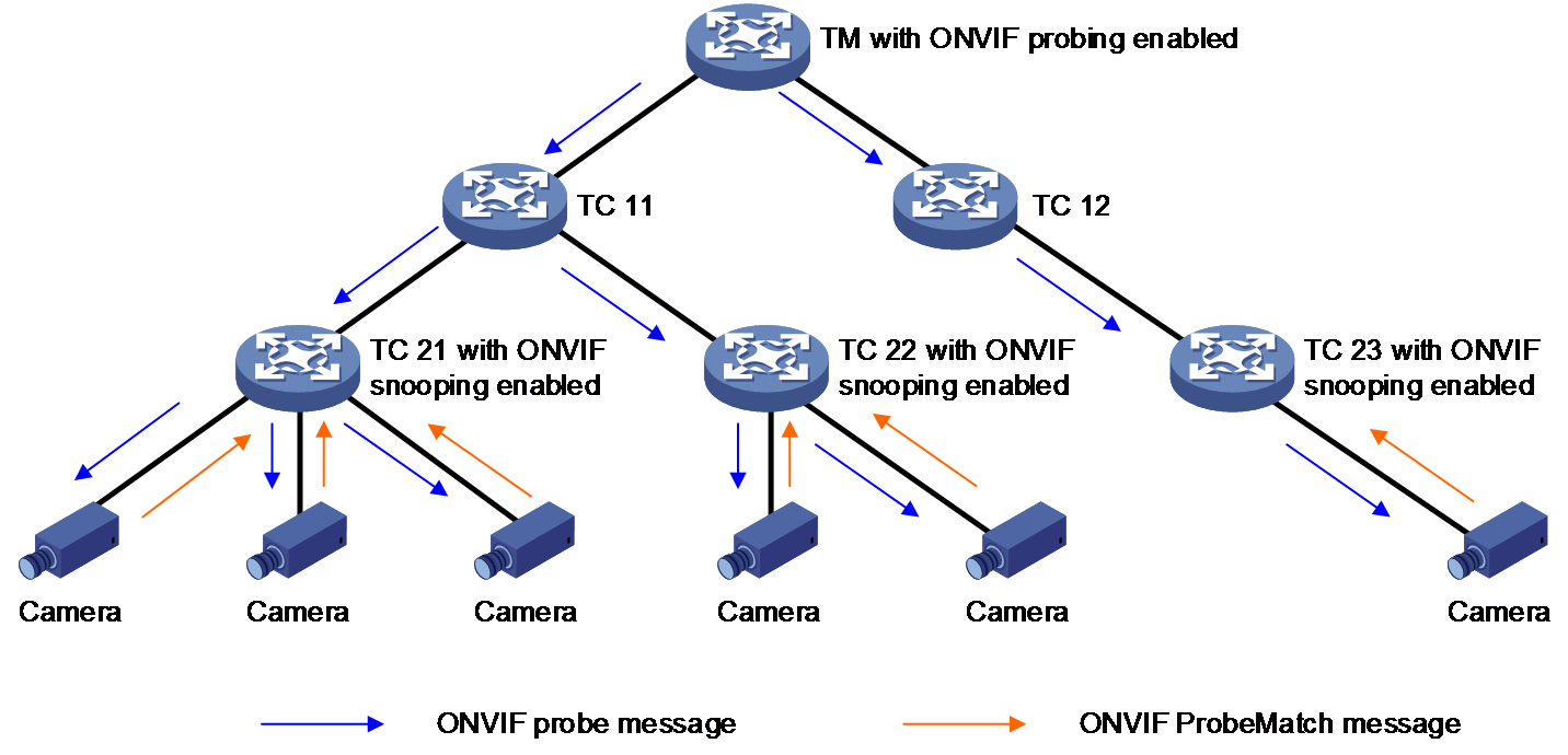

SmartMC networking
As shown in Figure 2, after you enable ONVIF probing on the TM and enable ONVIF snooping on the TM or TCs that access to ONVIF endpoints:
1.     The interface on the TM periodically sends ONVIF probe messages.
2.     After receiving an ONVIF probe message, a TC forwards the ONVIF probe message out of all its interfaces except the receiving interface.
3.     After receiving the probe message, an endpoint returns an IPv4 or IPv6 ProbeMatch message.
4.     After receiving the ProbeMatch response, the TM or TC considers the endpoint to be online and records the endpoint information.
Figure 2 SmartMC networking

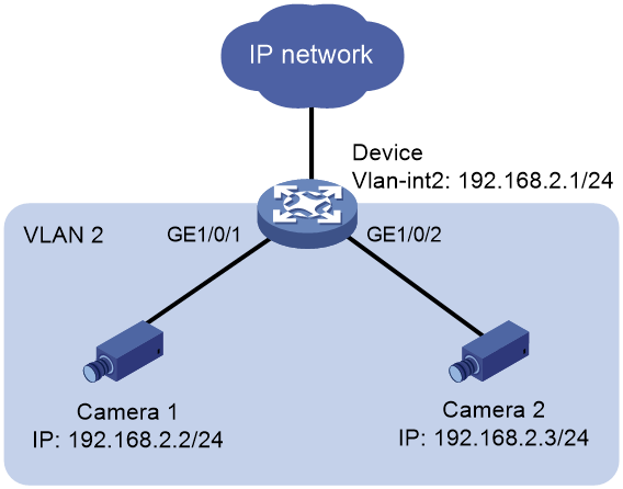

Example: Configuring ONVIF in a non-SmartMC network
As shown in Figure 3, the device acts as an access device for Camera 1 and Camera 2 to access the public network. Configure ONVIF on the device, which can automatically monitor when the endpoints come online and go offline.
Figure 3 Network diagram
# Enable ONVIF snooping.
<Device> system-view
[Device] onvif snooping enable
# Create VLAN 2.
[Device] vlan 2
[Device-vlan2] quit
# Configure an IP address for VLAN-interface 2, enable ONVIF probing, and set the interval for sending probe messages to 60 seconds.
[Device] interface vlan-interface 2
[Device-Vlan-interface1] ip address 192.168.2.1 24
[Device-Vlan-interface2] onvif probe enable
[Device-Vlan-interface2] onvif probe interval 60
[Device-Vlan-interface2] quit
# Assign Ten-GigabitEthernet 1/0/1 to VLAN 2 for user data transmission.
[Device] interface ten-gigabitethernet 1/0/1
[Device-Ten-GigabitEthernet1/0/1] port access vlan 2
[Device-Ten-GigabitEthernet1/0/1] quit
# Assign Ten-GigabitEthernet 1/0/2 to VLAN 2 for user data transmission.
[Device] interface ten-gigabitethernet 1/0/2
[Device-Ten-GigabitEthernet1/0/2] port access vlan 2
[Device-Ten-GigabitEthernet1/0/2] quit
# On the device, verify that ONVIF can successfully snoop the endpoints.
[Device] display onvif snooping-information
Snooping status: Enabled
Endpoint information:
Endpoint MAC address: 3cef-8c7a-4ede          Status: Online
 Port: XGE1/0/1                                    VLAN: 2
 IPv4 address: 192.168.2.2
 IPv6 address: --
Endpoint MAC address: 3cef-8c7a-4e8f          Status: Online
 Port: XGE1/0/2                                    VLAN: 2
 IPv4 address: 192.168.2.3
 IPv6 address: --
# On the device, verify that ONVIF can successfully probe the endpoints.
[Device] display onvif probe-information
Probing information:
  Port                     Status       Interval(sec)
  Vlan2                    Enabled      60

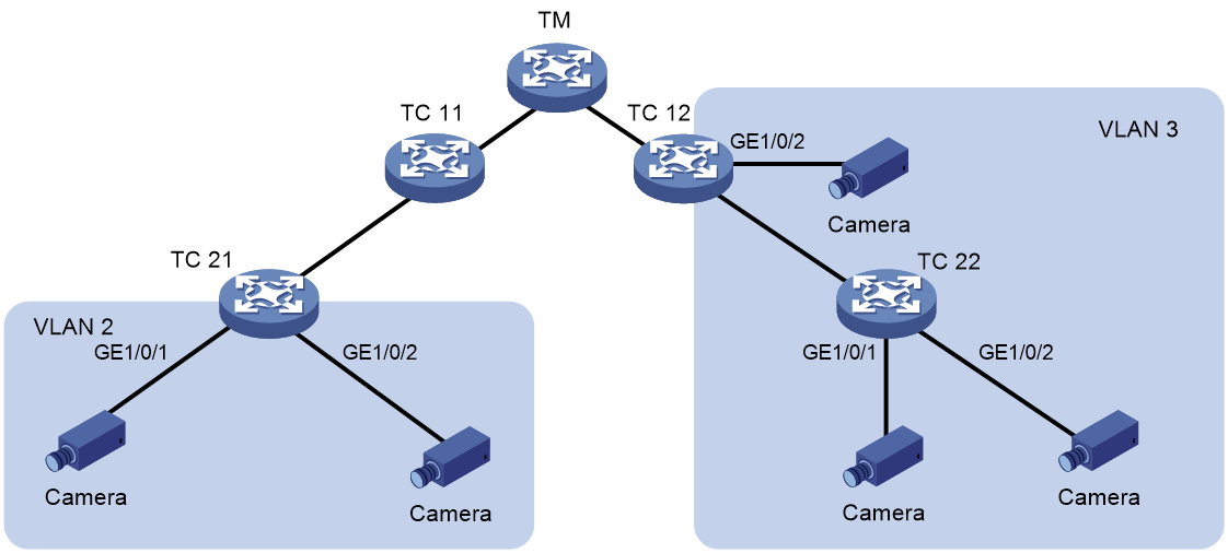

Example: Configuring ONVIF in a SmartMC network
As shown in Figure 4, configure the devices in a SmartMC network so ONVIF can monitor cameras connected to TC 12, TC 21, and TC 22 when they come online and go offline.
Figure 4 Network diagram
Establish the SmartMC network before you configure ONVIF. For more information about SmartMC network establishment, see "Configuring SmartMC."
Configuring TM
# Create VLAN 2.
<TM> system-view
[TM] vlan 2
[TM-vlan2] quit
# Enable ONVIF probing for VLAN-interface 2 and set the interval for sending probe messages to 60 seconds.
[TM] interface vlan-interface 2
[TM-Vlan-interface2] onvif probe enable
[TM-Vlan-interface2] onvif probe interval 60
[TM-Vlan-interface2] quit
# Create VLAN 3.
[TM] vlan 3
[TM-vlan3] quit
# Enable ONVIF probing for VLAN-interface 3 and set the interval for sending probe messages to 60 seconds.
[TM] interface vlan-interface 3
[TM-Vlan-interface3] onvif probe enable
[TM-Vlan-interface3] onvif probe interval 60
[TM-Vlan-interface3] quit
Configuring TC 12
<TC12> system-view
[TC12] onvif snooping enable
# Create VLAN 3.
[TC12] vlan 3
[TC12-vlan3] quit
# Assign Ten-GigabitEthernet 1/0/2 to VLAN 3 for user data transmission.
[TC12] interface ten-gigabitethernet 1/0/2
[TC12-Ten-GigabitEthernet1/0/2] port access vlan 3
[TC12-Ten-GigabitEthernet1/0/2] quit
Configuring TC 21
<TC21> system-view
[TC21] onvif snooping enable
# Create VLAN 2.
[TC21] vlan 2
[TC21-vlan2] quit
# Assign Ten-GigabitEthernet 1/0/1 and Ten-GigabitEthernet 1/0/2 to VLAN 2 for user data transmission.
[TC21] interface range ten-gigabitethernet 1/0/1 to ten-gigabitethernet 1/0/2
[TC21-if-range] port access vlan 2
[TC21-if-range] quit
Configuring TC 22
<TC22> system-view
[TC22] onvif snooping enable
# Create VLAN 3.
[TC22] vlan 3
[TC22-vlan2] quit
# Assign port Ten-GigabitEthernet 1/0/1 and Ten-GigabitEthernet 1/0/2 to VLAN 2 for user data transmission.
[TC22] interface range ten-gigabitethernet 1/0/1 to ten-gigabitethernet 1/0/2
[TC22-if-range] port access vlan 3
[TC22-if-range] quit
# On TC 21, verify that ONVIF can successfully snoop the endpoints.
[TC21] display onvif snooping-information
 IPv6 address: --
 IPv6 address: --
# On the TM, display ONVIF probing information.
<TM> display onvif probe-information
  Vlan2                    Enabled      60
  Vlan3                    Enabled      60
