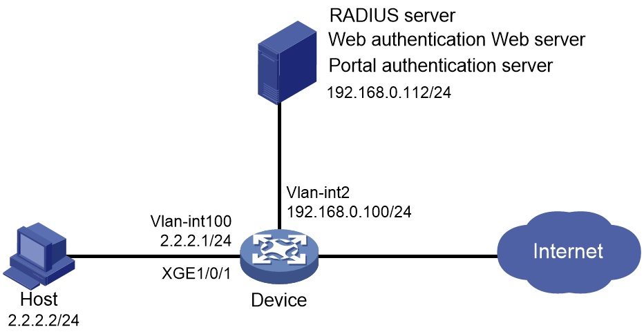

Web authentication system
A typical Web authentication system consists of four basic components: authentication client, access device, Web server for Web authentication, and AAA server.
Figure 1 Web authentication system using the local portal server
Authentication client
An authentication client is a Web browser that runs HTTP or HTTPS on the user endpoint.
Access device
An access device has the following functions:
·     Redirects all user HTTP or HTTPS requests that do not match authentication-free rules to the Web authentication page before authentication.
·     Interacts with the AAA server to complete authentication, authorization, and accounting. For more information about AAA, see "Configuring AAA."
·     Allows users that pass authentication to access authorized network resources.
A Web server pushes the Web authentication page to authentication clients and obtains user authentication information (username and password).
A Web server for Web authentication can be a local Web server or a remote Web server. A local Web server is usually integrated into the access device. A remote Web server is a portal Web server.
Portal authentication server
Web authentication uses a portal authentication server as the authentication server, which exchanges client authentication information with the access device.
AAA server
An AAA server interacts with the access device to implement user authentication, authorization, and accounting. A RADIUS server can perform authentication, authorization, and accounting for Web authentication users. An LDAP server can perform authentication for Web authentication users.

Web authentication configuration examples
Example: Configuring local Web authentication by using the AAA local authentication method
As shown in Figure 5, the host is directly connected to the device through Ten-GigabitEthernet 1/0/1.
Configure local Web authentication on Ten-GigabitEthernet 1/0/1, and configure the device to perform local authentication and authorization for the local Web authentication users.
Configure a local Web server on the device that uses the IP address of Loopback 0 and port 80 for Web authentication. Configure the device to use HTTP to transfer the authentication data.
Figure 5 Network diagram
Create VLANs, assign IP addresses to the VLAN interfaces, and assign interfaces to the VLANs.

Example: Configuring local Web authentication by using the AAA remote authentication method
As shown in Figure 6, the host is directly connected to the device through Ten-GigabitEthernet 1/0/1.
Configure local Web authentication on Ten-GigabitEthernet 1/0/1, and use a remote RADIUS server to perform authentication, authorization, and accounting for the local Web authentication users.
Figure 6 Network diagram
Configure the RADIUS server properly to provide authentication, authorization, and accounting functions for users. In this example, the username is configured as user1 on the RADIUS server.
Create VLANs, assign IP addresses to the VLAN interfaces, and assign interfaces to the VLANs. Make sure the host, the RADIUS server, and the device can reach each other.

Example: Configuring remote Web authentication by using the AAA local authentication method
As shown in Figure 7, the host is directly connected to the device through Ten-GigabitEthernet 1/0/1.
Configure remote Web authentication on Ten-GigabitEthernet 1/0/1, and configure the device to perform local authentication and authorization for the remote Web authentication users.
The remote Web server pushes Web authentication pages to users.
Figure 7 Network diagram
Configure the portal authentication server properly to provide normal portal functions for users.

Example: Configuring remote Web authentication by using the AAA remote authentication method
As shown in Figure 8, the host is directly connected to the device through Ten-GigabitEthernet 1/0/1.
Configure remote Web authentication on Ten-GigabitEthernet 1/0/1, and use a remote RADIUS server to perform authentication, authorization, and accounting for the remote Web authentication users.
Figure 8 Network diagram

# Enable Web authentication that uses remote Web server user.
[Device-GigabitEthernet1/0/1] web-auth enable apply server user
5.     Configure the device to obtain user information from ARP entries.
[Device] portal access-info trust arp
# Display Web authentication user information after user user1 passes Web authentication.
[Device] display web-auth user
  Total online web-auth users: 1
User Name: user1
  MAC address: acf1-df6c-f9ad
  Access interface: GigabitEthernet1/0/1
  Initial VLAN: 100
  Authorization VLAN: N/A
  Authorization ACL ID: N/A
  Authorization user profile: N/A
