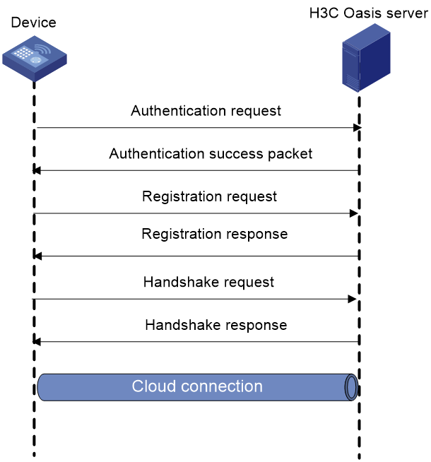

Cloud connection establishment
As shown in Figure 1, the cloud connection between the device and the H3C Oasis server is established as follows:
1.     The device sends an authentication request to the H3C Oasis server.
2.     The H3C Oasis server sends an authentication success packet to the device.
The device passes the authentication only if the serial number of the device has been added to the H3C Oasis server. If the authentication fails, the H3C Oasis server sends an authentication failure packet to the device.
3.     The device sends a registration request to the H3C Oasis server.
4.     The H3C Oasis server sends a registration response to the device.
The registration response contains the uniform resource locator (URL) used to establish a cloud connection.
5.     The device uses the URL to send a handshake request (changing the protocol from HTTP to WebSocket) to the H3C Oasis server.
6.     The H3C Oasis server sends a handshake response to the device to finish establishing the cloud connection.
7.     After the cloud connection is established, the device automatically obtains the subconnection URLs and establishes subconnections with the H3C Oasis server based on the service needs.
Figure 1 Establishing a cloud connection

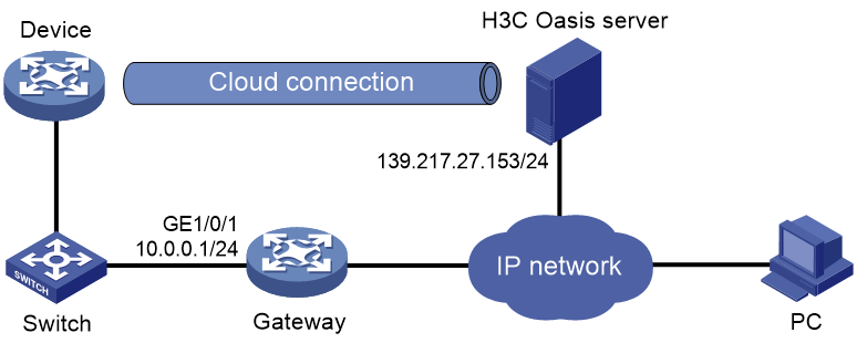

Example: Configuring a cloud connection
As shown in Figure 2, configure the device to establish a cloud connection with the H3C Oasis server.
Figure 2 Network diagram
1.     Configure IP addresses for interfaces as shown in Figure 2, and configure a routing protocol to make sure the devices can reach each other. (Details not shown.)
2.     Log in to the H3C Oasis server to add the serial number of the device to the server. (Details not shown.)
3.     Configure the domain name of the H3C Oasis server as oasiscloud.h3c.com.
<Device> system-view
[Device] cloud-management server domain oasiscloud.h3c.com
The DNS service is provided by the ISP DNS server.
# Verify that the device and the H3C Oasis server have established a cloud connection.
[Device] display cloud-management state
Cloud connection state                      : Established
Device state                                : Request_success
Cloud server address                        : 52.163.242.100
Cloud server domain name                    : oasiscloud.h3c.com
Cloud connection mode                       : Https
Cloud server port                           : 19443
Connected at                                : Wed Jan 27 14:18:40 2018
