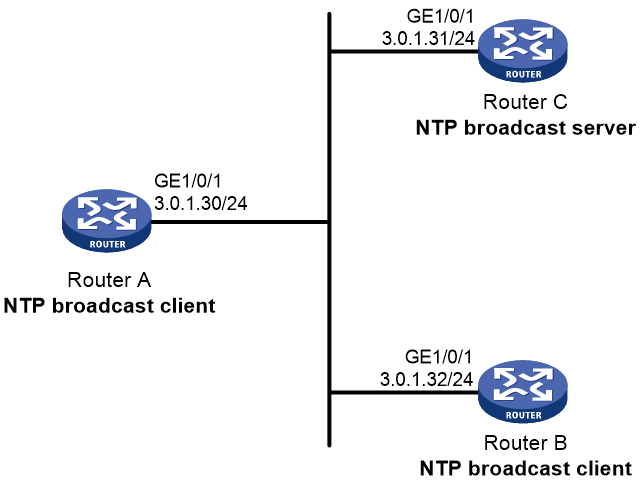

Figure 1 shows how NTP synchronizes the system time between two devices (Device A and Device B, in this example). Assume that:
·     Prior to the time synchronization, the time is set to 10:00:00 am for Device A and 11:00:00 am for Device B.
·     Device B is used as the NTP server. Device A is to be synchronized to Device B.
·     It takes 1 second for an NTP message to travel from Device A to Device B, and from Device B to Device A.
·     It takes 1 second for Device B to process the NTP message.
Figure 1 Basic work flow
The synchronization process is as follows:
1.     Device A sends Device B an NTP message, which is timestamped when it leaves Device A. The time stamp is 10:00:00 am (T1).
2.     When this NTP message arrives at Device B, Device B adds a timestamp showing the time when the message arrived at Device B. The timestamp is 11:00:01 am (T2).
3.     When the NTP message leaves Device B, Device B adds a timestamp showing the time when the message left Device B. The timestamp is 11:00:02 am (T3).
4.     When Device A receives the NTP message, the local time of Device A is 10:00:03 am (T4).
Up to now, Device A can calculate the following parameters based on the timestamps:
·     The roundtrip delay of the NTP message: Delay = (T4 – T1) – (T3 – T2) = 2 seconds.
·     Time difference between Device A and Device B: Offset = [ (T2 – T1) + (T3 – T4) ] /2 = 1 hour.
Based on these parameters, Device A can be synchronized to Device B.

NTP architecture
NTP uses stratums 1 to 16 to define clock accuracy, as shown in Figure 2. A lower stratum value represents higher accuracy. Clocks at stratums 1 through 15 are in synchronized state, and clocks at stratum 16 are not synchronized.
Figure 2 NTP architecture
A stratum 1 NTP server gets its time from an authoritative time source, such as an atomic clock. It provides time for other devices as the primary NTP server. A stratum 2 time server receives its time from a stratum 1 time server, and so on.
To ensure time accuracy and availability, you can specify multiple NTP servers for a device. The device selects an optimal NTP server as the clock source based on parameters such as stratum. The clock that the device selects is called the reference source. For more information about clock selection, see the related protocols and standards.
If the devices in a network cannot synchronize to an authoritative time source, you can perform the following tasks:
·     Select a device that has a relatively accurate clock from the network.
·     Use the local clock of the device as the reference clock to synchronize other devices in the network.

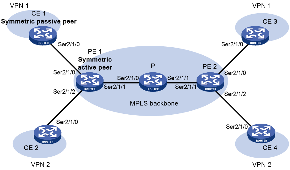

NTP for MPLS L3VPN instances
On an MPLS L3VPN network, a PE that acts as an NTP client or active peer can synchronize with the NTP server or passive peer in an MPLS L3VPN instance.
As shown in Figure 4, users in VPN 1 and VPN 2 are connected to the MPLS backbone network through provider edge (PE) devices. VPN instances vpn1 and vpn2 have been created for VPN 1 and VPN 2, respectively on the PEs. Services of the two VPN instances are isolated. Time synchronization between PEs and devices in the two VPN instances can be realized if you perform the following tasks:
·     Configure the PEs to operate in NTP client or symmetric active mode.
·     Specify the VPN instance to which the NTP server or NTP symmetric passive peer belongs.
Figure 4 Network diagram
For more information about MPLS L3VPN, VPN instance, and PE, see MPLS Configuration Guide.

Example: Configuring NTP client/server association mode
As shown in Figure 5, perform the following tasks:
·     Configure Device A's local clock as its reference source, with stratum level 2.
·     Configure Device B to operate in client mode and specify Device A as the NTP server of Device B.
Figure 5 Network diagram
1.     Assign an IP address to each interface, and make sure Device A and Device B can reach each other, as shown in Figure 5. (Details not shown.)

Example: Configuring NTP symmetric active/passive association mode
As shown in Figure 7, perform the following tasks:
·     Configure Device A to operate in symmetric active mode and specify Device B as the passive peer of Device A.
Figure 7 Network diagram
1.     Assign an IP address to each interface, and make sure Device A and Device B can reach each other, as shown in Figure 7. (Details not shown.)

As shown in Figure 9, configure Router C as the NTP server for multiple devices on a network segment to synchronize the time of the devices.
·     Configure Router C's local clock as its reference source, with stratum level 2.
·     Configure Router C to operate in broadcast server mode and send broadcast messages from GigabitEthernet 1/0/1.
·     Configure Router B and Router A to operate in broadcast client mode and receive broadcast messages on GigabitEthernet 1/0/1.
Figure 9 Network diagram
1.     Assign an IP address to each interface, and make sure the routers are reachable to each other, as shown in Figure 9. (Details not shown.)

Example: Configuring NTP multicast association mode
As shown in Figure 10, configure router C as the NTP server for multiple devices on different network segments to synchronizes the time of the devices.
·     Configure Router C to operate in multicast server mode and send multicast messages from GigabitEthernet 1/0/1.
·     Configure Router D and Router A to operate in multicast client mode and receive multicast messages on GigabitEthernet 1/0/1.
Figure 10 Network diagram
1.     Assign an IP address to each interface, and make sure the routers can reach each other, as shown in Figure 10. (Details not shown.)
2.     Configure Router C:
# Enable the NTP service.
<RouterC> system-view
[RouterC] ntp-service enable
# Specify NTP for obtaining the system time.
[RouterC] clock protocol ntp
# Specify the local clock as the reference source, with stratum level 2.
[RouterC] ntp-service refclock-master 2
# Configure Router C to operate in multicast server mode and send multicast messages through GigabitEthernet 1/0/1.
[RouterC] interface gigabitethernet 1/0/1
[RouterC-GigabitEthernet1/0/1] ntp-service multicast-server
3.     Configure Router D:
<RouterD> system-view
[RouterD] ntp-service enable
[RouterD] clock protocol ntp
# Configure Router D to operate in multicast client mode and receive multicast messages on GigabitEthernet 1/0/1.
[RouterD] interface gigabitethernet 1/0/1
[RouterD-GigabitEthernet1/0/1] ntp-service multicast-client
4.     Verify the configuration:
# Verify that Router D has synchronized its time with Router C, and the clock stratum level of Router D is 3.
Router D and Router C are on the same subne. Router D can receive multicast messages from Router C without being enabled with the multicast function.
 [RouterD-GigabitEthernet1/0/1] display ntp-service status
 Clock status: synchronized
 Clock stratum: 3
 System peer: 3.0.1.31
 Local mode: bclient
 Reference clock ID: 3.0.1.31
 Leap indicator: 00
 Clock jitter: 0.044281 s
 Stability: 0.000 pps
 Clock precision: 2^-10
 Root delay: 0.00229 ms
 Root dispersion: 4.12572 ms
 Reference time: d0d289fe.ec43c720  Sat, Jan  8 2011  7:00:14.922
# Verify that an IPv4 NTP association has been established between Router D and Router C.
[RouterD-GigabitEthernet1/0/1] display ntp-service sessions
       source          reference       stra reach poll  now offset  delay disper
 [1245]3.0.1.31        127.127.1.0        2     1   64  519   -0.0 0.0022 4.1257
Notes: 1 source(master),2 source(peer),3 selected,4 candidate,5 configured.
 Total sessions: 1

Figure 13 Network diagram
1.     Assign an IP address to each interface, and make sure Router A, Router B, and Router C can reach each other, as shown in Figure 13. (Details not shown.)

5.     Verify the configuration:
NTP authentication is enabled on Router A and Router B, but not enabled on Router C, so Router A and Router B cannot synchronize their local clocks with Router C.
[RouterB-GigabitEthernet1/0/1] display ntp-service status
 Clock status: unsynchronized
 Clock stratum: 16
 Reference clock ID: none
6.     Configure NTP authentication on Router C:
# Enable NTP authentication on Router C. Create a plaintext NTP authentication key, with the key ID of 88 and key value of 123456. Specify the key as a trusted key.
[RouterC] ntp-service authentication enable
[RouterC] ntp-service authentication-keyid 88 authentication-mode md5 simple 123456
[RouterC] ntp-service reliable authentication-keyid 88
# Specify Router C as an NTP broadcast server, and associate key 88 with Router C.
[RouterC-GigabitEthernet1/0/1] ntp-service broadcast-server authentication-keyid 88
The following procedure uses Router B as an example to verify the configuration.
# Verify that Router B has synchronized its time with Router C, and the clock stratum level of Router B is 4.
 Clock stratum: 4
 Local mode: bclient

Example: Configuring MPLS L3VPN network time synchronization in symmetric active/passive mode
As shown in Figure 15, two VPN instances are present on PE 1 and PE 2: vpn1 and vpn2. CE 1 and CE 3 belong to VPN 1.
To synchronize time between PE 1 and CE 1 in VPN 1, perform the following tasks:
·     Configure CE 1's local clock as its reference source, with stratum level 2.
·     Configure CE 1 in the VPN instance vpn1 as the symmetric passive peer of PE 1.
Figure 15 Network diagram

Before you perform the following configuration, be sure you have completed MPLS L3VPN-related configurations. For information about configuring MPLS L3VPN, see MPLS Configuration Guide.
1.     Assign an IP address to each interface, as shown in Figure 15. Make sure CE 1 and PE 1, PE 1 and PE 2, PE 2 and CE 3 can reach each other. (Details not shown.)
2.     Configure CE 1:
<CE1> system-view
[CE1] ntp-service enable
[CE1] clock protocol ntp
[CE1] ntp-service refclock-master 2
3.     Configure PE 1:
<PE1> system-view
[PE1] ntp-service enable
[PE1] clock protocol ntp
# Specify CE 1 in the vpn instance vpn1 as the symmetric passive peer of PE 1.
[PE1] ntp-service unicast-peer 10.1.1.1 vpn-instance vpn1
# Verify that PE 1 has synchronized to CE 1, with stratum level 3.
[PE1] display ntp-service status
 Clock stratum: 3
 System peer: 10.1.1.1
 Local mode: sym_active
 Reference clock ID: 10.1.1.1
 Leap indicator: 00
 Clock jitter: 0.005096 s
 Root delay: 0.00655 ms
 Root dispersion: 1.15869 ms
 Reference time: d0c62687.ab1bba7d  Wed, Dec 29 2010 21:28:39.668
# Verify that an IPv4 NTP association has been established between PE 1 and CE 1.
[PE1] display ntp-service sessions
 [1245]10.1.1.1        127.127.1.0        2     1   64  519   -0.0 0.0000    0.0
 Total sessions: 1
# Verify that server 127.0.0.1 has synchronized to server 10.1.1.1, and server 10.1.1.1 has synchronized to the local clock.
[PE1] display ntp-service trace
Server     127.0.0.1
Stratum    3 , jitter  0.000, synch distance 796.50.
Server     10.1.1.1
Stratum    2 , jitter 939.00, synch distance 0.0000.
RefID      127.127.1.0

·     Configure Device B to operate in SNTP client mode, and specify Device A as the NTP server.
·     Configure NTP authentication on Device A and SNTP authentication on Device B.
Figure 16 Network diagram
1.     Assign an IP address to each interface, and make sure Device A and Device B can reach each other, as shown in Figure 16. (Details not shown.)
