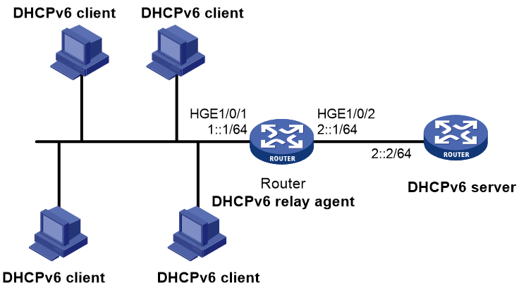

Example: Configuring static IPv4SG
As shown in Figure 2, all hosts use static IP addresses.
Configure static IPv4SG bindings on Device A and Device B to meet the following requirements:
·     All interfaces of Device A allow IP packets from Host A to pass.
·     HundredGigE 1/0/1 of Device A allows IP packets from Host B to pass.
Figure 2 Network diagram
By default, interfaces on the device are disabled (in ADM or Administratively Down state). To have an interface operate, you must use the undo shutdown command to enable that interface.
Interfaces in this example refer to Layer 2 interfaces. By default, interfaces on the device operate at Layer 3 mode. To change the link mode of an interface, use the port link-mode command in interface view.

Example: Configuring DHCPv6 relay agent-based dynamic IPv6SG
As shown in Figure 8, DHCPv6 relay agent is enabled on the router. The clients obtain IPv6 addresses from the DHCPv6 server through the DHCPv6 relay agent.
Enable dynamic IPv6SG on HundredGigE 1/0/1 to filter incoming packets by using the IPv6SG bindings generated based on DHCPv6 relay entries.
Figure 8 Network diagram
1.     Configure the DHCPv6 relay agent:
# Specify IP addresses for the interfaces. (Details not shown.)
# Enable the DHCPv6 relay agent on HundredGigE 1/0/1.
[Router] interface hundredgige 1/0/1
[Router-HundredGigE1/0/1] ipv6 dhcp select relay
# Enable recording of DHCPv6 relay entries on the interface.
[Router-HundredGigE1/0/1] ipv6 dhcp relay client-information record
# Specify the DHCPv6 server address 2::2 on the relay agent.
[Router-HundredGigE1/0/1] ipv6 dhcp relay server-address 2::2
[Router-HundredGigE1/0/1] quit
2.     Enable IPv6SG on HundredGigE 1/0/1 and verify the source IP address and MAC address for dynamic IPv6SG.
[Router-HundredGigE1/0/1] ipv6 verify source ip-address mac-address
# Display dynamic IPv6SG bindings generated based on DHCPv6 relay entries.
[Router] display ipv6 source binding dhcpv6-relay
Total entries found: 1
IP Address      MAC Address    Interface                VLAN Type
1::2            0001-0203-0406 HGE1/0/1                 N/A  DHCPv6 relay
HundredGigE 1/0/1 will filter packets based on the IPv6SG binding.
