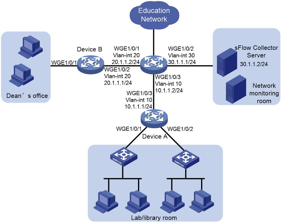

Example: Configuring sFlow
As shown in Figure 1, perform the following tasks:
· Configure flow sampling to sample packets on Device A and Device B.
· Configure counter sampling to periodically collect the counter information on Device A and Device B.
Analysis
To obtain interface counter information and packet information, you must configure both flow sampling and counter sampling.

Procedures
Configuring Device A
# Create VLAN 10. Assign Twenty-FiveGigE 1/0/1 through Twenty-FiveGigE 1/0/3 to VLAN 10.
[DeviceA] vlan 10
[DeviceA-vlan10] port twenty-fivegige 1/0/1 to twenty-fivegige 1/0/3
[DeviceA-vlan10] quit
# Assign an IP address to VLAN-interface 10.
[DeviceA] interface vlan-interface 10
[DeviceA-Vlan-interface10] ip address 10.1.1.1 255.255.255.0
[DeviceA-Vlan-interface10] quit
# Assign IP addresses to other interfaces. (Details not shown.)
# Assign an IP address to the sFlow agent.
[DeviceA] sflow agent ip 10.1.1.1
# Specify the sFlow collector ID as 1, IP address as 30.1.1.2, and port number as 5000.
[DeviceA] sflow collector 1 ip 30.1.1.2 port 5000
# Enable counter sampling and set the counter sampling interval to 120 seconds on Twenty-FiveGigE 1/0/1.
[DeviceA] interface twenty-fivegige 1/0/1
[DeviceA-Twenty-FiveGigE1/0/1] sflow counter interval 120
# Specify sFlow collector 1 for counter sampling on Twenty-FiveGigE 1/0/1.
[DeviceA-Twenty-FiveGigE1/0/1] sflow counter collector 1
[DeviceA-Twenty-FiveGigE1/0/1] quit
# Enable counter sampling and set the counter sampling interval to 120 seconds on Twenty-FiveGigE 1/0/2.
[DeviceA] interface twenty-fivegige 1/0/2
[DeviceA-Twenty-FiveGigE1/0/2] sflow counter interval 120
# Specify sFlow collector 1 for counter sampling on Twenty-FiveGigE 1/0/2.
[DeviceA-Twenty-FiveGigE1/0/2] sflow counter collector 1
[DeviceA-Twenty-FiveGigE1/0/2] quit
# Enable flow sampling and set the sampling interval to 10000 on Twenty-FiveGigE 1/0/1.
[DeviceA-Twenty-FiveGigE1/0/1] sflow sampling-rate 10000
# Specify sFlow collector 1 for flow sampling on Twenty-FiveGigE 1/0/1.
[DeviceA-Twenty-FiveGigE1/0/1] sflow flow collector 1
# Enable flow sampling and set the sampling interval to 10000 on Twenty-FiveGigE 1/0/2.
[DeviceA-Twenty-FiveGigE1/0/2] sflow sampling-rate 10000
# Specify sFlow collector 1 for flow sampling on Twenty-FiveGigE 1/0/2.
[DeviceA-Twenty-FiveGigE1/0/2] sflow flow collector 1
