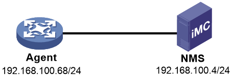

As shown in Figure 1, an IMC server acts as the NMS and the device acts as the agent. The NMS uses SNMPv1/SNMPv2c to manage the SNMP agent, and the agent automatically sends notifications to report events to the NMS.

As shown in Figure 5, an IMC server acts as the NMS and the device acts as the agent. The NMS uses SNMPv3 to manage the SNMP agent, and the agent automatically sends notifications to report events to the NMS.
