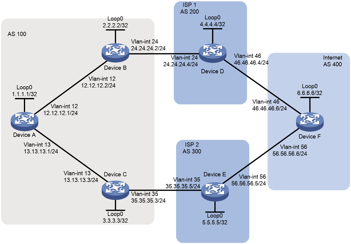

Example: Configuring route selection based on the AS_PATH attribute
As shown in Figure 1, all devices run BGP. Configure a routing policy on Device B and Device C so that traffic from AS 100 to AS 400 is preferentially forwarded by Device D.
Figure 1 Network diagram
Analysis
For devices in AS 100 to select the optimal route based on AS numbers, increase the local preference for routes whose AS_PATH attributes end with the specified AS number. Configure a routing policy on Device C to set the local preference to 300 for routes whose AS_PATH attributes end with AS number 400.
To filter routes based on AS numbers, use an AS path list.

Procedures
Configuring IP addresses for interfaces
# Configure an IP address for the interface VLAN-interface 12 on Device A.
<DeviceA> system-view
[DeviceA] interface Vlan-interface 12
[DeviceA-Vlan-interface12] ip address 12.12.12.1 24
[DeviceA-Vlan-interface12] quit
# Configure IP addresses for other interfaces as shown in Figure 1. (Details not shown.)
Configuring BGP connections

# Display the BGP routing table on Device A. The output shows the routes advertised by Device D, Device E, and Device F, and the AS_PATH attributes of the routes.
[DeviceA] display bgp routing-table ipv4
Total number of routes: 12
 BGP local router ID is 1.1.1.1
 Status codes: * - valid, > - best, d - dampened, h - history
               s - suppressed, S - stale, i - internal, e – external
               a - additional-path
       Origin: i - IGP, e - EGP, ? - incomplete
     Network            NextHop         MED        LocPrf     PrefVal Path/Ogn
* >i 2.2.2.2/32         12.12.12.2      0          100        0       ?
* >i 3.3.3.3/32         13.13.13.3      0          100        0       ?
* >i 4.4.4.4/32         24.24.24.4      0          100        0       200i
*  i                    35.35.35.5                 100        0       300 400
                                                                      200i
* >i 5.5.5.5/32         35.35.35.5      0          100        0       300i
*  i                    24.24.24.4                 100        0       200 400
                                                                      300i
* >i 6.6.6.6/32         24.24.24.4                 100        0       200 400i
*  i                    35.35.35.5                 100        0       300 400i
* >i 12.12.12.0/24      12.12.12.2      0          100        0       ?
* >i 13.13.13.0/24      13.13.13.3      0          100        0       ?
* >i 24.24.24.0/24      12.12.12.2      0          100        0       ?
* >i 35.35.35.0/24      13.13.13.3      0          100        0       ?
Configuring routing policies
# Create routing policy aspath on Device C, and set the local preference to 300 for routes whose AS_PATH attributes end with AS number 400.
[DeviceC] ip as-path 1 permit 400$
[DeviceC] route-policy aspath permit node 20
[DeviceC-route-policy-aspath-20] if-match as-path 1
[DeviceC-route-policy-aspath-20] apply local-preference 300
[DeviceC-route-policy-aspath-20] quit
[DeviceC] route-policy aspath permit node 25
# Apply routing policy aspath to routes from the peer 35.35.35.5.
[DeviceC] bgp 100
[DeviceC-bgp-default] address-family ipv4
[DeviceC-bgp-default-ipv4] peer 35.35.35.5 route-policy aspath import
# Display the BGP routing table on Device A. The output shows that the next hop has changed for the route to AS 400.
Total number of routes: 11
               a - additional-path
       Origin: i - IGP, e - EGP, ? – incomplete
                                                                      200i
                                                                      300i
* >i 6.6.6.6/32         35.35.35.5                 300        0       300 400i
*  i                    24.24.24.4                 100        0       200 400i
# Verify that packets from Device A to 6.6.6.6 are forwarded by Device D.
[DeviceA] tracert 6.6.6.6
traceroute to 6.6.6.6 (6.6.6.6), 30 hops at most, 52 bytes each packet, press CT
RL_C to break
 1  12.12.12.2 (12.12.12.2)  2.417 ms  1.887 ms  1.773 ms
 2  35.35.35.5 (35.35.35.5)  4.057 ms  2.293 ms  2.739 ms
 3  6.6.6.6 (6.6.6.6)  5.145 ms  4.205 ms  4.402 ms

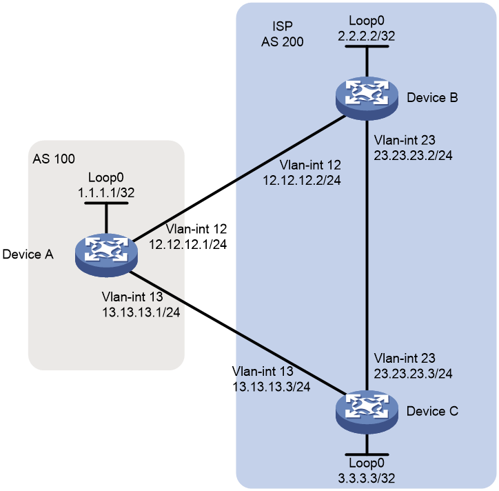

Example: Configuring route selection based on the MED attribute
As shown in Figure 2, all devices run BGP. EBGP runs between Device A and Device B, and between Device A and Device C. IBGP runs between Device B and Device C.
Configure a routing policy to ensure that traffic from AS 100 to AS 200 is preferentially forwarded by Device C. Before you configure the routing policy, the traffic is preferentially forwarded by Device B.
Figure 2 Network diagram
Analysis
To ensure that the traffic is preferentially forwarded by Device C, configure a routing policy on Device B to change the MED value for the route to Device A. Make sure the MED value is not the default MED value 0.

# Create routing policy 10 on Device B and set the cost to 100.
[DeviceB] route-policy 10 permit node 10
[DeviceB-route-policy-10-10] apply cost 100
[DeviceB-route-policy-10-10] quit
# Apply routing policy 10 to routes to the peer 12.12.12.1.
[DeviceB] bgp 200
[DeviceB-bgp-default] address-family ipv4 unicast
[DeviceB-bgp-default-ipv4] peer 12.12.12.1 route-policy 10 export
[DeviceB-bgp-default-ipv4] quit
[DeviceB-bgp-default] quit
# Display the BGP routing table on Device A. The output shows that the MED value for the route with the next hop 12.12.12.2 changes to 100, and the route with the next hop 13.13.13.3 becomes the optimal route.
 Total number of routes: 2
               a - additional-path
* >e 23.23.23.0/24      13.13.13.3      0                     0       200i
*  e                    12.12.12.2      100                   0       200i
