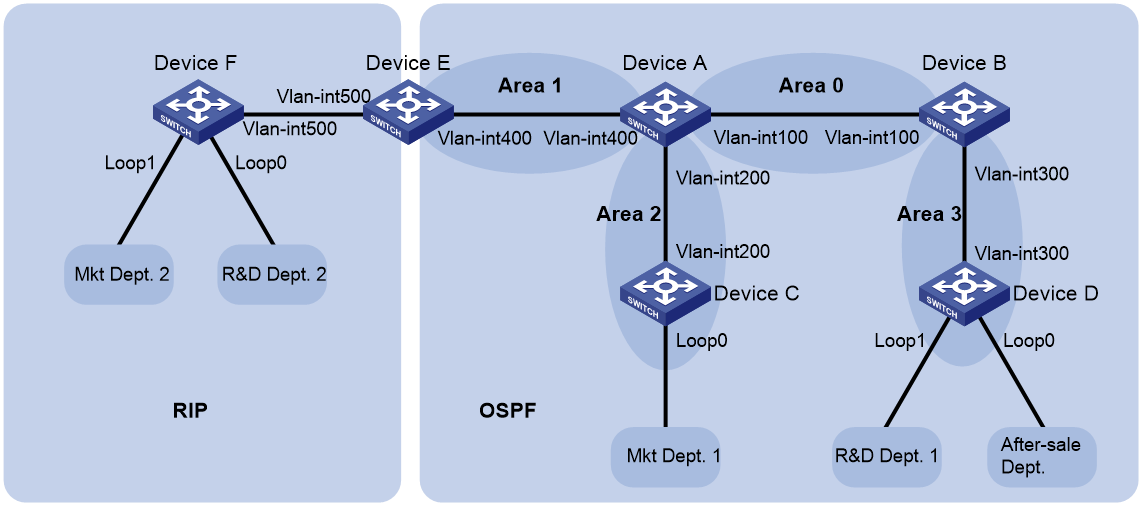

As shown in Figure 1, the devices of an enterprise reside in OSPF and RIP domains.
Configure route redistribution between OSPF and RIP to interconnect the devices.
Configure route filtering on Device E, Device C, and Device D to meet the following requirements:
·     The route destined for R&D department 2 is not redistributed to OSPF.
·     Marketing department 1 cannot reach R&D department 1.
·     R&D department 1 and the After-sale service department cannot reach Marketing department 2.
Figure 1 Network diagram

When you configure OSPF route filtering, follow these restrictions and guidelines:
·     The filter-policy export command that filters redistributed routes takes effect only on an ASBR.
·     OSPF filters routes calculated using received LSAs. It does not filter LSAs.
·     IP communication is bidirectional. If a router filters out a route destined for Network A, the subnets attached to the router cannot reach Network A, and Network A cannot reach the subnets.
·     When you configure route filtering by referencing an ACL, configure the rule permit source any item following multiple rule deny source items to allow unmatched routes to pass.

# Verify that Device D does not have a route to 192.168.5.0/24.
[DeviceD] display ip routing-table
Destinations : 25        Routes : 25
Destination/Mask   Proto   Pre Cost        NextHop         Interface
0.0.0.0/32         Direct  0   0           127.0.0.1       InLoop0
10.1.1.0/24        O_INTER 10  2           10.3.1.1        Vlan300
10.2.1.0/24        O_INTER 10  3           10.3.1.1        Vlan300
10.3.1.0/24        Direct  0   0           10.3.1.2        Vlan300
10.3.1.0/32        Direct  0   0           10.3.1.2        Vlan300
10.3.1.2/32        Direct  0   0           127.0.0.1       InLoop0
10.3.1.255/32      Direct  0   0           10.3.1.2        Vlan300
10.4.1.0/24        O_INTER 10  3           10.3.1.1        Vlan300
10.5.1.0/24        O_ASE2  150 1           10.3.1.1        Vlan300
127.0.0.0/8        Direct  0   0           127.0.0.1       InLoop0
127.0.0.0/32       Direct  0   0           127.0.0.1       InLoop0
127.0.0.1/32       Direct  0   0           127.0.0.1       InLoop0
127.255.255.255/32 Direct  0   0           127.0.0.1       InLoop0
192.168.1.0/24     Direct  0   0           192.168.1.1     Loop0
192.168.1.0/32     Direct  0   0           192.168.1.1     Loop0
192.168.1.1/32     Direct  0   0           127.0.0.1       InLoop0
192.168.1.255/32   Direct  0   0           192.168.1.1     Loop0
192.168.2.0/24     Direct  0   0           192.168.2.1     Loop1
192.168.2.0/32     Direct  0   0           192.168.2.1     Loop1
192.168.2.1/32     Direct  0   0           127.0.0.1       InLoop0
192.168.2.255/32   Direct  0   0           192.168.2.1     Loop1
192.168.3.1/32     O_INTER 10  3           10.3.1.1        Vlan300
224.0.0.0/4        Direct  0   0           0.0.0.0         NULL0
224.0.0.0/24       Direct  0   0           0.0.0.0         NULL0
255.255.255.255/32 Direct  0   0           127.0.0.1       InLoop0
# Verify that the After-sale service department cannot reach Marketing department 2.
[DeviceD] ping -a 192.168.1.1 192.168.5.1
Ping 192.168.5.1 (192.168.5.1) from 192.168.1.1: 56 data bytes, press CTRL_C to
break
Request time out
Request time out
Request time out
Request time out
Request time out
--- Ping statistics for 192.168.5.1 ---
5 packet(s) transmitted, 0 packet(s) received, 100.0% packet loss
# Verify that R&D department 1 cannot reach Marketing department 2.
[DeviceD] ping -a 192.168.2.1 192.168.5.1
Ping 192.168.5.1 (192.168.5.1) from 192.168.2.1: 56 data bytes, press CTRL_C to
break
Request time out
Request time out
Request time out
Request time out
Request time out
The output on Device C and Device D shows that Device E has filtered out the route destined for R&D development 2.
