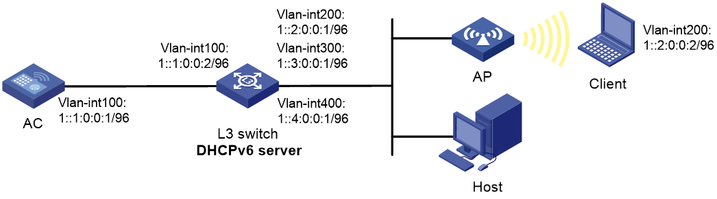

Example: Configuring an AP to associate with the AC at Layer 3 (IPv6)
As shown in Figure 1, the AC acts as a DHCPv6 server to assign IPv6 addresses to the AP, client, and host. Assume centralized forwarding is used in this example.
Configure wireless services to enable the client to access the wireless services and communicate with the host.
Figure 1 Network diagram

# Verify that the AP is in R/M state.
<AC> display wlan ap all
Total number of APs: 1
Total number of connected APs: 1
Total number of connected manual APs: 1
Total number of connected auto APs: 0
Total number of connected common APs: 1
Total number of connected WTUs: 0
Total number of inside APs: 0
Maximum supported APs: 3072
Remaining APs: 3071
Total AP licenses: 512
Local AP licenses: 512
Server AP licenses: 0
Remaining Local AP licenses: 511
Sync AP licenses: 0
                                 AP information
 State : I = Idle,      J  = Join,        JA = JoinAck,    IL = ImageLoad
          C = Config,    DC = DataCheck,  R  = Run,   M = Master,  B = Backup
AP name                APID    State   Model             Serial ID
ap1                     1        R/M     WA6320            219801A28N819CE0002T
# Verify that the client is connected to radio 1 on AP officeap.
<AC> display wlan client ipv6
Total number of clients: 1
MAC address     AP name               RID  IPv6 address              VLAN
784f-43b6-077c ap1                    1     1::2:0:0:2                200
# Verify that the client and the host can ping each other successfully.
C:\Users\system32>ping 1::2:0:0:2 -t
Pinging 1::2:0:0:2 with 32 bytes of data:
Reply from 1::2:0:0:2: bytes=32 time=2470ms TTL=63
Reply from 1::2:0:0:2: bytes=32 time=2ms TTL=63
Reply from 1::2:0:0:2: bytes=32 time=1427ms TTL=63
Reply from 1::2:0:0:2: bytes=32 time=86ms TTL=63
Reply from 1::2:0:0:2: bytes=32 time=142ms TTL=63
Reply from 1::2:0:0:2: bytes=32 time=561ms TTL=63
Reply from 1::2:0:0:2: bytes=32 time=84ms TTL=63
Reply from 1::2:0:0:2: bytes=32 time=465ms TTL=63
Reply from 1::2:0:0:2: bytes=32 time=114ms TTL=63
Reply from 1::2:0:0:2: bytes=32 time=124ms TTL=63
Reply from 1::2:0:0:2: bytes=32 time=446ms TTL=63
Ping statistics for 1::2:0:0:2:
    Packets: Sent = 12, Received = 12, Lost = 0 (0% loss),
    Minimum = 2ms, Maximum = 2470ms, Average = 495ms
Control-C
^C
C:\Users\system32>

 port trunk permit vlan 100 200
ipv6 route-static 1::4:0:0:0 96 1::1:0:0:2
wlan ap ap1 model WA6320
 serial-id 219801A28N819CE0002T
 wlan ap-group group1
 ap ap1
 ap-model WA6320
radio 1
  radio enable
  service-template 1 vlan 200
 radio 2
·     Layer 3 switch:
vlan 100
vlan 200
vlan 300
vlan 400
ipv6 dhcp pool 1
 network 1::2:0:0:0/96
ipv6 dhcp pool 2
network 1::3:0:0:0/96
ipv6 dhcp pool 3
 network 1::4:0:0:0/96
 option 52 hex 00010000000000000001000000000001
interface Vlan-interface100
 ipv6 address 1::1:0:0:2/96
interface Vlan-interface200
 ipv6 dhcp select server
 ipv6 dhcp server apply pool 1
 ipv6 address 1::2:0:0:1/96
 ipv6 nd autoconfig managed-address-flag
 ipv6 nd autoconfig other-flag
 undo ipv6 nd ra halt
interface Vlan-interface300
 ipv6 dhcp server apply pool 2
 ipv6 address 1::3:0:0:1/96
interface Vlan-interface400
 ipv6 dhcp server apply pool 3
 ipv6 address 1::4:0:0:1/96
 port link-type trunk
 undo port trunk permit vlan 1
 port trunk permit vlan 200 400
 port trunk pvid vlan 400
 port access vlan 300
