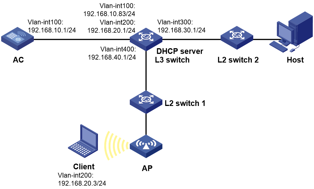

Example: Configuring an AP to associate with the AC at Layer 3
As shown in Figure 1, the AC is attached to the Layer 3 switch and the Layer 3 switch acts as a DHCP server to assign IP addresses to the AP, client, and host. Assume centralized forwarding is used in this example.
Configure the following settings for the client to communicate with the host:
·     Configure the client to access the WLAN through VLAN 200, and the host to access the network through VLAN 300.
·     Assign the AC to VLAN 100 and the AP to VLAN 400, and configure the AC to establish tunnels with the AP through a Layer 3 network.
·     Configure Layer 2 switch 1 to supply power to the AP through PoE.
Figure 1 Network diagram
Analysis
·     For the AP, the client, and the host to obtain IP addresses through DHCP, enable the DHCP server feature on the Layer 3 switch.
·     For the AC to reach the Layer 3 switch, configure a static route on the AC with the Layer 3 switch as the next hop.
·     For the AP to establish tunnels with the AC, configure the DHCP server to send the AC's IP address to the AP through DHCP Option 43.
·     For Layer 2 switch 1 to supply power to the AP, enable PoE on the switch.
·     For the client to access the network, configure wireless services on the AC.
When you configure AP's association with the AC at Layer 3, follow these restrictions and guidelines:
·     Use the serial ID labeled on the AP's rear panel to specify an AP.
·     Configure the switch's interface that connects Layer 2 switch 1 to the AP as an access port.

Pinging 192.168.20.3 with 32 bytes of data:
Reply from 192.168.20.3: bytes=32 time=2470ms TTL=63
Reply from 192.168.20.3: bytes=32 time=2ms TTL=63
Reply from 192.168.20.3: bytes=32 time=1427ms TTL=63
Reply from 192.168.20.3: bytes=32 time=86ms TTL=63
Reply from 192.168.20.3: bytes=32 time=142ms TTL=63
Reply from 192.168.20.3: bytes=32 time=561ms TTL=63
Reply from 192.168.20.3: bytes=32 time=84ms TTL=63
Reply from 192.168.20.3: bytes=32 time=465ms TTL=63
Reply from 192.168.20.3: bytes=32 time=114ms TTL=63
Reply from 192.168.20.3: bytes=32 time=124ms TTL=63
Reply from 192.168.20.3: bytes=32 time=446ms TTL=63
Ping statistics for 192.168.20.3:
    Packets: Sent = 12, Received = 12, Lost = 0 (0% loss),
    Minimum = 2ms, Maximum = 2470ms, Average = 495ms
Control-C
^C
C:\Users\system32>
Configuration files
·     AC:
vlan 100
vlan 200
interface Vlan-interface100
 ip address 192.168.10.1 255.255.255.0
wlan service-template 1
 client forwarding-location ac
 akm mode psk
 preshared-key pass-phrase simple 12345678
 cipher-suite ccmp
 security-ie rsn
 ssid service
 service-template enable
 port link-type trunk
 port trunk permit vlan 100 200
ip route-static 192.168.40.0 24 192.168.10.83
wlan ap ap1 model WA6320
 serial-id 219801A28N819CE0002T
 wlan ap-group group1
 ap ap1
 ap-model WA6320
 radio 1
  radio enable
  service-template 1 vlan 200
 radio 2
·     Layer 3 switch:
dhcp enable
vlan 100
vlan 200
vlan 300
vlan 400
dhcp server ip-pool 1
 gateway-list 192.168.40.1
 network 192.168.40.0 mask 255.255.255.0
 option 43 hex 8007000001c0a80a01
dhcp server ip-pool 2
 gateway-list 192.168.20.1
 network 192.168.20.0 mask 255.255.255.0
dhcp server ip-pool 3
 gateway-list 192.168.30.1
 network 192.168.30.0 mask 255.255.255.0
 ip address 192.168.10.83 255.255.255.0
interface Vlan-interface200
 ip address 192.168.20.1 255.255.255.0
interface Vlan-interface300
 ip address 192.168.30.1 255.255.255.0
interface Vlan-interface400
 ip address 192.168.40.1 255.255.255.0
 undo port trunk permit vlan 1
port trunk pvid vlan 400
 port trunk permit vlan 300
·     Layer 2 switch 1:
vlan 400
port trunk permit vlan 400
 port link-type access
 port access vlan 400
 poe enable
·     Layer 2 switch 2:
vlan 300
 port access vlan 300
 poe enable
Related documentation
·     AP and WT Management Command Reference in H3C Access Controllers Command References
·     AP and WT Management Configuration Guide in H3C Access Controllers Configuration Guides
·     Network Connectivity Command Reference in H3C Access Controllers Command References
·     Network Connectivity Configuration Guide in H3C Access Controllers Configuration Guides
·     WLAN Access Command Reference in H3C Access Controllers Command References
·     WLAN Access Configuration Guide in H3C Access Controllers Configuration Guides
