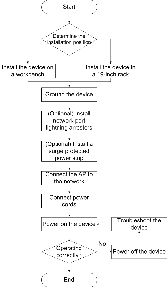

Installation flowchart
Figure2-1 Installation flowchart

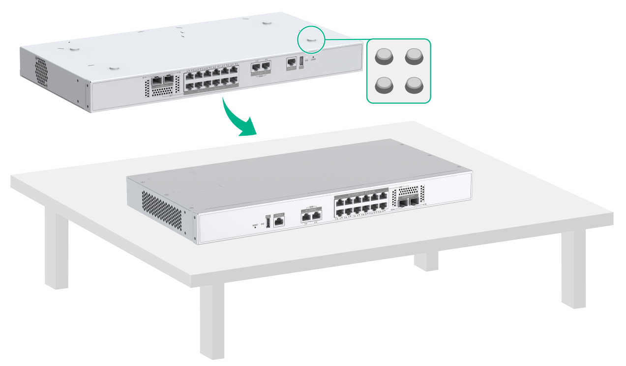

Mounting the device on a workbench
CAUTION: · Mount the device on a workbench in the equipment room. · Do not place heavy objects on the device. |
If a standard 19-inch rack is not available, you can mount the device on an anti-static workbench in the equipment room.
To mount the device on a workbench:
1. Place the device upside down. Clean the recessed areas on the chassis bottom.
2. Attach the four rubber feet to the recessed areas on the chassis bottom.
3. Place the device on the workbench with the upside up. Make sure the four rubber feet stand firmly on the workbench.
Figure2-2 Mounting the device on a workbench

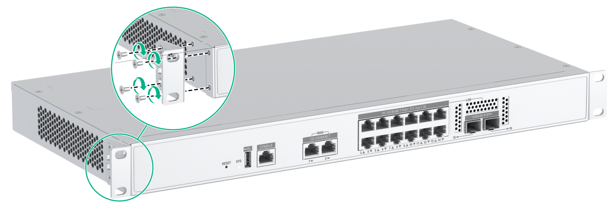

Installing the device in a 19-inch rack
IMPORTANT: · Mount the device in a 19-inch rack in the equipment room. · Keep a minimum distance of 1 U (44.45 mm, or 1.75 in) between devices in a rack for good heat dissipation. |
To install the device in a 19-inch rack in the equipment room by using mounting brackets:
1. Wear the ESD wrist strap and make sure the rack is sturdy and is reliably grounded.

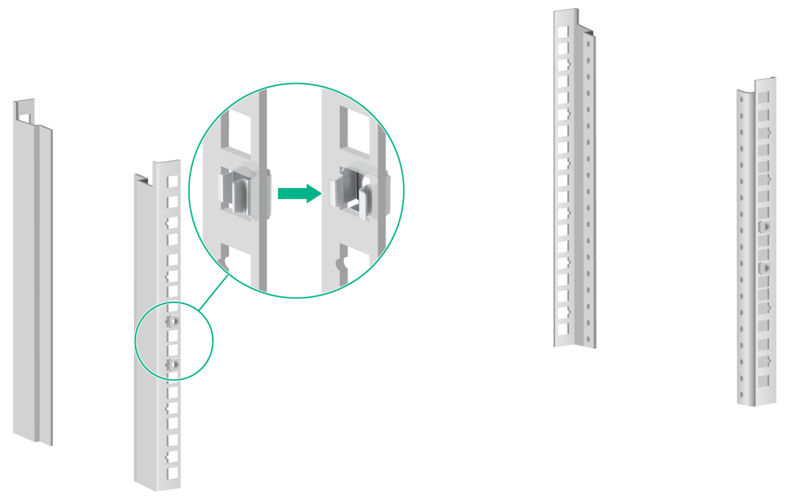

2. Attach cage nuts to the front rack posts:
a. Use a mounting bracket to mark cage nut installation positions on the two front rack posts.
b. Install cage nuts into the marked square holes on the front rack posts.
Figure2-3 Installing cage nuts
3. Unpack the M4 screws (packed with the mounting brackets), and then use the M4 screws to attach the mounting brackets to the device.
Figure2-4 Attaching the mounting brackets to the device

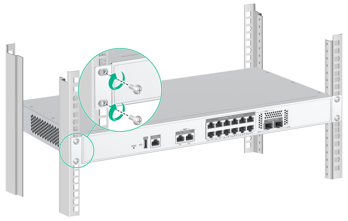

4. Supporting the device bottom with one hand and holding the device front with the other, push the device gently into the rack. Use M6 screws and matching cage nuts to attach the mounting brackets to the front rack posts. Make sure the device is installed in the rack securely.
Figure2-5 Attaching the mounting brackets to the front rack posts

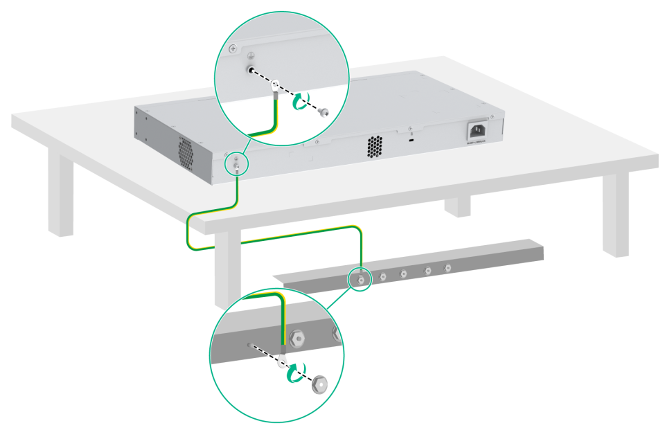

Grounding the device
WARNING! · Correctly connecting the grounding cable is crucial to lightning protection and EMI protection. Before installing or using the device, connect the grounding cable for it correctly. · Connect the grounding cable to the grounding system in the equipment room. Do not connect it to a fire main or lightning rod. |
To ground the device:
1. Use a Phillips screwdriver to remove the grounding screw from the chassis rear panel.
2. Use the grounding screw to attach a ring terminal of the grounding cable to the chassis.
3. Use one of the following methods to connect the other end of the grounding cable:
¡ Grounding the device by using a grounding strip
If a grounding strip is available, you can connect the other end of the grounding cable to the grounding strip. Make sure the grounding strip is grounded reliably.
Figure2-6 Grounding the device with a grounding strip

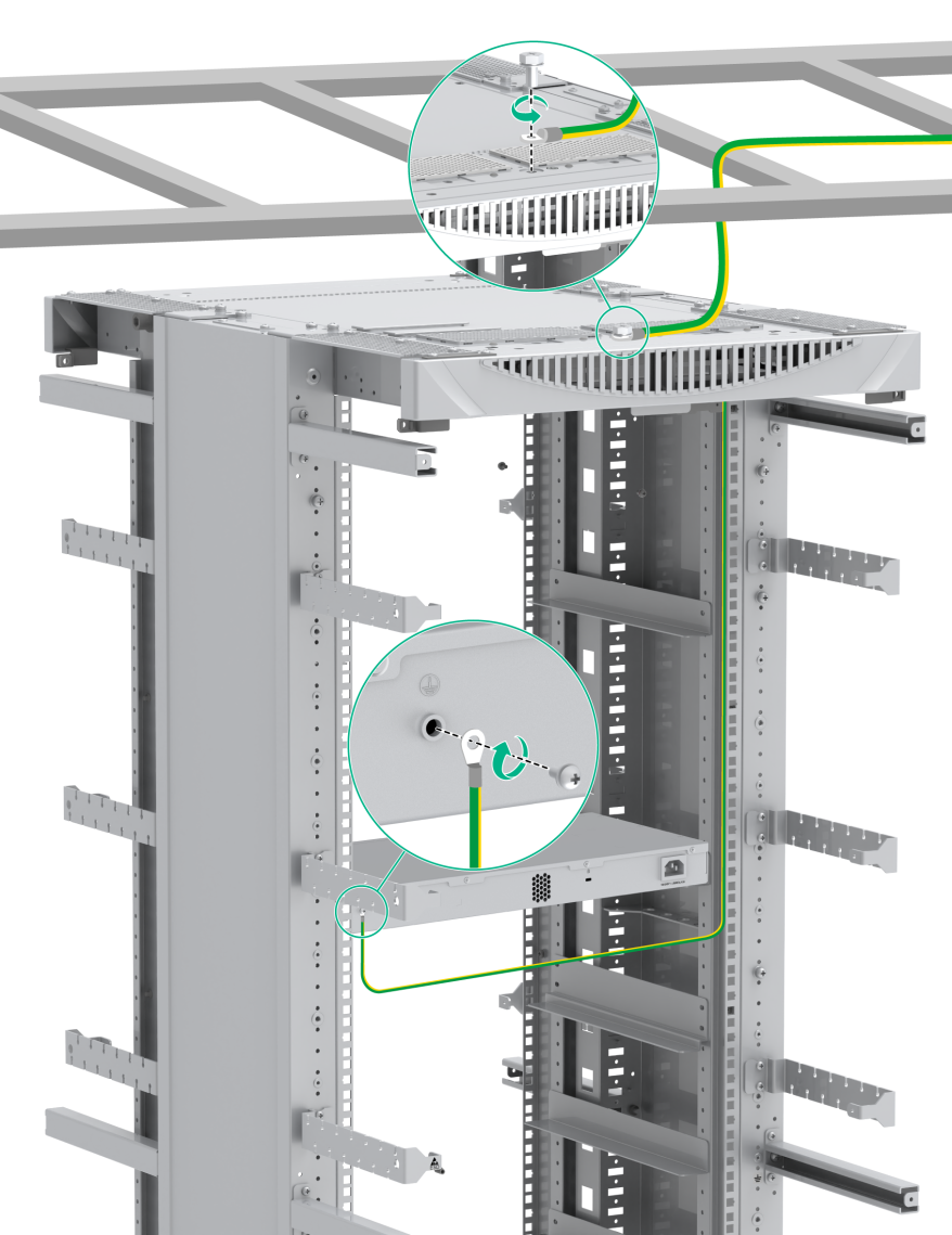

¡ Grounding the device through the rack
If the device is installed in a rack, you can connect the other end of the grounding cable to the grounding point on the rack. Make sure the rack is grounded reliably.
Figure2-7 Grounding the device through the rack

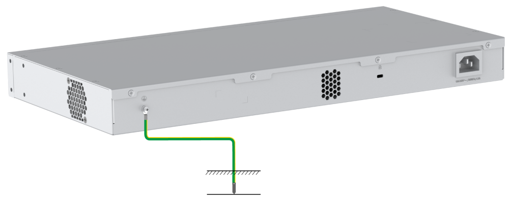

¡ Grounding the device with a grounding conductor buried in the earth
If earth is available at the installation site, you can ground the device with a grounding conductor buried in the earth.
Hammer a 0.5 m (1.64 ft) or longer angle iron or steel tube into the earth to serve as a grounding conductor. Weld the yellow-green grounding cable to the angel iron or steel tube and treat the joint for corrosion protection.
Figure2-8 Grounding the device by burying the grounding conductor into the earth

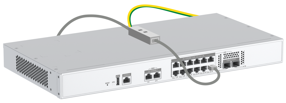

To install a network port lightning protector for a network port:
1. Use a double-faced adhesive tape to stick the network port lightning protector onto the device chassis, and make sure it is as close to the grounding screw of the device as possible.
2. Cut the ground wire of the protector to a length (as short as possible) as required by the distance between the protector and the grounding screw of the device. Attach the ground wire securely to the grounding screw of the device.
Make sure the grounding screw of the device is grounded reliably.
3. Use a multimeter to verify that the ground wire of the protector makes good contact with the grounding screw of the chassis.
4. Insert the outdoor network cable into the protector's Surge end marked IN, and insert the cable from the network port into the Protect end marked OUT.
5. Examine the port LED to verify that the port is operating correctly.
Figure2-9 Installing a lightning protector for a network port

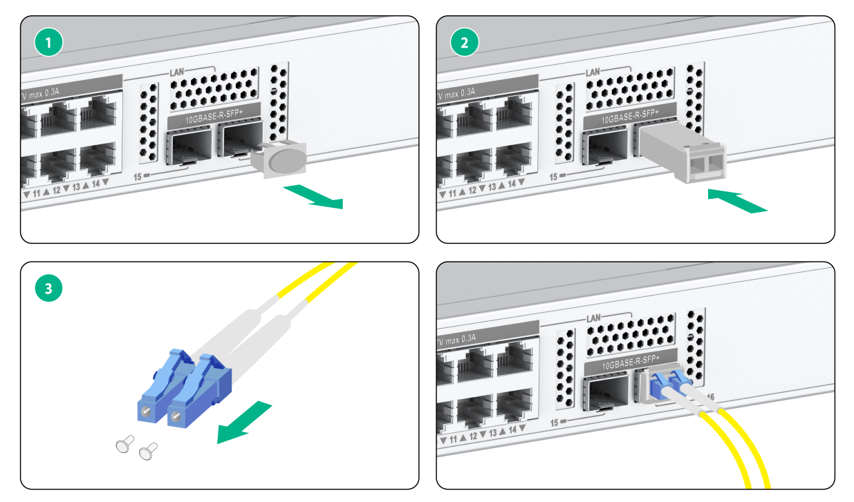

Connecting a fiber port
WARNING! Do not stare into any open apertures of operating transceiver modules or optical fiber connectors. The laser light emitted from these apertures might hurt your eyes. |
CAUTION: · To connect a fiber port by using an optical fiber, first install a transceiver module in the port and then connect the optical fiber to the transceiver module. · Insert a dust cap into any open optical fiber connector and a dust plug into any open fiber port or transceiver module port to protect them from contamination and ESD damage. · Never bend an optical fiber excessively. The bend radius of an optical fiber must be not less than 10 cm (3.94 in). · Keep the fiber end clean. · Make sure the Tx and Rx ports on a transceiver module are connected to the Rx and Tx ports on the peer end, respectively. |
No transceiver modules are provided with the device. Purchase transceiver modules yourself as required. For more information about the transceiver modules, see "Appendix C Optional transceiver modules."
The fiber ports on the device support only LC connectors.
To connect an optical fiber for a fiber port:
1. Remove the dust plug from the fiber port.
2. Pivot the bail latch of the transceiver module up so that it catches a knob on the top of the transceiver module.
3. Holding both sides of the transceiver module, insert the transceiver module slowly into the port.
4. Identify the Rx and Tx ports on the transceiver module and remove the dust caps from the optical fiber connectors. Use the optical fiber to connect the Rx port and Tx port on the transceiver module to the Tx port and Rx port on the peer end, respectively.
5. Examine the port LEDs:
¡ If the LED is on, a fiber link has been set up.
¡ If the LED is off, the link has not been set up. The reason might be wrong connection of the Tx and Rx ends. Swap the fiber connectors in the Tx and Rx ports at one end of the fiber.
Figure2-10 Connecting an optical fiber

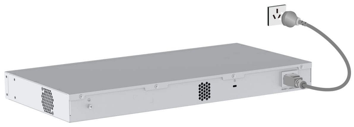

Connecting the power cord
WARNING! To avoid bodily injury, first connect the power cord to the device, and then connect the power cord to the power source in the equipment room. |
CAUTION: Before connecting the power cord, make sure the device is grounded correctly. |
To connect the power cord:
1. Connect one end of the AC power cord to the AC-input power receptacle on the device.
2. Connect the other end of the AC power cord to an AC power source.
Figure2-11 Connecting the power cord
