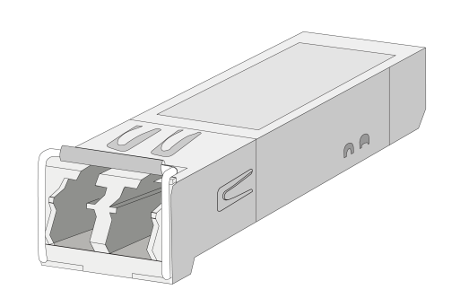

You must use an SFP transceiver module and optical fiber with an LC connector to connect the fiber port on the AC.
Figure7-1 SFP transceiver module

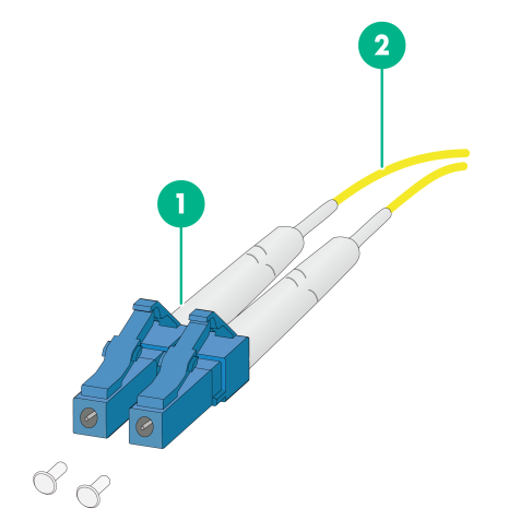

Figure7-2 Optical fibers with LC connectors
(1) LC connector
(2) Optical fiber
