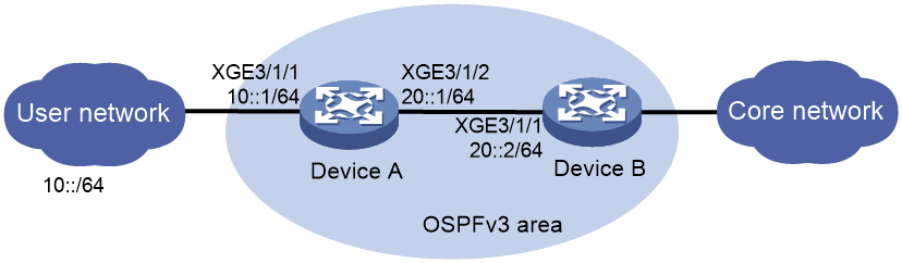

As shown in Figure 1, valid users in the LAN use prefix 10::/64. Configure SAVA-P on Device A and Device B to meet the following requirements:
·     Device A and Device B establish SAVA-P neighbor relationship and create SAVA-P entries through the SPA and DPP packets communicated between them.
·     Device A and Device B perform source address validity check and filter packets from the user network based on SAVA-P entries.
Figure 1 Network diagram
1.     Assign IPv6 addresses to interfaces on the devices.
2.     Configure OSPFv3 on the backbone network. For more information, see OSPFv3 configuration in Layer 3—IP Routing Configuration Guide.
1.     Configure Device A:
# Enable SAVA-P.
<DeviceA> system-view
[DeviceA] ipv6 sava protocol enable
# Specify the router ID and IPv6 transport address.
[DeviceA] ipv6 sava protocol id 1.1.1.1 transport-address 1::9
# Specify interface Ten-GigabitEthernet3/1/1 as a UNI and specify interface Ten-GigabitEthernet3/1/2 as a NNI.
[DeviceA] interface ten-gigabitethernet 3/1/1
[DeviceA-Ten-GigabitEthernet3/1/1] ipv6 sava protocol port-type uni
[DeviceA-Ten-GigabitEthernet3/1/1] quit
[DeviceA] interface ten-gigabitethernet 3/1/2
[DeviceA-Ten-GigabitEthernet3/1/2] ipv6 sava protocol port-type nni
[DeviceA-Ten-GigabitEthernet3/1/2] quit
2.     Configure Device B:
# Enable SAVA-P.
<DeviceB> system-view
[DeviceB] ipv6 sava protocol enable
[DeviceB] ipv6 sava protocol id 2.2.2.2 transport-address 2::9
# Specify the SAVA-P interface type.
[DeviceB] interface ten-gigabitethernet 3/1/1
[DeviceB-Ten-GigabitEthernet3/1/1] ipv6 sava protocol port-type nni
# Display SAVA-P entries on Device B.
<DeviceB> display ipv6 sava protocol entry
IPv6 SAVA protocol entry count: 4
Destination/Prefix length                          Interface       VPN instance
10::/64                                            XGE3/1/1         --
10::1/128                                          XGE3/1/1         --
20::/64                                            XGE3/1/1         --
20::1/128                                          XGE3/1/1         --
The output shows that Device B learned the SAVA-P entry corresponding to the source prefix of Device A. When Device B receives a user-side packet from Device A, it can perform packet source address validity check based on the SAVA-P entry.
