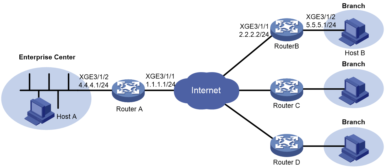

IPsec RRI
IPsec Reverse Route Injection (RRI) enables an IPsec tunnel gateway to automatically add and delete static routes destined for the protected private networks. It automatically adds the static routes when the IPsec SAs are established and deletes the static routes when the IPsec SAs are deleted. This greatly reduces the static route configuration work load on the gateway and increases the scalability of the IPsec VPN.
IPsec RRI is applicable to gateways that must provide many IPsec tunnels (for example, a headquarters gateway).
As shown in Figure 6, the traffic between the enterprise center and the branches are protected by IPsec. The gateway at the enterprise center is configured with static routes to route traffic to the IPsec-protected interfaces. It is difficult to add or modify static routes on the gateway at the enterprise center if the IPsec VPN has a large number of branches or if the network structure changes.
Figure 6 IPsec VPN
After you can enable IPsec RRI on the gateway, the gateway automatically adds a static route to the routing table each time an IPsec tunnel is established. The destination IP address is the protected private network, and the next hop is the remote IP address of the IPsec tunnel. Traffic destined for the peer end is routed to the IPsec tunnel interface and thereby protected by IPsec.
You can advertise the static routes created by IPsec RRI in the internal network, and the internal network device can use them to forward traffic in the IPsec VPN.
You can set preferences for the static routes created by IPsec RRI to implement flexible route management. For example, you can set the same preference for multiple routes to the same destination to implement load sharing, or you can set different preferences to implement route backup.
You can also set tags for the static routes created by IPsec RRI to implement flexible route control through routing policies.

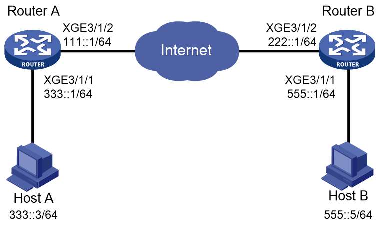

Mirror image ACLs
To make sure SAs can be set up and the traffic protected by IPsec can be processed correctly between two IPsec peers, create mirror image ACLs on the IPsec peers. As shown in Figure 7, ACL rules on Router B are mirror images of the rules on Router A. In this way, SAs can be created successfully for the traffic between Host A and Host C and for the traffic between Network 1 and Network 2.
Figure 7 Mirror image ACLs
If the ACL rules on IPsec peers do not form mirror images of each other, SAs can be set up only when both of the following requirements are met:
·     The range specified by an ACL rule on one peer is covered by its counterpart ACL rule on the other peer. As shown in Figure 8, the range specified by the ACL rule configured on Router A is covered by its counterpart on Router B.
·     The peer with the narrower rule initiates SA negotiation. If a wider ACL rule is used by the SA initiator, the negotiation request might be rejected because the matching traffic is beyond the scope of the responder. As shown in Figure 8, the SA negotiation initiated by Host A to Host C is accepted but the SA negotiations from Host C to Host A, from Host C to Host B, and from Host D to Host A are rejected.
Figure 8 Non-mirror image ACLs

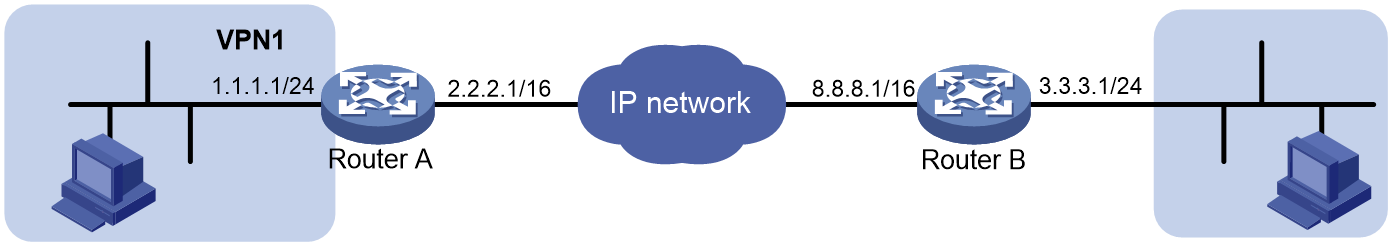

ACL for MPLS L3VPN IPsec protection
To use IPsec to protect the data of an MPLS L3VPN, you must specify the VPN instance for the protected data in the ACL.
As shown in Figure 9, to protect traffic of VPN1 by using IPsec, you must configure the ACL on Router A as follows:
acl advanced 3400
 rule 0 permit ip vpn-instance vpn1 source 1.1.1.0 0.0.0.255 destination 3.3.3.0 0.0.0.255
In addition, you must specify VPN1 as the inside VPN instance in the IKE profile.
ike profile vpn1
 keychain vpn1
 match remote identity address 8.8.8.1 255.255.255.255
 inside-vpn vpn-instance vpn1
Figure 9 IPsec for MPLS L3VPN

Configuring IPsec RRI
Enabling IPsec RRI for an IPsec policy deletes all existing IPsec SAs created by this IPsec policy. IPsec RRI creates static routes according to new IPsec SAs.
Disabling IPsec RRI for an IPsec policy deletes all existing IPsec SAs created by this IPsec policy and the associated static routes.
IPsec RRI is supported in both tunnel mode and transport mode.
If you change the preference value or tag value for an IPsec policy, the device deletes all IPsec SAs created by this IPsec policy, and the associated static routes. The change takes effect for future IPsec RRI-created static routes.
IPsec RRI does not generate a static route to a destination address to be protected if the destination address is not defined in the ACL used by an IPsec policy. You must manually configure a static route to the destination address.
In an MPLS L3VPN network, IPsec RRI can add static routes to VPN instances' routing tables.

Example: Configuring an IKE-based IPsec tunnel for IPv4 packets
As shown in Figure 10, establish an IPsec tunnel between Router A and Router B to protect data flows between subnet 10.1.1.0/24 and subnet 10.1.2.0/24. Configure the IPsec tunnel as follows:
·     Specify the encapsulation mode as tunnel, the security protocol as ESP, the encryption algorithm as 128-bit AES, and the authentication algorithm as HMAC-SHA1.
·     Set up SAs through IKE negotiation.
Figure 10 Network diagram
1.     Configure Router A:
# Configure IP addresses for interfaces. (Details not shown.)
# Configure an IPv4 advanced ACL to identify data flows from subnet 10.1.1.0/24 to subnet 10.1.2.0/24.
<RouterA> system-view
[RouterA] acl advanced 3101
[RouterA-acl-ipv4-adv-3101] rule permit ip source 10.1.1.0 0.0.0.255 destination 10.1.2.0 0.0.0.255
[RouterA-acl-ipv4-adv-3101] quit
# Configure a static route to Host B. The command uses the direct next hop address (2.2.2.3) as an example.
[RouterA] ip route-static 10.1.2.0 255.255.255.0 ten-gigabitethernet 3/1/2 2.2.2.3
# Create an IPsec transform set named tran1.
[RouterA] ipsec transform-set tran1
# Specify the encapsulation mode as tunnel.
[RouterA-ipsec-transform-set-tran1] encapsulation-mode tunnel
# Specify the security protocol as ESP.
[RouterA-ipsec-transform-set-tran1] protocol esp
# Specify the ESP encryption and authentication algorithms.
[RouterA-ipsec-transform-set-tran1] esp encryption-algorithm aes-cbc-128
[RouterA-ipsec-transform-set-tran1] esp authentication-algorithm sha1
[RouterA-ipsec-transform-set-tran1] quit
# Create an IKE keychain named keychain1.
[RouterA] ike keychain keychain1
# Specify 123456TESTplat&! in plain text as the pre-shared key to be used with the remote peer at 2.2.3.1.
[RouterA-ike-keychain-keychain1] pre-shared-key address 2.2.3.1 255.255.255.0 key simple 123456TESTplat&!
[RouterA-ike-keychain-keychain1] quit
# Create and configure the IKE profile named profile1.
[RouterA] ike profile profile1
[RouterA-ike-profile-profile1] keychain keychain1
[RouterA-ike-profile-profile1] match remote identity address 2.2.3.1 255.255.255.0
[RouterA-ike-profile-profile1] quit
# Create an IKE-based IPsec policy entry. Specify the policy name as map1 and set the sequence number to 10.
[RouterA] ipsec policy map1 10 isakmp
# Apply ACL 3101.
[RouterA-ipsec-policy-isakmp-map1-10] security acl 3101
# Apply IPsec transform set tran1.
[RouterA-ipsec-policy-isakmp-map1-10] transform-set tran1
# Specify the local and remote IP addresses of the IPsec tunnel as 2.2.2.1 and 2.2.3.1.
[RouterA-ipsec-policy-isakmp-map1-10] local-address 2.2.2.1
[RouterA-ipsec-policy-isakmp-map1-10] remote-address 2.2.3.1
# Specify the primary slot for processing IPsec traffic.
[RouterA-ipsec-policy-isakmp-map1-10] service slot 3
# Specify the backup slot for processing IPsec traffic.
[RouterA-ipsec-policy-isakmp-map1-10] service standby slot 5
# Apply IKE profile profile1.
[RouterA-ipsec-policy-isakmp-map1-10] ike-profile profile1
[RouterA-ipsec-policy-isakmp-map1-10] quit
# Apply IPsec policy map1 to Ten-GigabitEthernet 3/1/2.
[RouterA] interface ten-gigabitethernet 3/1/2
[RouterA-Ten-GigabitEthernet3/1/2] ip address 2.2.2.1 255.255.255.0
[RouterA-Ten-GigabitEthernet3/1/2] ipsec apply policy map1
[RouterA-Ten-GigabitEthernet3/1/2] quit
2.     Configure Router B:
# Configure an IPv4 advanced ACL to identify data flows from subnet 10.1.2.0/24 to subnet 10.1.1.0/24.
<RouterB> system-view
[RouterB] acl advanced 3101
[RouterB-acl-ipv4-adv-3101] rule permit ip source 10.1.2.0 0.0.0.255 destination 10.1.1.0 0.0.0.255
[RouterB-acl-ipv4-adv-3101] quit
# Configure a static route to Host A. The command uses the direct next hop address (2.2.3.3) as an example.
[RouterB] ip route-static 10.1.1.0 255.255.255.0 ten-gigabitethernet 3/1/2 2.2.3.3
[RouterB] ipsec transform-set tran1
[RouterB-ipsec-transform-set-tran1] encapsulation-mode tunnel
[RouterB-ipsec-transform-set-tran1] protocol esp
[RouterB-ipsec-transform-set-tran1] esp encryption-algorithm aes-cbc-128
[RouterB-ipsec-transform-set-tran1] esp authentication-algorithm sha1
[RouterB-ipsec-transform-set-tran1] quit
[RouterB] ike keychain keychain1
# Specify 123456TESTplat&! in plain text as the pre-shared key to be used with the remote peer at 2.2.2.1.
[RouterB-ike-keychain-keychain1] pre-shared-key address 2.2.2.1 255.255.255.0 key simple 123456TESTplat&!
[RouterB-ike-keychain-keychain1] quit
[RouterB] ike profile profile1
[RouterB-ike-profile-profile1] keychain keychain1
[RouterB-ike-profile-profile1] match remote identity address 2.2.2.1 255.255.255.0
[RouterB-ike-profile-profile1] quit
# Create an IKE-based IPsec policy entry. Specify the policy name as use1 and set the sequence number to 10.
[RouterB] ipsec policy use1 10 isakmp
# Apply ACL 3101.
[RouterB-ipsec-policy-isakmp-use1-10] security acl 3101
[RouterB-ipsec-policy-isakmp-use1-10] transform-set tran1
# Specify the local and remote IP addresses of the IPsec tunnel as 2.2.3.1 and 2.2.2.1.
[RouterB-ipsec-policy-isakmp-use1-10] local-address 2.2.3.1
[RouterB-ipsec-policy-isakmp-use1-10] remote-address 2.2.2.1
[RouterB-ipsec-policy-isakmp-use1-10] service slot 3
[RouterB-ipsec-policy-isakmp-use1-10] service standby slot 5
[RouterB-ipsec-policy-isakmp-use1-10] ike-profile profile1
[RouterB-ipsec-policy-isakmp-use1-10] quit
# Apply IPsec policy use1 to Ten-GigabitEthernet 3/1/2.
[RouterB] interface ten-gigabitethernet 3/1/2
[RouterB-Ten-GigabitEthernet3/1/2] ip address 2.2.3.1 255.255.255.0
[RouterB-Ten-GigabitEthernet3/1/2] ipsec apply policy use1
[RouterB-Ten-GigabitEthernet3/1/2] quit
# Initiate a connection from subnet 10.1.1.0/24 to subnet 10.1.2.0/24 to trigger IKE negotiation. After IPsec SAs are successfully negotiated by IKE, the traffic between the two subnets is IPsec-protected.
# Display IPsec SAs on Router A and Router B. This example uses Router A to verify the configuration.
[RouterA] display ipsec sa
Interface: Ten-GigabitEthernet3/1/2
  IPsec policy: map1
  Sequence number: 10
  Mode: ISAKMP
    Tunnel id: 0
    Encapsulation mode: tunnel
    Perfect Forward Secrecy:
    Inside VPN:
    Extended Sequence Numbers enable: N
    Traffic Flow Confidentiality enable: N
    Path MTU: 1443
    Transmitting entity: Initiator
    Tunnel:
        local  address: 2.2.3.1
        remote address: 2.2.2.1
    Flow:
        sour addr: 10.1.1.0/255.255.255.0  port: 0  protocol: ip
        dest addr: 10.1.2.0/255.255.255.0  port: 0  protocol: ip
    [Inbound ESP SAs]
      SPI: 3769702703 (0xe0b1192f)
      Connection ID: 90194313219
      Transform set: ESP-ENCRYPT-AES-CBC-128 ESP-AUTH-SHA1
      SA duration (kilobytes/sec): 3000/28800
      SA remaining duration (kilobytes/sec): 2300/797
      Max received sequence-number: 1
      Anti-replay check enable: N
      Anti-replay window size:
      UDP encapsulation used for NAT traversal: N
      Status: Active
    [Outbound ESP SAs]
      SPI: 3840956402 (0xe4f057f2)
      Connection ID: 64424509441
      SA remaining duration (kilobytes/sec): 2312/797
      Max sent sequence-number: 1
      Status: Active

Example: Configuring IPsec for RIPng
As shown in Figure 12, Router A, Router B, and Router C learn IPv6 routes through RIPng.
Establish an IPsec tunnel between the routers to protect the RIPng packets transmitted in between. Specify the security protocol as ESP, the encryption algorithm as 128-bit AES, and the authentication algorithm as HMAC-SHA1 for the IPsec tunnel.
Figure 12 Network diagram
Analysis
To meet the network configuration requirements, perform the following tasks:
1.     Configure basic RIPng.
For more information about RIPng configuration, see Layer 3—IP Routing Configuration Guide.
2.     Configure an IPsec profile.
¡     The IPsec profiles on all the routers must have IPsec transform sets that use the same security protocol, authentication and encryption algorithms, and encapsulation mode.
¡     The SPI and key configured for the inbound SA and those for the outbound SA must be the same on each router.
¡     The SPI and key configured for the SAs on all the routers must be the same.
3.     Apply the IPsec profile to a RIPng process or to an interface.

# Create an IPsec transform set named tran1, and specify ESP as the security protocol, DES as the encryption algorithm, and HMAC-SHA-1-96 as the authentication algorithm.
[RouterA-ipsec-transform-set-tran1] esp encryption-algorithm des
# Create and configure the IPsec profile named profile1.
[RouterA-ike-profile-profile1] keychain key1
[RouterA-ike-profile-profile1] match remote identity address 2.2.2.2 255.255.255.0
# Create an IKE-based IPsec policy entry named map1. Specify IPsec transform set tran1 and IKE profile profile1 for the IPsec policy.
# Enable IPsec RRI, and set the preference to 100 and the tag to 1000 for the static routes created by IPsec RRI.
[RouterA-ipsec-policy-isakmp-map1-10] reverse-route dynamic
[RouterA-ipsec-policy-isakmp-map1-10] reverse-route preference 100
[RouterA-ipsec-policy-isakmp-map1-10] reverse-route tag 1000
# Create an IKE proposal named 1, and specify 3DES as the encryption algorithm, HMAC-SHA1 as the authentication algorithm, and pre-share as the authentication method.
[RouterA] ike proposal 1
[RouterA-ike-proposal-1] encryption-algorithm 3des-cbc
[RouterA-ike-proposal-1] authentication-algorithm sha
[RouterA-ike-proposal-1] authentication-method pre-share
[RouterA-ike-proposal-1] quit
# Create an IKE keychain named key1 and specify 123 in plain text as the pre-shared key to be used with the remote peer at 2.2.2.2.
[RouterA] ike keychain key1
[RouterA-ike-keychain-key1] pre-shared-key address 2.2.2.2 key simple 123
[RouterA-ike-keychain-key1] quit
# Apply IPsec policy map1 to Ten-GigabitEthernet 3/1/1.
[RouterA] interface ten-gigabitethernet 3/1/1
[RouterA-Ten-GigabitEthernet3/1/1] ipsec apply policy map1
[RouterA-Ten-GigabitEthernet3/1/1] quit
3.     Configure Router B:
[RouterB-ipsec-transform-set-tran1] esp encryption-algorithm des
# Configure IPv4 advanced ACL 3000 to identify traffic from subnet 5.5.5.0/24 to subnet 4.4.4.0/24.
[RouterB] acl advanced 3000
[RouterB-acl-ipv4-adv-3000] rule permit ip source 5.5.5.0 0.0.0.255 destination 4.4.4.0 0.0.0.255
[RouterB-acl-ipv4-adv-3000] quit
# Create and configure an IKE profile named profile1.
[RouterB-ike-profile-profile1] keychain key1
[RouterB-ike-profile-profile1] match remote identity address 1.1.1.1 255.255.255.0
# Create an IKE-based IPsec policy entry named map1 and configure the following settings for the policy entry:
¡     Set the sequence number to 10.
¡     Specify transform set tran1 and ACL 3000.
¡     Specify the remote IP address for the tunnel as 1.1.1.1.
¡     Specify IKE profile profile1.
[RouterB] ipsec policy map1 10 isakmp
[RouterB-ipsec-policy-isakmp-map1-10] transform-set tran1
[RouterB-ipsec-policy-isakmp-map1-10] security acl 3000
[RouterB-ipsec-policy-isakmp-map1-10] remote-address 1.1.1.1
[RouterB-ipsec-policy-isakmp-map1-10] ike-profile profile1
[RouterB-ipsec-policy-isakmp-map1-10] service slot 3
[RouterB-ipsec-policy-isakmp-map1-10] service standby slot 5
[RouterB-ipsec-policy-isakmp-map1-10] quit
[RouterB] ike proposal 1
[RouterB-ike-proposal-1] encryption-algorithm 3des-cbc
[RouterB-ike-proposal-1] authentication-algorithm sha
[RouterB-ike-proposal-1] authentication-method pre-share
[RouterB-ike-proposal-1] quit
# Create an IKE keychain named key1 and specify 123 in plain text as the pre-shared key to be used with the remote peer at 1.1.1.1.
[RouterB] ike keychain key1
[RouterB-ike-keychain-key1] pre-shared-key address 1.1.1.1 key simple 123
[RouterB-ike-keychain-key1] quit
[RouterB] interface ten-gigabitethernet 3/1/1
[RouterB-Ten-GigabitEthernet3/1/1] ipsec apply policy map1
[RouterB-Ten-GigabitEthernet3/1/1] quit
Make sure Router B has a route to the peer private network, with the outgoing interface as Ten-GigabitEthernet 3/1/1.
4.     Configure Router C and Router D in the same way Router B is configured.
1.     Verify that IPsec RRI can automatically create a static route from Router A to Router B:
# Initiate a connection from subnet 5.5.5.0/24 to subnet 4.4.4.0/24. IKE negotiation is triggered to establish IPsec SAs between Router A and Router B. (Details not shown.)
# Verify that IPsec SAs are established on Router A.

Example: Main mode IKE with pre-shared key authentication configuration example
As shown in Figure 17, configure an IKE-based IPsec tunnel between Device A and Device B to secure the communication between subnet 10.1.1.0/24 and subnet 10.1.2.0/24.
·     Configure Device A and Device B to use the default IKE proposal for the IKE negotiation to set up the IPsec SAs.
·     Configure the two devices to use the pre-shared key authentication method for the IKE negotiation phase 1.
Figure 17 Network diagram
1.     Configure Device A:

Example: Aggressive mode with RSA signature authentication configuration example
As shown in Figure 18, configure an IKE-based IPsec tunnel between Device A and Device B to secure the communication between subnet 10.1.1.0/24 and subnet 10.1.2.0/24.
Configure Device A and Device B to use aggressive mode for IKE negotiation phase 1 and to use RSA signature authentication. Device A acts as the initiator, and the subnet where Device A resides uses IP addresses dynamically allocated.
Figure 18 Network diagram

IKEv2 configuration examples
Example: IKEv2 with pre-shared key authentication configuration example
As shown in Figure 20, configure an IKE-based IPsec tunnel between Device A and Device B to secure the communication between subnet 10.1.1.0/24 and subnet 10.1.2.0/24.
·     Configure Device A and Device B to use the default IKEv2 proposal and the default IKEv2 policy in IKEv2 negotiation to set up IPsec SAs.
·     Configure the two devices to use the pre-shared key authentication method in IKEv2 negotiation.
Figure 20 Network diagram

# Set the packet encapsulation mode to tunnel.
[DeviceA-ipsec-transform-set-tran1] encapsulation-mode tunnel
# Use the ESP protocol for the IPsec transform set.
[DeviceA-ipsec-transform-set-tran1] protocol esp
# Specify the encryption and authentication algorithms.
[DeviceA-ipsec-transform-set-tran1] esp encryption-algorithm des-cbc
[DeviceA-ipsec-transform-set-tran1] esp authentication-algorithm sha1
[DeviceA-ipsec-transform-set-tran1] quit
# Create a PKI entity named entity1.
[DeviceA] pki entity entity1
# Set the common name to routera for the PKI entity.
[DeviceA-pki-entity-entity1] common-name routera
[DeviceA-pki-entity-entity1] quit
# Create a PKI domain named domain1.
[DeviceA] pki domain domain1
# Set the certificate request mode to auto and set the password to 123 for certificate revocation.
[DeviceA-pki-domain-domain1] certificate request mode auto password simple 123
# Set an MD5 fingerprint for verifying the validity of the CA root certificate.
[DeviceA-pki-domain-domain1] root-certificate fingerprint md5 50c7a2d282ea710a449eede6c56b102e
# Specify the trusted CA 8088.
[DeviceA-pki-domain-domain1] ca identifier 8088
# Specify the URL of the registration server for certificate request through the SCEP protocol. This example uses http://192.168.222.1:446/eadbf9af4f2c4641e685f7a6021e7b298373feb7.
[DeviceA-pki-domain-domain1] certificate request url http://192.168.222.1:446/eadbf9af4f2c4641e685f7a6021e7b298373feb7
# Specify the CA to accept certificate requests.
[DeviceA-pki-domain-domain1] certificate request from ca
# Specify the PKI entity for certificate request as entity1.
[DeviceA-pki-domain-domain1] certificate request entity entity1
# Specify RSA key pair rsa1 with the general purpose for certificate request.
[DeviceA-pki-domain-domain1] public-key rsa general name rsa1
[DeviceA-pki-domain-domain1] quit
# Create an IKEv2 profile named profile1.
[DeviceA] ikev2 profile profile1
# Specify the local authentication method as RSA signatures.
[DeviceA-ikev2-profile-profile1] authentication-method local rsa-signature
# Specify the remote authentication method as RSA signatures.
[DeviceA-ikev2-profile-profile1] authentication-method remote rsa-signature
# Specify PKI domain domain1 for the IKEv2 profile.
[DeviceA-ikev2-profile-profile1] certificate domain domain1
# Set the local ID to FQDN name www.routera.com.
[DeviceA-ikev2-profile-profile1] identity local fqdn www.routera.com
# Specify the peer ID that the IKEv2 profile matches. The peer ID is FQDN name www.example.com.
[DeviceA-ikev2-profile-profile1] match remote identity fqdn www.example.com
[DeviceA-ikev2-profile-profile1] quit
# Create an IKEv2 proposal named 10.
[DeviceA] ikev2 proposal 10
# Specify the integrity protection algorithm as HMAC-MD5.
[DeviceA-ikev2-proposal-10] integrity md5
# Specify the encryption algorithm as 3DES-CBC.
[DeviceA-ikev2-proposal-10] encryption 3des-cbc
# Specify the DH group as Group 1.
[DeviceA-ikev2-proposal-10] dh group1
# Specify the PRF algorithm as HMAC-MD5.
[DeviceA-ikev2-proposal-10] prf md5
[DeviceA-ikev2-proposal-10] quit
# Create an IKEv2 policy named 1.
[DeviceA] ikev2 policy 1
# Specify IKEv2 proposal 10 for the IKEv2 policy.
[DeviceA-ikev2-policy-1] proposal 10
[DeviceA-ikev2-policy-1] quit
[DeviceA] ipsec policy map1 10 isakmp
# Specify remote IP address 2.2.2.2 for the IPsec tunnel.
[DeviceA-ipsec-policy-isakmp-map1-10] remote-address 2.2.2.2
# Specify IPsec transform set tran1 for the IPsec policy.
[DeviceA-ipsec-policy-isakmp-map1-10] transform-set tran1
# Specify ACL 3101 to identify the traffic to be protected.
[DeviceA-ipsec-policy-isakmp-map1-10] security acl 3101
# Specify IKEv2 profile profile1 for the IPsec policy.
[DeviceA-ipsec-policy-isakmp-map1-10] ikev2-profile profile1
[DeviceA-ipsec-policy-isakmp-map1-10] service slot 3
[DeviceA-ipsec-policy-isakmp-map1-10] service standby slot 5
[DeviceA-ipsec-policy-isakmp-map1-10] quit
[DeviceA] interface ten-gigabitethernet 3/1/1
[DeviceA-Ten-GigabitEthernet3/1/1] ipsec apply policy map1
[DeviceA-Ten-GigabitEthernet3/1/1] quit
# Configure a static route to the subnet where Host B resides. This example uses 2.2.2.1 as the next hop IP address.
[DeviceA] ip route-static 10.1.2.0 255.255.255.0 2.2.2.1
2.     Configure Device B:
# Assign an IP address to each interface. (Details not shown.)
# Configure IPv4 advanced ACL 3101 to identify traffic from subnet 10.1.2.0/24 to subnet 10.1.1.0/24.
<DeviceB> system-view
[DeviceB] acl advanced 3101
[DeviceB-acl-ipv4-adv-3101] rule permit ip source 10.1.2.0 0.0.0.255 destination 10.1.1.0 0.0.0.255
[DeviceB-acl-ipv4-adv-3101] quit
[DeviceB] ipsec transform-set tran1
[DeviceB-ipsec-transform-set-tran1] encapsulation-mode tunnel
[DeviceB-ipsec-transform-set-tran1] protocol esp
[DeviceB-ipsec-transform-set-tran1] esp encryption-algorithm des-cbc
[DeviceB-ipsec-transform-set-tran1] esp authentication-algorithm sha1
[DeviceB-ipsec-transform-set-tran1] quit
# Create a PKI entity named entity2.
[DeviceB] pki entity entity2
# Set the common name to routerb for the PKI entity.
[DeviceB-pki-entity-entity2] common-name routerb
[DeviceB-pki-entity-entity2] quit
# Create a PKI domain named domain2.
[DeviceB] pki domain domain2
[DeviceB-pki-domain-domain2] certificate request mode auto password simple 123
[DeviceB-pki-domain-domain2] root-certificate fingerprint md5 50c7a2d282ea710a449eede6c56b102e
[DeviceB-pki-domain-domain2] ca identifier 8088
[DeviceB-pki-domain-domain2] certificate request url http://192.168.222.1:446/eadbf9af4f2c4641e685f7a6021e7b298373feb7
[DeviceB-pki-domain-domain2] certificate request from ca
# Specify the PKI entity for certificate request as entity2.
[DeviceB-pki-domain-domain2] certificate request entity entity2
[DeviceB-pki-domain-domain2] public-key rsa general name rsa1
[DeviceB-pki-domain-domain2] quit
# Create an IKEv2 profile named profile2.
[DeviceB] ikev2 profile profile2
[DeviceB-ikev2-profile-profile2] authentication-method local rsa-signature
[DeviceB-ikev2-profile-profile2] authentication-method remote rsa-signature
# Set the local identity to FQDN name www.example.com.
[DeviceB-ikev2-profile-profile2] identity local fqdn www.example.com
# Specify the peer ID that the IKEv2 profile matches. The peer ID is FQDN name www.routera.com.
[DeviceB-ikev2-profile-profile2] match remote identity fqdn www.routera.com
[DeviceB-ikev2-profile-profile2] quit
[DeviceB] ikev2 proposal 10
[DeviceB-ikev2-proposal-10] integrity md5
[DeviceB-ikev2-proposal-10] encryption 3des-cbc
[DeviceB-ikev2-proposal-10] dh group1
[DeviceB-ikev2-proposal-10] prf md5
[DeviceB-ikev2-proposal-10] quit
[DeviceB] ikev2 policy 1
[DeviceB-ikev2-policy-1] proposal 10
[DeviceB-ikev2-policy-1] quit
# Create an IKE-based IPsec policy entry. Specify the policy name as use1 and set the sequence number to 1.
[DeviceB] ipsec policy use1 1 isakmp
# Specify the remote IP address 1.1.1.1 for the IPsec tunnel.
[DeviceB-ipsec-policy-isakmp-use1-1] remote-address 1.1.1.1
[DeviceB-ipsec-policy-isakmp-use1-1] security acl 3101
[DeviceB-ipsec-policy-isakmp-use1-1] transform-set tran1
# Specify IKEv2 profile profile2 for the IPsec policy.
[DeviceB-ipsec-policy-isakmp-use1-1] ikev2-profile profile2
[DeviceB-ipsec-policy-isakmp-use1-1] service slot 3
[DeviceB-ipsec-policy-isakmp-use1-1] service standby slot 5
[DeviceB-ipsec-policy-isakmp-use1-1] quit
# Apply IPsec policy use1 to Ten-GigabitEthernet 3/1/1.
[DeviceB] interface ten-gigabitethernet 3/1/1
[DeviceB-Ten-GigabitEthernet3/1/1] ipsec apply policy use1
[DeviceB-Ten-GigabitEthernet3/1/1] quit
# Configure a static route to the subnet where Host A resides. This example uses 1.1.1.2 as the next hop IP address.
[DeviceB] ip route-static 10.1.1.0 255.255.255.0 1.1.1.2
# Initiate a connection from subnet 10.1.1.0/24 to subnet 10.1.2.0/24 to trigger IKEv2 negotiation. After IPsec SAs are successfully negotiated by IKEv2, traffic between the two subnets is IPsec-protected.
# Display the IKEv2 proposal configuration on Device A and Device B.
[DeviceA] display ikev2 proposal 10
IKEv2 proposal : 10
  Encryption : 3DES-CBC
  Integrity : MD5
  PRF : MD5
  DH Group : MODP768/Group1
[DeviceB] display ikev2 proposal 10
IKEv2 proposal : 10
  Integrity : MD5
  PRF : MD5
# Display the IKEv2 policy configuration Device A and Device B.
[DeviceA] display ikev2 policy 1
IKEv2 policy : 1
  Priority: 100
  Match Local : any
  Match VRF : public
  Proposal : 10
[DeviceB] display ikev2 policy 1
IKEv2 policy : 1
  Priority: 100
  Match Local : any
  Match VRF : public
  Proposal : 10
# Display the IKEv2 SA on Device A.
[DeviceA] display ikev2 sa
Tunnel ID   Local                       Remote                      Status
  1        1.1.1.1/500                  2.2.2.2/500                  EST
Status:
IN-NEGO: Negotiating, EST: Established, DEL:Deleting
# Display information about the CA certificate on Device A.
[DeviceA] display pki certificate domain domain1 ca
Certificate:
    Data:
        Version: 1 (0x0)
        Serial Number:
            b9:14:fb:25:c9:08:2c:9d:f6:94:20:30:37:4e:00:00
        Signature Algorithm: sha1WithRSAEncryption
        Issuer: C=cn, O=rnd, OU=sec, CN=8088
        Validity
            Not Before: Sep  6 01:53:58 2012 GMT
            Not After : Sep  8 01:50:58 2015 GMT
        Subject: C=cn, O=rnd, OU=sec, CN=8088
        Subject Public Key Info:
            Public Key Algorithm: rsaEncryption
                Public-Key: (1024 bit)
                Modulus:
                    00:de:81:f4:42:c6:9f:c2:37:7b:21:84:57:d6:42:
                    00:69:1c:4c:34:a4:5e:bb:30:97:45:2b:5e:52:43:
                    c0:49:1f:e1:d8:0f:5c:48:c2:39:69:d1:84:e4:14:
                    70:3d:98:41:28:1c:20:a1:9a:3f:91:67:78:77:27:
                    d9:08:5f:7a:c4:36:45:8b:f9:7b:e7:7d:6a:98:bb:
                    4e:a1:cb:2c:3d:92:66:bd:fb:80:35:16:c6:35:f0:
                    ff:0b:b9:3c:f3:09:94:b7:d3:6f:50:8d:83:f1:66:
                    2f:91:0b:77:a5:98:22:b4:77:ac:84:1d:03:8e:33:
                    1b:31:03:78:4f:77:a0:db:af
                Exponent: 65537 (0x10001)
        9a:6d:8c:46:d3:18:8a:00:ce:12:ee:2b:b0:aa:39:5d:3f:90:
        08:49:b9:a9:8f:0d:6e:7b:e1:00:fb:41:f5:d4:0c:e4:56:d8:
        7a:a7:61:1d:2b:b6:72:e3:09:0b:13:9d:fa:c8:fc:c4:65:a7:
        f9:45:21:05:75:2c:bf:36:7b:48:b4:4a:b9:fe:87:b9:d8:cf:
        55:16:87:ec:07:1d:55:5a:89:74:73:68:5e:f9:1d:30:55:d9:
        8a:8f:c5:d4:20:7e:41:a9:37:57:ed:8e:83:a7:80:2f:b8:31:
        57:3a:f2:1a:28:32:ea:ea:c5:9a:55:61:6a:bc:e5:6b:59:0d:
        82:16
# Display the local certificate on Device A.
[DeviceA]display pki certificate domain domain1 local
Certificate:
    Data:
        Version: 3 (0x2)
        Serial Number:
            a1:f4:d4:fd:cc:54:c3:07:c4:9e:15:2d:5f:64:57:77
        Validity
            Not Before: Sep 26 02:06:43 2012 GMT
            Not After : Sep 26 02:06:43 2013 GMT
        Subject: CN=devicea
                Modulus:
                    00:b0:a1:cd:24:6e:1a:1d:51:79:f0:2a:3e:9f:e9:
                    84:07:16:78:49:1b:7d:0b:22:f0:0a:ed:75:91:a4:
                    17:fd:c7:ef:d0:66:5c:aa:e3:2a:d9:71:12:e4:c6:
                    25:77:f0:1d:97:bb:92:a8:bd:66:f8:f8:e8:d5:0d:
                    d2:c8:01:dd:ea:e6:e0:80:ad:db:9d:c8:d9:5f:03:
                    2d:22:07:e3:ed:cc:88:1e:3f:0c:5e:b3:d8:0e:2d:
                    ea:d6:c6:47:23:6a:11:ef:3c:0f:6b:61:f0:ca:a1:
                    79:a0:b1:02:1a:ae:8c:c9:44:e0:cf:d1:30:de:4c:
                    f0:e5:62:e7:d0:81:5d:de:d3
        X509v3 extensions:
            X509v3 CRL Distribution Points:
                Full Name:
                  URI:http://xx.rsa.com:447/8088.crl
        73:ac:66:f9:b8:b5:39:e1:6a:17:e4:d0:72:3e:26:9e:12:61:
        9e:c9:7a:86:6f:27:b0:b9:a3:5d:02:d9:5a:cb:79:0a:12:2e:
        cb:e7:24:57:e6:d9:77:12:6b:7a:cf:ee:d6:17:c5:5f:d2:98:
        30:e0:ef:00:39:4a:da:ff:1c:29:bb:2a:5b:60:e9:33:8f:78:
        f9:15:dc:a5:a3:09:66:32:ce:36:cd:f0:fe:2f:67:e5:72:e5:
