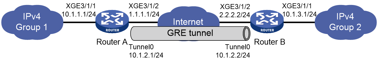

As shown in Figure 7, Group 1 and Group 2 are two private IPv4 networks. The two networks both use private network addresses and belong to the same VPN. Establish a GRE tunnel between Router A and Router B to interconnect the two private IPv4 networks Group 1 and Group 2.
Figure 7 Network diagram
Configure the IP address of each interface, and make sure Router A and Router B can reach each other.
1.     Configure Router A:
# Create a tunnel interface Tunnel 0, and specify the tunnel mode as GRE/IPv4.
<RouterA> system-view
[RouterA] interface tunnel 0 mode gre
# Configure an IP address for the tunnel interface.
[RouterA-Tunnel0] ip address 10.1.2.1 255.255.255.0
# Configure the source address of the tunnel interface as the IP address of Ten-GigabitEthernet 3/1/2 on Router A.
[RouterA-Tunnel0] source 1.1.1.1
# Configure the destination address of the tunnel interface as the IP address of Ten-GigabitEthernet 3/1/2 on Router B.
[RouterA-Tunnel0] destination 2.2.2.2
[RouterA-Tunnel0] quit
# Configure a static route from Router A through the tunnel interface to Group 2.
[RouterA] ip route-static 10.1.3.0 255.255.255.0 tunnel 0

[RouterB-Tunnel0] source 2.2.2.2
# Configure the destination address of the tunnel interface as the IP address of the interface Ten-GigabitEthernet 3/1/2 on Router A.
[RouterB-Tunnel0] destination 1.1.1.1
[RouterB-Tunnel0] quit
# Configure a static route from Router B through the tunnel interface to Group 1.
[RouterB] ip route-static 10.1.1.0 255.255.255.0 tunnel 0
# Display tunnel interface information on Router A.

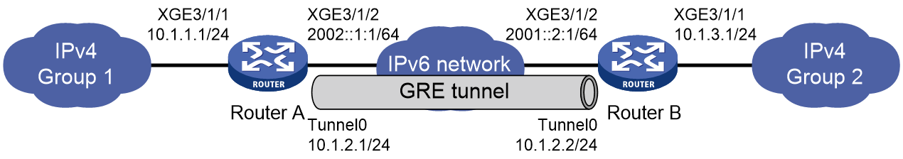

Example: Configuring an IPv4 over IPv6 GRE tunnel
As shown in Figure 8, two IPv4 subnets Group 1 and Group 2 are connected to an IPv6 network. Create a GRE/IPv6 tunnel between Router A and Router B, so the two IPv4 subnets can communicate with each other through the GRE tunnel over the IPv6 network.
Figure 8 Network diagram
# Create a tunnel interface Tunnel 0, and specify the tunnel mode as GRE/IPv6.
[RouterA] interface tunnel 0 mode gre ipv6
# Configure the source address of the tunnel interface as the IP address of interface Ten-GigabitEthernet 3/1/2 on Router A.
[RouterA-Tunnel0] source 2002::1:1
# Configure the destination address of the tunnel interface as the IP address of interface Ten-GigabitEthernet 3/1/2 on Router B.
[RouterA-Tunnel0] destination 2001::2:1
