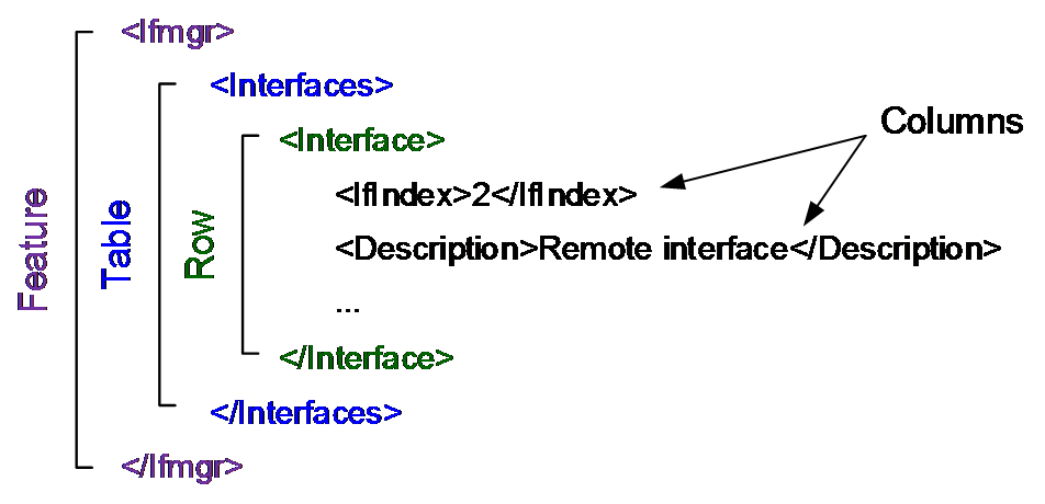

Node, module, table, row, and column
In H3C NETCONF XML AI references, elements are also called nodes. An element might be a module (or feature), table, row, or column node, as shown in Figure 1.
·     Module—A feature module defines a hierarchy of related nodes. The element name for a module node is the module name.
·     Table—A table contains rows and columns, with each row representing an object instance and each column containing a parameter for the instance. A table might also contains subtables.
·     Row—Each row represents an object instance in the table.
·     Column—Each column contains a parameter for the instance.
Figure 1 Node, module, table, row, and column in NETCONF messages
In Figure 1, the Ifmgr element represents the interface management module (Ifmgr). The Interfaces element is a table node in the Ifmgr module and it contains a table of interfaces. The Interface element is a row node and it contains data about an interface in the interface table. The IfIndex and Description elements are column nodes that contain the interface index and description of the interface.

    <data>
        <top xmlns="http://www.h3c.com/netconf/data:1.0">
            <Ifmgr>
                <Interfaces>
                    <Interface>
                        <IfIndex>2681</IfIndex>
                        <Description>Ten-GigabitEthernet3/0/1 Interface</Description>
                    </Interface>
                    <Interface>
                        <IfIndex>2685</IfIndex>
                        <Description>Ten-GigabitEthernet3/0/2 Interface</Description>
                    </Interface>
                    <Interface>
                        <IfIndex>2689</IfIndex>
                        <Description>Ten-GigabitEthernet3/0/3 Interface</Description>
                    </Interface>
                 <Interface>
            </Ifmgr>
        </top>
    </data>
</rpc-reply>
