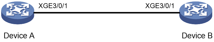

As shown in Figure 1, Device A obtains its timing signal from an external BITS clock.
Device A and Device B are connected on POS interfaces. Configure Device B to derive its timing from Device A through Pos 3/0/1.
1. On Device A:
# Specify the master clock mode on Pos 3/0/1.
<DeviceA> system-view
[DeviceA] interface pos 3/0/1
[DeviceA-Pos3/0/1] clock master
[DeviceA-Pos3/0/1] quit
2. On Device B:
# Specify Pos 3/0/1 as a line clock input port.
<DeviceB> system-view
[DeviceB] network-clock lpuport pos 3/0/1
# Specify the slave clock mode on the Pos 3/0/1.
[DeviceB] interface pos 3/0/1
[DeviceB-Pos3/0/1] clock slave
[DeviceB-Pos3/0/1] quit
# Specify Pos 3/0/1 as the source to provide clock reference.
[DeviceB] network-clock work-mode manual source lpuport pos 3/0/1
[DeviceB] quit
# Verify that Pos 3/0/1 provides the network clock reference for Device B.
<DeviceB> display network-clock status
Mode : Manual
Reference : pos 3/0/1
Traced reference : pos 3/0/1
Lock mode : Locked
OSC state : Normal
SSM output level : SSUB
SSM control enable: Off

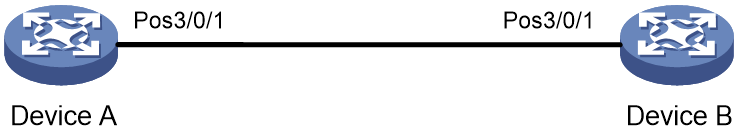

As shown in Figure 2, configure SyncE on the devices for high-precision frequency synchronization.
# On Device A, enable the synchronous mode and ESMC on Ten-GigabitEthernet 3/0/1.
[DeviceA] interface ten-gigabitethernet 3/0/1
[DeviceA-Ten-GigabitEthernet3/0/1] synchronous mode
[DeviceA-Ten-GigabitEthernet3/0/1] esmc enable
[DeviceA-Ten-GigabitEthernet3/0/1] quit
# On Device B, enable the synchronous mode and ESMC on Ten-GigabitEthernet 3/0/1.
[DeviceB] interface ten-gigabitethernet 3/0/1
[DeviceB-Ten-GigabitEthernet3/0/1] synchronous mode
[DeviceB-Ten-GigabitEthernet3/0/1] esmc enable
[DeviceB-Ten-GigabitEthernet3/0/1] quit
# Verify that ESMC is enabled on both Device A and Device B when they are connected to their respective clock references. The clock QLs of Device A and Device B are QL-PRC and QL-SEC, respectively. Device A provides more precise timing than Device B.
[DeviceA] display esmc
Interface : Ten-GigabitEthernet3/0/1
Mode : Synchronous
ESMC status : Enable
ESMC bundle : N/A
Port status : Up
Duplex mode : Full
QL received : QL-SEC
QL sent : QL-PRC
ESMC information packets received : 2195
ESMC information packets sent : 6034
ESMC event packets received : 1
ESMC event packets sent : 1
ESMC information rate : 1 packets/sec
ESMC expiration : 5 seconds
[DeviceB] display esmc
Mode : Synchronous
ESMC bundle : N/A
Port status : Up
Duplex mode : Full
QL received : QL-PRC
QL sent : QL-SEC
ESMC information packets received : 6034
ESMC information packets sent : 2195
# Verify that QL information is exchanged correctly after synchronization between Device A and Device B. Ten-GigabitEthernet3/0/1 on Device B becomes a reference input port. The clock QL sent from Device B to Device A changes to QL-DNU.
Mode : Synchronous
ESMC bundle : N/A
Port status : Up
Duplex mode : Full
QL received : QL-DNU
QL sent : QL-PRC
ESMC information packets received : 2573
ESMC information packets sent : 6412
Mode : Synchronous
ESMC bundle : N/A
Port status : Up
Duplex mode : Full
QL sent : QL-DNU
ESMC information packets received : 6412
ESMC information packets sent : 2573
