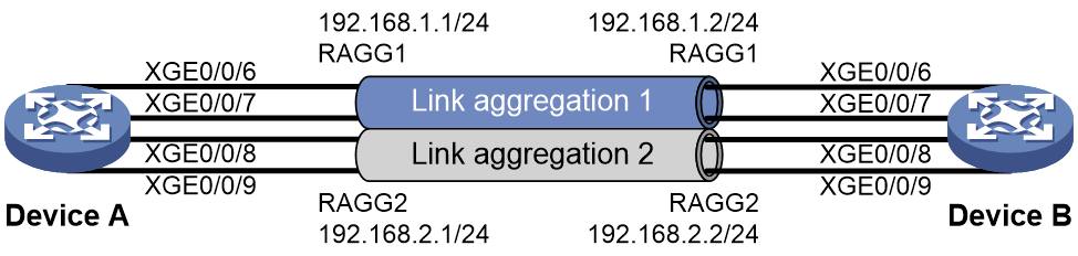

S-MLAG
Simple multichassis link aggregation (S-MLAG) enhances dynamic link aggregation to establish an aggregation that spans multiple standalone devices to a remote device.
An S-MLAG multichassis aggregation connects one dynamic Layer 2 aggregate interface on each S-MLAG device to the remote device, as shown in Figure 5.
S-MLAG uses an S-MLAG group to manage the aggregate interfaces for each aggregation, and it runs LACP to maintain each aggregation as does dynamic link aggregation. To the remote device, the S-MLAG devices appear as one peer aggregation system.
Figure 5 S-MLAG application scenario

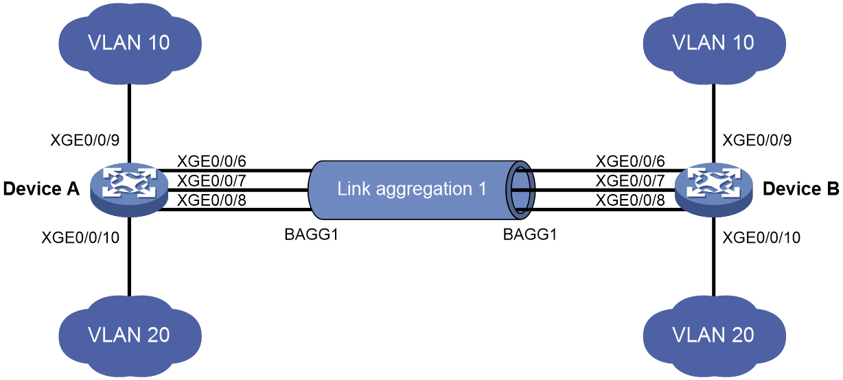

Example: Configuring a Layer 2 static aggregation group
On the network shown in Figure 6, perform the following tasks:
·     Configure a Layer 2 static aggregation group on both Device A and Device B.
·     Enable VLAN 10 at one end of the aggregate link to communicate with VLAN 10 at the other end.
·     Enable VLAN 20 at one end of the aggregate link to communicate with VLAN 20 at the other end.
Figure 6 Network diagram
1.     Configure Device A:
# Create VLAN 10, and assign port Ten-GigabitEthernet 0/0/9 to VLAN 10.
<DeviceA> system-view
[DeviceA] vlan 10
[DeviceA-vlan10] port ten-gigabitethernet 0/0/9
[DeviceA-vlan10] quit
# Create VLAN 20, and assign port Ten-GigabitEthernet 0/0/10 to VLAN 20.
[DeviceA] vlan 20
[DeviceA-vlan20] port ten-gigabitethernet 0/0/10
[DeviceA-vlan20] quit
# Create Layer 2 aggregate interface Bridge-Aggregation 1.
[DeviceA] interface bridge-aggregation 1
[DeviceA-Bridge-Aggregation1] quit
# Assign ports Ten-GigabitEthernet 0/0/6 through Ten-GigabitEthernet 0/0/8 to link aggregation group 1.
[DeviceA] interface ten-gigabitethernet 0/0/6
[DeviceA-Ten-GigabitEthernet0/0/6] port link-aggregation group 1
[DeviceA-Ten-GigabitEthernet0/0/6] quit
[DeviceA] interface ten-gigabitethernet 0/0/7
[DeviceA-Ten-GigabitEthernet0/0/7] port link-aggregation group 1
[DeviceA-Ten-GigabitEthernet0/0/7] quit
[DeviceA] interface ten-gigabitethernet 0/0/8
[DeviceA-Ten-GigabitEthernet0/0/8] port link-aggregation group 1
[DeviceA-Ten-GigabitEthernet0/0/8] quit
# Configure Layer 2 aggregate interface Bridge-Aggregation 1 as a trunk port and assign it to VLANs 10 and 20.
[DeviceA-Bridge-Aggregation1] port link-type trunk
[DeviceA-Bridge-Aggregation1] port trunk permit vlan 10 20
2.     Configure Device B in the same way Device A is configured. (Details not shown.)
# Display detailed information about all aggregation groups on Device A.
[DeviceA] display link-aggregation verbose
Loadsharing Type: Shar -- Loadsharing, NonS -- Non-Loadsharing
Port Status: S -- Selected, U -- Unselected, I -- Individual
Port: A -- Auto port, M -- Management port, R -- Reference port
Flags:  A -- LACP_Activity, B -- LACP_Timeout, C -- Aggregation,
        G -- Defaulted, H -- Expired
Aggregate Interface: Bridge-Aggregation1
Aggregation Mode: Static
Management VLANs: None
  Port             Status  Priority Oper-Key
  XGE1/0/1(R)      S       32768    1
  XGE1/0/2         S       32768    1
  XGE1/0/3         S       32768    1
The output shows that link aggregation group 1 is a Layer 2 static aggregation group that contains three Selected ports.

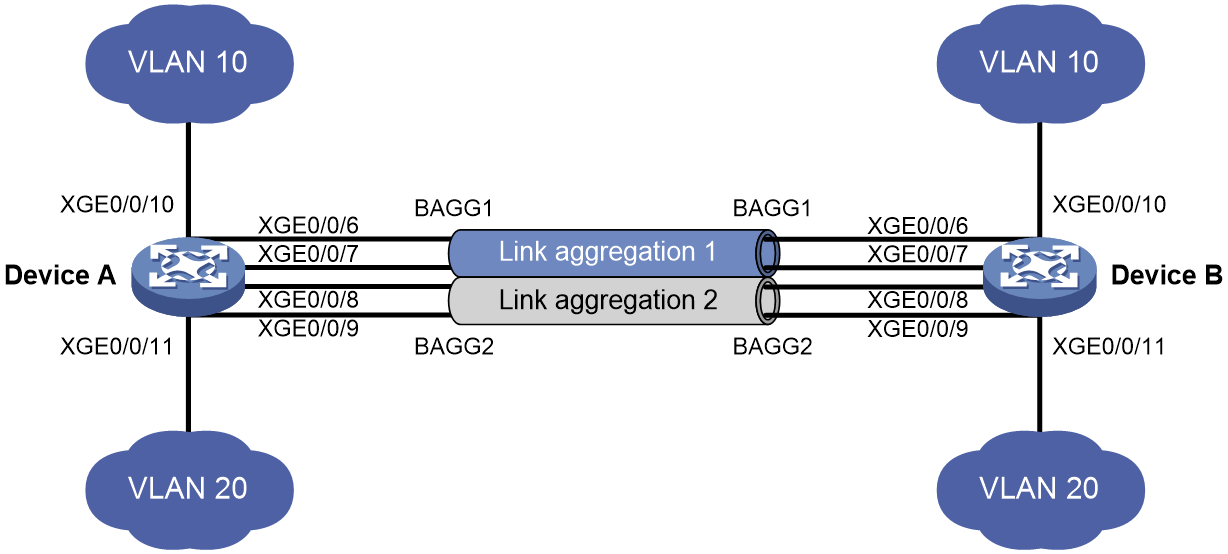

Example: Configuring Layer 2 aggregation load sharing
On the network shown in Figure 8, perform the following tasks:
·     Configure Layer 2 static aggregation groups 1 and 2 on Device A and Device B, respectively.
·     Configure link aggregation groups 1 and 2 to load share traffic across aggregation group member ports.
¡     Configure link aggregation group 1 to load share packets based on source MAC addresses.
¡     Configure link aggregation group 2 to load share packets based on destination MAC addresses.
Figure 8 Network diagram
# Create VLAN 10, and assign the port Ten-GigabitEthernet 0/0/10 to VLAN 10.
[DeviceA] vlan 10
[DeviceA-vlan10] port ten-gigabitethernet 0/0/10
# Create VLAN 20, and assign the port Ten-GigabitEthernet 0/0/11 to VLAN 20.
[DeviceA] vlan 20
[DeviceA-vlan20] port ten-gigabitethernet 0/0/11
# Configure Layer 2 aggregation group 1 to load share packets based on source MAC addresses.
[DeviceA-Bridge-Aggregation1] link-aggregation load-sharing mode source-mac
# Assign ports Ten-GigabitEthernet 0/0/6 and Ten-GigabitEthernet 0/0/7 to link aggregation group 1.
# Configure Layer 2 aggregate interface Bridge-Aggregation 1 as a trunk port and assign it to VLAN 10.
# Create Layer 2 aggregate interface Bridge-Aggregation 2.
[DeviceA] interface bridge-aggregation 2
# Configure Layer 2 aggregation group 2 to load share packets based on destination MAC addresses.
[DeviceA-Bridge-Aggregation2] link-aggregation load-sharing mode destination-mac
[DeviceA-Bridge-Aggregation2] quit
# Assign ports Ten-GigabitEthernet 0/0/8 and Ten-GigabitEthernet 0/0/9 to link aggregation group 2.
[DeviceA-Ten-GigabitEthernet0/0/8] port link-aggregation group 2
[DeviceA] interface ten-gigabitethernet 0/0/9
[DeviceA-Ten-GigabitEthernet0/0/9] port link-aggregation group 2
[DeviceA-Ten-GigabitEthernet0/0/9] quit
# Configure Layer 2 aggregate interface Bridge-Aggregation 2 as a trunk port and assign it to VLAN 20.
[DeviceA-Bridge-Aggregation2] port link-type trunk
[DeviceA-Bridge-Aggregation2] port trunk permit vlan 20
  XGE1/0/2         S       32768    1
Aggregate Interface: Bridge-Aggregation2
  XGE1/0/3(R)      S       32768    2
  XGE1/0/4         S       32768    2
The output shows that:
·     Link aggregation groups 1 and 2 are both load-shared Layer 2 static aggregation groups.
·     Each aggregation group contains two Selected ports.
# Display all the group-specific load sharing modes on Device A.
[DeviceA] display link-aggregation load-sharing mode interface
Bridge-Aggregation1 Load-Sharing Mode:
source-mac address
Bridge-Aggregation2 Load-Sharing Mode:
destination-mac address
·     Link aggregation group 1 distributes packets based on source MAC addresses.
·     Link aggregation group 2 distributes packets based on destination MAC addresses.

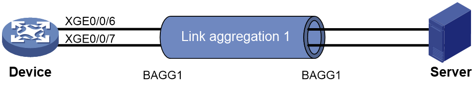

Example: Configuring a Layer 2 edge aggregate interface
As shown in Figure 9, a Layer 2 dynamic aggregation group is configured on the device. The server is not configured with dynamic link aggregation.
Configure an edge aggregate interface so that both Ten-GigabitEthernet 0/0/6 and Ten-GigabitEthernet 0/0/7 can forward traffic to improve link reliability.
Figure 9 Network diagram
# Create Layer 2 aggregate interface Bridge-Aggregation 1, and set the link aggregation mode to dynamic.
<Device> system-view
[Device] interface bridge-aggregation 1
[Device-Bridge-Aggregation1] link-aggregation mode dynamic
# Configure Layer 2 aggregate interface Bridge-Aggregation 1 as an edge aggregate interface.
[Device-Bridge-Aggregation1] lacp edge-port

# Display detailed information about all aggregation groups on the device when the server is not configured with dynamic link aggregation.
[Device] display link-aggregation verbose
Creation Mode: Manual
Aggregation Mode: Dynamic
System ID: 0x8000, 000f-e267-6c6a
Local:
  Port                Status   Priority Index    Oper-Key               Flag
  XGE1/0/1            I        32768    11       1                      {AG}
  XGE1/0/2            I        32768    12       1                      {AG}
Remote:
  Actor               Priority Index    Oper-Key SystemID               Flag
  XGE1/0/1            32768    81       0        0x8000, 0000-0000-0000 {DEF}
  XGE1/0/2            32768    82       0        0x8000, 0000-0000-0000 {DEF}
The output shows that Ten-GigabitEthernet 0/0/6 and Ten-GigabitEthernet 0/0/7 are in Individual state when they do not receive LACPDUs from the server. Both Ten-GigabitEthernet 0/0/6 and Ten-GigabitEthernet 0/0/7 can forward traffic. When one port fails, its traffic is automatically switched to the other port.

Example: Configuring Layer 3 aggregation load sharing
On the network shown in Figure 12, perform the following tasks:
·     Configure Layer 3 static aggregation groups 1 and 2 on Device A and Device B, respectively.
·     Configure IP addresses and subnet masks for the corresponding Layer 3 aggregate interfaces.
·     Configure link aggregation group 1 to load share packets based on source IP addresses.
·     Configure link aggregation group 2 to load share packets based on destination IP addresses.
Figure 12 Network diagram
# Create Layer 3 aggregate interface Route-Aggregation 1.
[DeviceA] interface route-aggregation 1
# Configure Layer 3 aggregation group 1 to load share packets based on source IP addresses.
[DeviceA-Route-Aggregation1] link-aggregation load-sharing mode source-ip
# Configure an IP address and subnet mask for Layer 3 aggregate interface Route-Aggregation 1.
[DeviceA-Route-Aggregation1] ip address 192.168.1.1 24
[DeviceA-Route-Aggregation1] quit
# Assign Layer 3 Ethernet interfaces Ten-GigabitEthernet 0/0/6 and Ten-GigabitEthernet 0/0/7 to aggregation group 1.
# Create Layer 3 aggregate interface Route-Aggregation 2.
[DeviceA] interface route-aggregation 2
# Configure Layer 3 aggregation group 2 to load share packets based on destination IP addresses.
[DeviceA-Route-Aggregation2] link-aggregation load-sharing mode destination-ip
# Configure an IP address and subnet mask for Layer 3 aggregate interface Route-Aggregation 2.
[DeviceA-Route-Aggregation2] ip address 192.168.2.1 24
[DeviceA-Route-Aggregation2] quit
# Assign Layer 3 Ethernet interfaces Ten-GigabitEthernet 0/0/8 and Ten-GigabitEthernet 0/0/9 to aggregation group 2.
Aggregate Interface: Route-Aggregation1
  XGE1/0/2         S       32768    1
Aggregate Interface: Route-Aggregation2
  XGE1/0/4         S       32768    2
·     Link aggregation groups 1 and 2 are both load-shared Layer 3 static aggregation groups.
Route-Aggregation1 Load-Sharing Mode:
source-ip address
Route-Aggregation2 Load-Sharing Mode:
destination-ip address
·     Link aggregation group 1 distributes packets based on source IP addresses.
·     Link aggregation group 2 distributes packets based on destination IP addresses.
