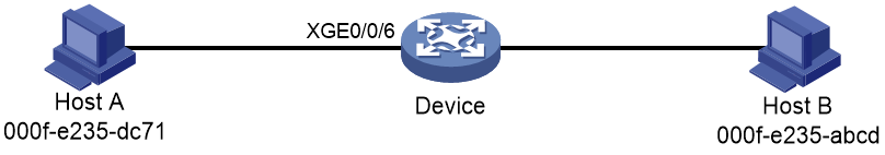

Example: Configuring the MAC address table
As shown in Figure 1:
·     Host A at MAC address 000f-e235-dc71 is connected to Ten-GigabitEthernet 0/0/6 of Device and belongs to VLAN 1.
·     Host B at MAC address 000f-e235-abcd, which behaved suspiciously on the network, also belongs to VLAN 1.
Configure the MAC address table as follows:
·     To prevent MAC address spoofing, add a static entry for Host A in the MAC address table of Device.
·     To drop all frames destined for Host B, add a blackhole MAC address entry for Host B.
·     Set the aging timer to 400seconds for dynamic MAC address entries.
Figure 1 Network diagram
