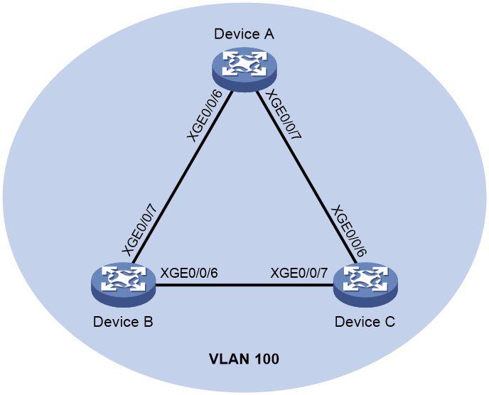

Example: Configuring basic loop detection functions
As shown in Figure 3, configure loop detection on Device A to meet the following requirements:
·     Device A generates a log as a notification.
·     Device A automatically shuts down the port on which a loop is detected.
Figure 3 Network diagram
1.     Configure Device A:

# View the system logs on devices, for example, Device A.
[DeviceA]
%Feb 24 15:04:29:663 2019 DeviceA LPDT/4/LPDT_LOOPED:  A loop was detected on Ten-GigabitEthernet0/0/6.
%Feb 24 15:04:29:664 2019 DeviceA LPDT/4/LPDT_VLAN_LOOPED: A loop was detected on Ten-GigabitEthernet0/0/6 in VLAN 100.
%Feb 24 15:04:29:667 2019 DeviceA LPDT/4/LPDT_LOOPED: A loop was detected on Ten-GigabitEthernet0/0/7.
%Feb 24 15:04:29:668 2019 DeviceA LPDT/4/LPDT_VLAN_LOOPED: A loop was detected on Ten-GigabitEthernet0/0/7 in VLAN 100.
%Feb 24 15:04:44:243 2019 DeviceA LPDT/5/LPDT_VLAN_RECOVERED: A loop was removed on Ten-GigabitEthernet0/0/6 in VLAN 100.
%Feb 24 15:04:44:243 2019 DeviceA LPDT/5/LPDT_RECOVERED: All loops were removed on Ten-GigabitEthernet0/0/6.
%Feb 24 15:04:44:248 2019 DeviceA LPDT/5/LPDT_VLAN_RECOVERED: A loop was removed on Ten-GigabitEthernet0/0/7 in VLAN 100.
%Feb 24 15:04:44:248 2019 DeviceA LPDT/5/LPDT_RECOVERED: All loops were removed on Ten-GigabitEthernet0/0/7.
The output shows the following information:
·     Device A detected loops on Ten-GigabitEthernet 0/0/6 and Ten-GigabitEthernet 0/0/7 within a loop detection interval.
·     Loops on Ten-GigabitEthernet 0/0/6 and Ten-GigabitEthernet 0/0/7 were removed.
# Use the display loopback-detection command to display the loop detection configuration and status on devices, for example, Device A.
[DeviceA] display loopback-detection
Loop detection is enabled.
Loop detection interval is 35 second(s).
Loop is detected on following interfaces:
 Interface                      Action mode     VLANs
 Ten-GigabitEthernet0/0/6       Shutdown        100
 Ten-GigabitEthernet0/0/7       Shutdown        100
The output shows that the device has removed the loops from Ten-GigabitEthernet 0/0/6 and Ten-GigabitEthernet 0/0/7 according to the shutdown action.
# Display the status of Ten-GigabitEthernet 0/0/6 on devices, for example, Device A.
[DeviceA] display interface ten-gigabitethernet 0/0/6
Ten-GigabitEthernet0/0/6 current state: DOWN (Loop detection down)
The output shows that Ten-GigabitEthernet 0/0/6 is already shut down by the loop detection module.
# Display the status of Ten-GigabitEthernet 0/0/7 on devices, for example, Device A.
[DeviceA] display interface ten-gigabitethernet 0/0/7
Ten-GigabitEthernet0/0/7 current state: DOWN (Loop detection down)
The output shows that Ten-GigabitEthernet 0/0/7 is already shut down by the loop detection module.
