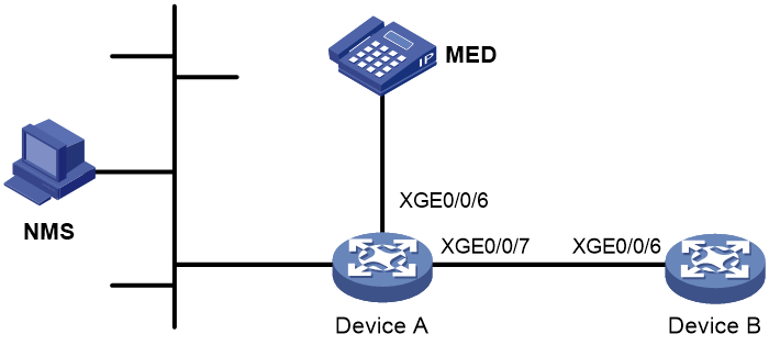

LLDP exchanges packets between neighbor agents and creates and maintains neighbor information for them. Figure 1 shows the neighbor relationships for these LLDP agents.
Figure 1 LLDP neighbor relationships

Example: Configuring basic LLDP functions
As shown in Figure 5, enable LLDP globally on Device A and Device B to perform the following tasks:
·     Monitor the link between Device A and Device B on the NMS.
·     Monitor the link between Device A and the MED device on the NMS.
Figure 5 Network diagram
