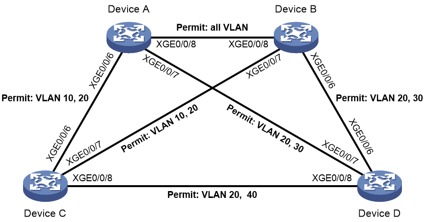

As shown in Figure 3, Device B and Device C are directly connected to a LAN.
If Device A forwards BPDUs to Device B through port A1, the designated bridge and designated port are as follows:
·     The designated bridge for Device B is Device A.
·     The designated port for Device B is port A1 on Device A.
If Device B forwards BPDUs to the LAN, the designated bridge and designated port are as follows:
·     The designated bridge for the LAN is Device B.
·     The designated port for the LAN is port B2 on Device B.
Figure 3 Designated bridges and designated ports

As shown in Figure 6, Device A is the root bridge. The priority of Device B is higher than the priority of Device C. Port C2 on Device C is blocked.
When the link between Device A and Device B fails, the following events occur:
1.     Device B sends an RSTP BPDU with itself as the root bridge to Device C.
2.     Device C compares the RSTP BPDU with its own BPDU.
3.     Because the RSTP BPDU from Device B has a lower priority, Device C sends its own BPDU to Device B.
4.     Device B considers that Port B2 is the root port and stops sending RSTP BPDUs to Device C.

As shown in Figure 12, Port C3 is an edge port connected to a host. When a network topology change occurs, the port can immediately transit from the blocking state to the forwarding state because no loop will be caused.
Because a device cannot determine whether a port is directly connected to a terminal, you must manually configure the port as an edge port.
Figure 12 Edge port rapid transition

Figure 16 Rapid state transition of an MSTP designated port
Figure 17 Rapid state transition of an RSTP designated port

As shown in Figure 18, all devices on the network are in the same MST region. Device A and Device B work at the distribution layer. Device C and Device D work at the access layer.
Configure MSTP so that frames of different VLANs are forwarded along different spanning trees.
·     VLAN 10 frames are forwarded along MSTI 1.
·     VLAN 30 frames are forwarded along MSTI 3.
·     VLAN 40 frames are forwarded along MSTI 4.
·     VLAN 20 frames are forwarded along MSTI 0.
VLAN 10 and VLAN 30 are terminated on the distribution layer devices, and VLAN 40 is terminated on the access layer devices. The root bridges of MSTI 1 and MSTI 3 are Device A and Device B, respectively, and the root bridge of MSTI 4 is Device C. Device B has the lowest root bridge ID.
Figure 18 Network diagram
As shown in Figure 18, configure VLANs and VLAN member ports. (Details not shown.)

Based on the output, you can draw each MSTI mapped to each VLAN, as shown in Figure 19.
Figure 19 MSTIs mapped to different VLANs

# Display brief spanning tree information on Device C.
[DeviceC] display stp brief
 VLAN ID     Port                         Role  STP State     Protection
 10          Ten-GigabitEthernet0/0/6     ROOT  FORWARDING    NONE
 10          Ten-GigabitEthernet0/0/7     ALTE  DISCARDING    NONE
 20          Ten-GigabitEthernet0/0/6     ROOT  FORWARDING    NONE
 20          Ten-GigabitEthernet0/0/7     ALTE  DISCARDING    NONE
 20          Ten-GigabitEthernet0/0/8     DESI  FORWARDING    NONE
 40          Ten-GigabitEthernet0/0/8     DESI  FORWARDING    NONE
# Display brief spanning tree information on Device D.
[DeviceD] display stp brief
 20          Ten-GigabitEthernet0/0/6     ALTE  DISCARDING    NONE
 20          Ten-GigabitEthernet0/0/7     ROOT  FORWARDING    NONE
 20          Ten-GigabitEthernet0/0/8     ALTE  DISCARDING    NONE
 30          Ten-GigabitEthernet0/0/6     ROOT  FORWARDING    NONE
 30          Ten-GigabitEthernet0/0/7     ALTE  DISCARDING    NONE
 40          Ten-GigabitEthernet0/0/8     ROOT  FORWARDING    NONE
Based on the output, you can draw a topology for each VLAN spanning tree, as shown in Figure 21.
Figure 21 VLAN spanning tree topologies
