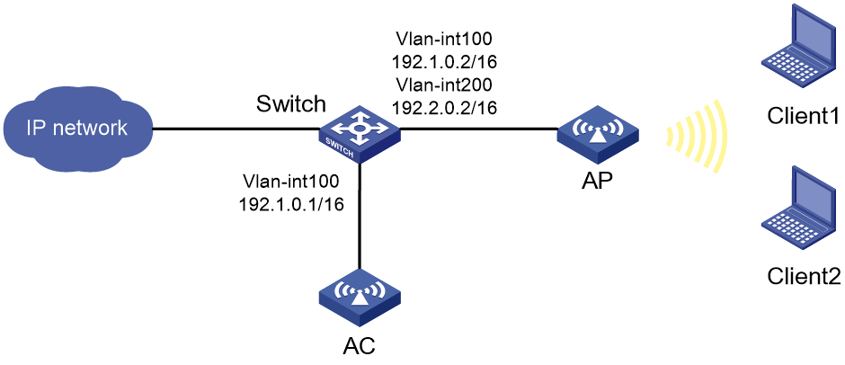

As shown in Figure 1, the AP connects to the AC through the switch, and the switch acts as a DHCP server to assign IP addresses to the AP and the clients. Configure remote AP on the AC so that the AP can still provide services for clients when the tunnel between the AP and the AC is disconnected.
Figure 1 Network diagram
