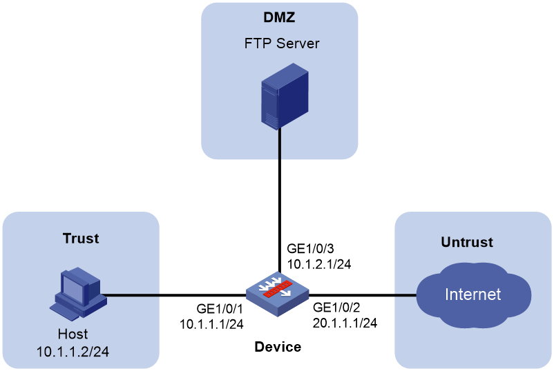

Example: Configuring packet capture
As shown in Figure 1, capture packets on GigabitEthernet 1/0/1. Set the maximum packet size for a packet capture record to 3000 bytes. Use a remote file server to save the .cap files.
1. Assign IP addresses to interfaces and configure routes, security zones, zone pairs, and interzone policies. Make sure the network connections are available. (Details not shown.)
2. Configure packet capture:
# Set the storage directory for the .cap files to ftp://ftp.remote.com/pcap/. Specify the username and password for accessing the FTP server.
[Device] packet-capture storage remote ftp://ftp.remote.com/pcap/ user zhangsan password simple 123456TESTplat&!
# Set the maximum packet size for a packet capture record to 3000 bytes.
[Device] packet-capture max-bytes 3000
# Start packet capture on GigabitEthernet 1/0/1.
[Device] packet-capture start interface gigabitethernet 1/0/1
# Display packet capture settings and status information.
[Device] display packet-capture status
Capture status: Started
Filter: Interface GigabitEthernet1/0/1
