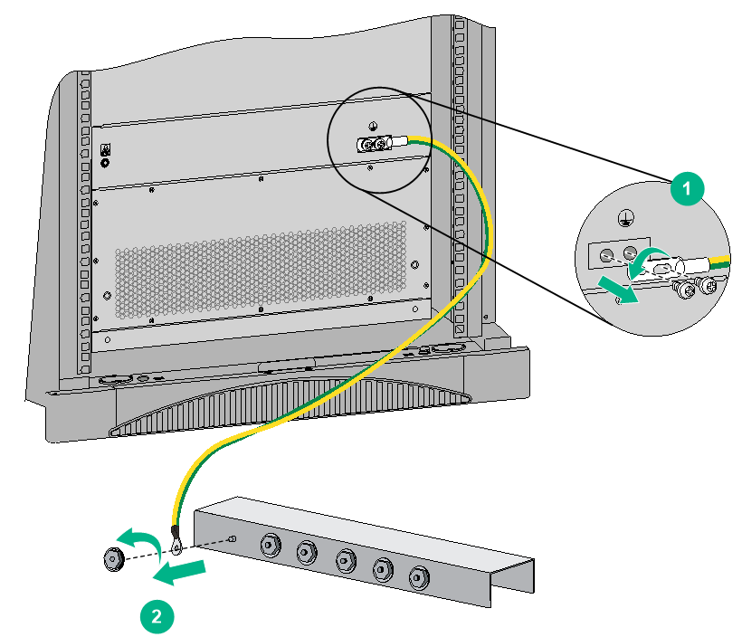

Removing the grounding cable
1. Loosen the two screws at the grounding holes of the chassis and remove the grounding cable from the chassis.
2. Use a wrench to loosen the hex nut on the grounding post of the grounding strip, and remove the other end of the grounding cable (with a ring terminal) from the grounding post.
Figure 12-1 Removing the grounding cable

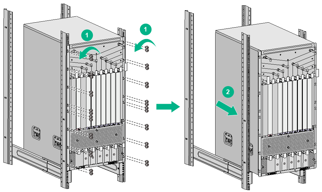

3. As shown in callout 1 in Figure 12-2, use a Phillips screwdriver to loosen the screws that attach the mounting brackets to the rack.
4. As shown in callout 2 in Figure 12-2, use at least two persons to slide the chassis outwards along the slide rails. When most part of the chassis is removed from the slide rails, lift up the chassis by holding the handles at the chassis sides to completely remove the chassis from the rack.
Figure 12-2 Removing the chassis from the rack

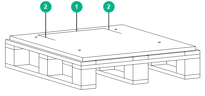

1. Align the left, right, and rear edges of the chassis bottom with the left, right, and rear positioning lines respectively on the wooden pallet base. See Figure 12-3 for the wooden pallet base.
Figure 12-3 Wooden pallet base
(1) Rear positioning line |
(2) Left and right positioning lines |

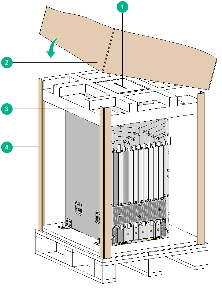

5. Cover the chassis with the packing bag from the top down, and then tape the bag to the plastic cover of pallet base.
6. Cover the foam cushion to the chassis top, and make sure the mounting brackets seat into the internal notches of the foam cushion. See Figure 12-5.
7. Put the box of packed accessories into the notch of the foam cushion that is near to the rear end of the chassis, as shown in Figure 12-5.
8. Erect one paper angle bead along each vertical edge of the chassis, and use the carton to cover the chassis from top down with the silkscreen side facing the front panel of the chassis.
9. Cover the top cap on the carton.
Figure 12-5 Covering the chassis
(1) Box of packed accessories |
(2) Carton |
(3) Foam cushion |
(4) Paper angle bead |

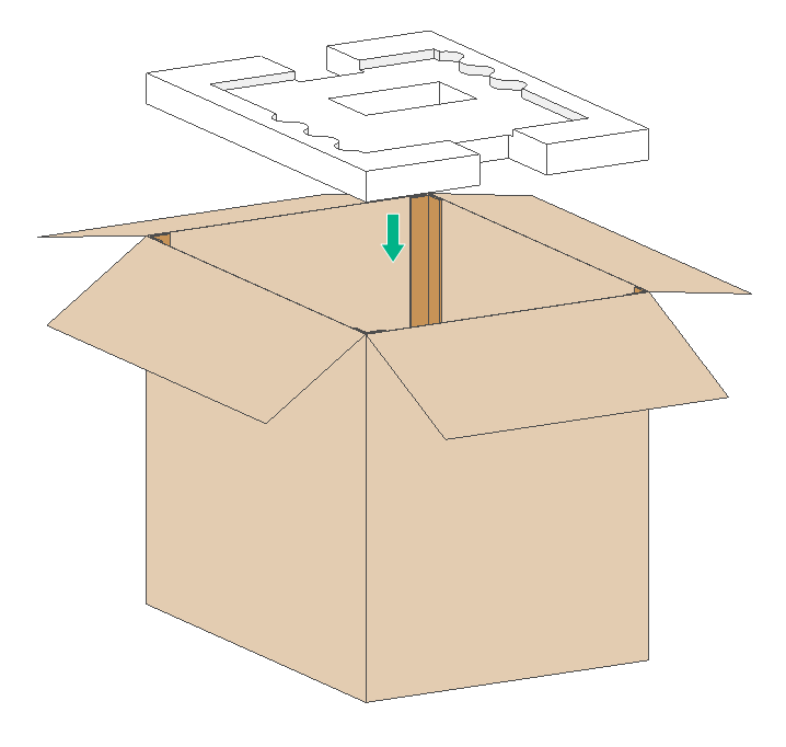

1. Place the bottom packaging foam on the carton bottom.
Figure 12-6 Putting the bottom packaging foam onto the carton bottom
