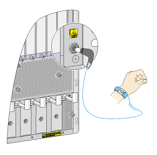

Attaching an ESD wrist strap
Every S10500X switch provides an ESD wrist strap. To minimize ESD damage to electronic components, wear the ESD wrist strap and make sure it is reliably grounded when installing modules.
To use an ESD wrist strap:
1.     Make sure the switch is reliably grounded. For how to ground your switch, see "Grounding the switch."
2.     Put on the wrist strap.
3.     Tighten the wrist strap to make sure it makes good skin contact.
Make sure the resistance reading between your body and the ground is between 1 and 10 megohms.
4.     As shown in Figure 3-1, insert the ESD wrist strap into the ESD socket (with an ESD sign) on the switch chassis, or attach it to the grounding screw of the chassis with an alligator clip.
Figure 3-1 Attaching an ESD wrist strap

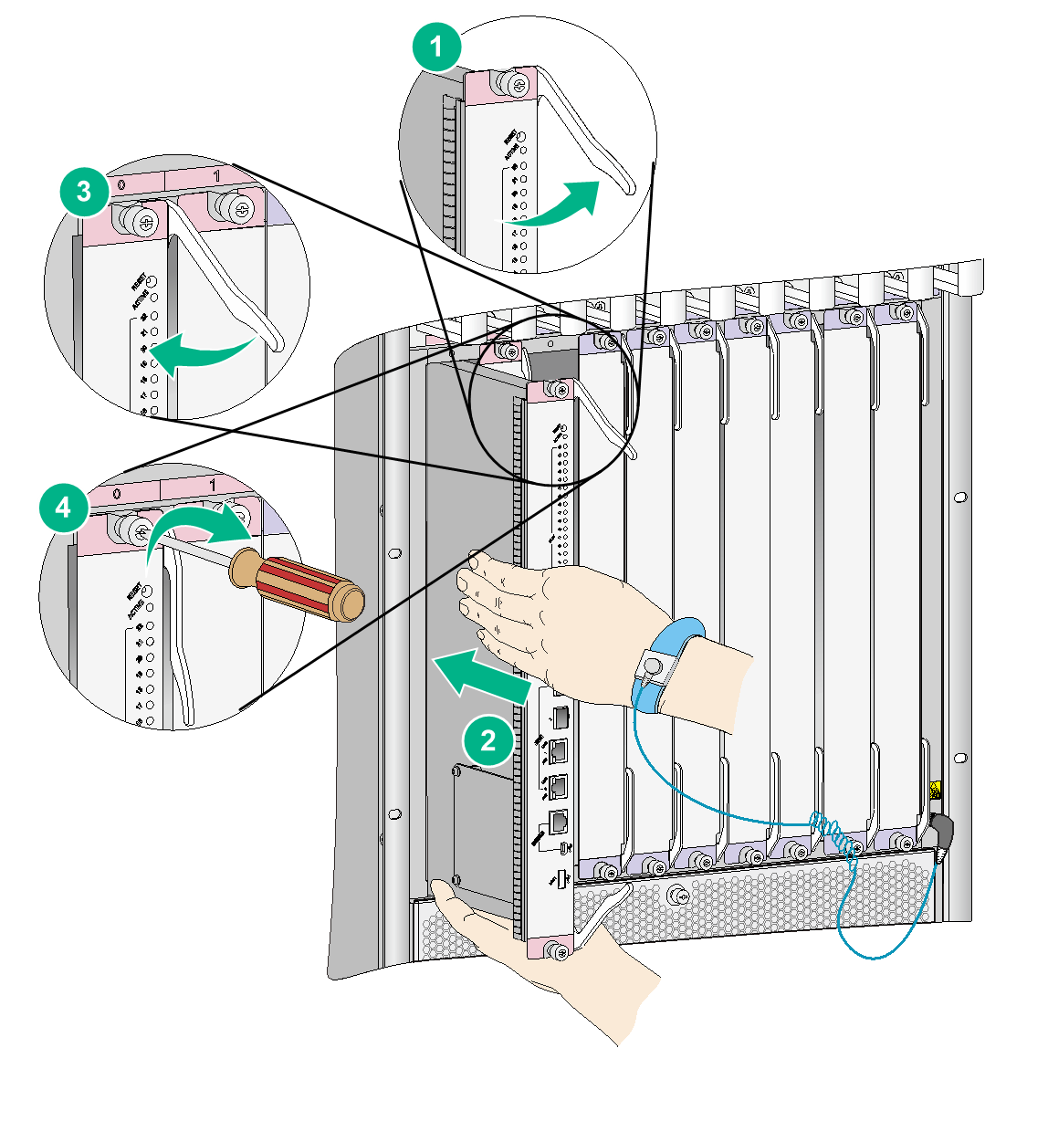

The installation procedure is similar for the cards. The following procedure installs a card in a vertical slot.
To install a card:
1.     Wear an ESD wrist strap, and make sure it makes good skin contact and is reliably grounded. For more information, see "Attaching an ESD wrist strap."
2.     Remove the filler panel (if any) from the slot. Keep the filler panel for future use.
3.     Fully open the two ejector levers on the card.
4.     Hold the card by the front panel with one hand and support the card bottom with the other. Slide the card steadily into the slot along the guide rails until you cannot push the card further. Do not touch the components on the card.
5.     Fully close the ejector levers until the card come in close contact with the backplane.
6.     Fasten the captive screws on the card.
7.     When the switch is powered on, verify the running status of the card.
You can verify the running status of a card by referring to the card status LED (SLOT) on the MPU of the switch. If the RUN LED flashes, the card in the slot operates correctly. For more information about card status LED (SLOT), see "Appendix C LEDs."
Figure 3-2 Installing a card
Some card slots are shipped with no filler panels installed. The preceding figure is for illustration only.

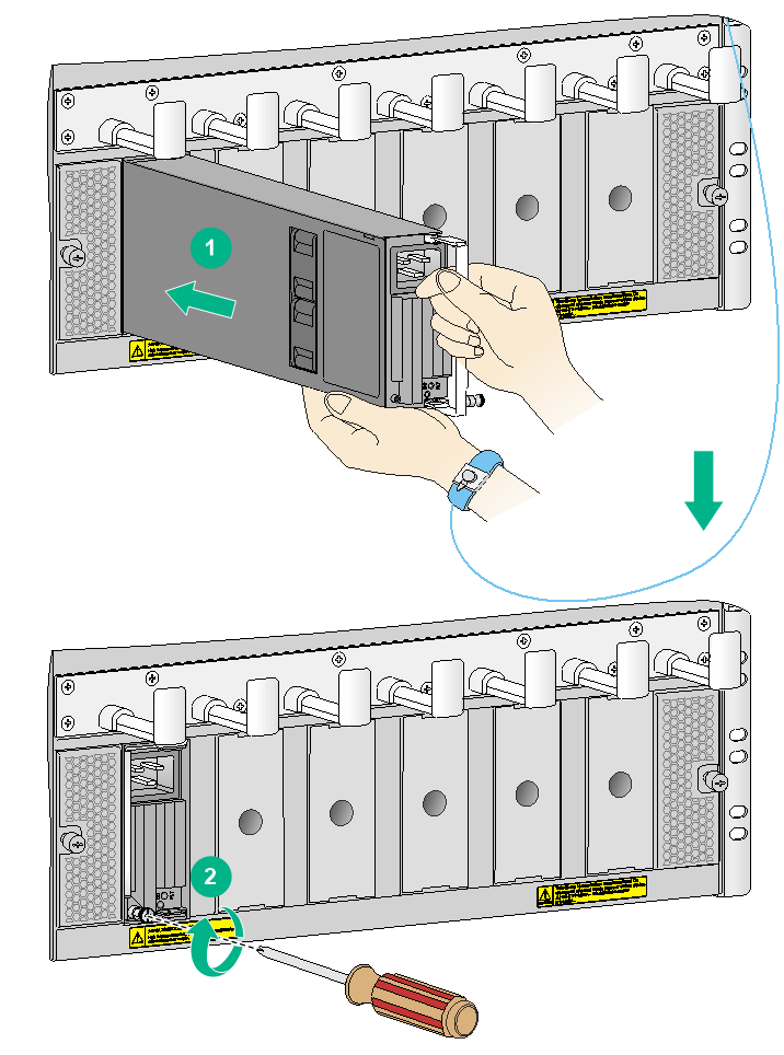

An AC power module and a DC power module are installed in the same way. This section uses an AC power module as an example. For information about AC and DC power modules, see H3C AC1200 Power Module User Manual, H3C AC2500 Power Module User Manual and H3C DC2400 Power Module User Manual.
Some power module slots are shipped with no filler panel installed. The figures in this section are for illustration only.
To install the power module:
1.     Wear an ESD wrist strap and make sure it makes good skin contact and is reliably grounded. For more information, see "Attaching an ESD wrist strap."
2.     Locate the target power module slot. Hold the two holes in the filler panel and pull the filler panel gently out of the slot along the guide rails.
3.     Unpack the power module.
4.     Grasping the handle of the module with one hand and supporting the module bottom with the other, push the power module along the guide rails into the slot until it has firm contact with the slot.
5.     Press the handle inward until the handle seats into the slot.
6.     Use a Phillips screwdriver to fasten the captive screw on the handle to attach the power module.
Figure 3-4 Installing a power module

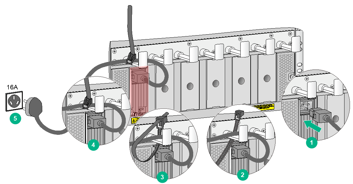

Connecting an AC power cord
CAUTION
CAUTION:
Before connecting an AC power cord, make sure the AC power source circuit breaker is switched off.
To connect an AC power cord:

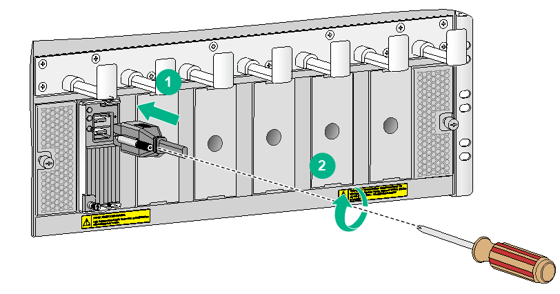

1.     Connect the female connector of the power cord to the power receptacle on the power module.
2.     As shown in Figure 3-5, use a removable cable tie to secure the power cord to the power cord management bracket.
The power cord management bracket on an S10516X switch has a cutout in each hook. You can also feed the removable cable tie through the cutout to secure the power cord.
3.     Connect the other end of the power cord to an AC power source and switch on the circuit breaker.
4.     Verify the power module input status LED.
If the LED is on, the power cord is correctly connected. For description of power module status LEDs, see "Appendix C LEDs."
Figure 3-5 Connecting an AC power cord

1.     Plug the power cord into the power receptacle on the power module.
2.     Fasten the screw to secure the power cord.
Figure 3-6 Connecting a DC power cord

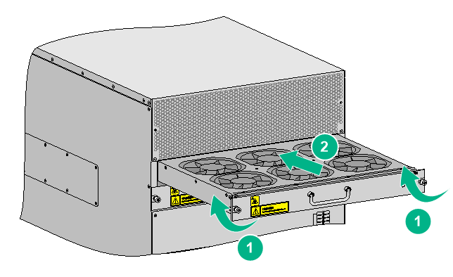

Installing fan trays
CAUTION
CAUTION:
To install fan trays in slots FAN 10 to FAN 14 on an S10516X switch, orient the fan tray with the yellow warning sign above the handle. To install fan trays in other slots on the switch, orient the fan tray with the yellow warning sign below the handle.
The S10508X-V switch provides horizontal fan tray slots. The S10506X, S10508X, and S10510X switches provide vertical fan tray slots. These switches come with a fan tray installed in slot FAN0. You can install a fan tray in slot FAN1 as required.
The S10516X switch provides vertical fan tray slots. The switch comes with a fan tray installed in each fan tray slot.
The fan tray installation procedure is similar for horizontal and vertical slots. The following procedure uses the S10508X-V switch as an example.
To install a fan tray:
2.     Unpack the fan tray.
3.     Holding the fan tray handle with one hand and supporting the fan tray bottom with the other, align the fan tray with the target slot.
4.     Push the fan tray into the slot along the guide rails. Make sure the fan tray is fully seated in the slot.
5.     Use a screwdriver to fasten the captive screws on the fan tray.
Figure 3-7 Installing a fan tray

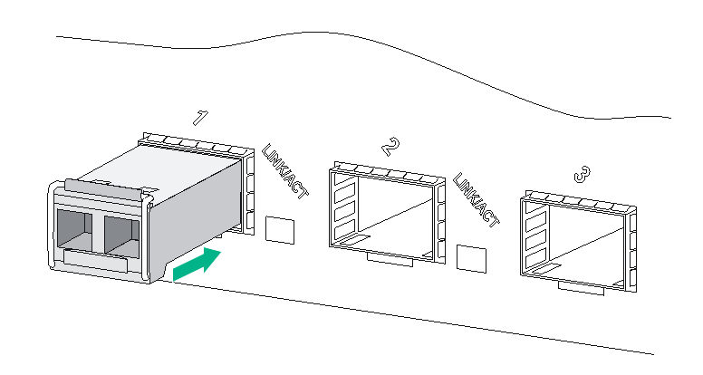

To install an SFP+ transceiver module:
2.     Remove the dust plug from the target fiber port.
3.     Unpack the SFP+ transceiver module. It comes with the bail latch catching the knob on the top of the transceiver module.
4.     Grasp the transceiver module between your thumb and index finger. Align it with the fiber port and push it gently into the port until it snaps into place.
Transceiver modules and fiber ports have disorientation rejection designs. If you cannot insert a transceiver module easily into a port, the orientation might be wrong. Remove and reorient the transceiver module.
In case of limited space, you can gently push against the front face of the transceiver module instead of the two sides.
5.     Connect optical fibers to the transceiver module. For the connection procedure, see "Connecting your switch to the network through optical fibers."
Figure 3-8 Installing an SFP+ transceiver module

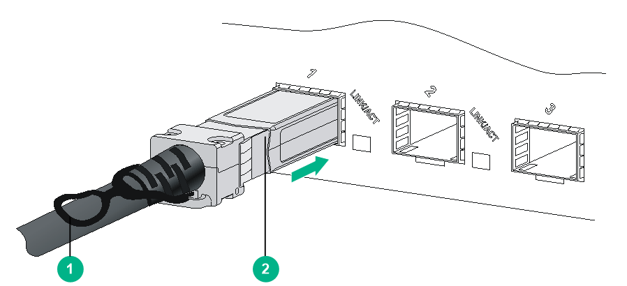

The network cables are hot swappable. The connection procedure is similar for these cables. The following procedure connects an SFP+ DAC cable.
To connect an SFP+ DAC cable:
3.     Unpack the cable.
4.     As shown in Figure 3-9, align the module end of the cable with the fiber port and push it gently into the port until you feel it snaps into place.
Transceiver modules and fiber ports have disorientation rejection structures. If you cannot insert a transceiver module easily into a port, remove and reorient the transceiver module.
Figure 3-9 Connecting an SFP+ DAC cable
(1) Pull latch
(2) Connector
