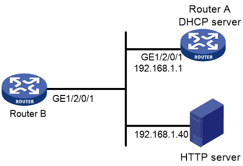

As shown in Figure 1, server-based automatic configuration requires the following servers:
·     DHCP server.
·     File server (TFTP or HTTP server).
·     (Optional.) DNS server.
Figure 1 Server-based automatic configuration network diagram

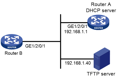

Example: Using a TFTP server for automatic configuration
As shown in Figure 2, Router B does not have a configuration file.
Configure the servers so Router B can obtain a configuration file to complete the following configuration tasks:
·     Enable the administrator to Telnet to Router B to manage Router B.
·     Require the administrator to enter the correct username and password at login.
Figure 2 Network diagram
1.     Configure the DHCP server:
# Enable DHCP.
<RouterA> system-view
[RouterA] dhcp enable
# Configure IP pool 1 to assign IP addresses on the 192.168.1.0/24 subnet to clients. Specify the TFTP server and configuration file name for the clients.
[RouterA] ip pool 1
[RouterA-ip-pool-1] network 192.168.1.0 24
[RouterA-ip-pool-1] tftp-server ip-address 192.168.1.40
[RouterA-ip-pool-1] bootfile-name device.cfg
[RouterA-ip-pool-1] quit
2.     Configure the TFTP server:
# On the TFTP server, create a configuration file named device.cfg.

Example: Using an HTTP server and Tcl scripts for automatic configuration
As shown in Figure 3, Router B does not have a configuration file.
Configure the servers so Router B can obtain a Tcl script to complete the following configuration tasks:
Figure 3 Network diagram

Example: Using an HTTP server and Python scripts for automatic configuration
As shown in Figure 4, Router B does not have a configuration file.
Configure the servers so Router B can obtain a Python script to complete the following configuration tasks:
Figure 4 Network diagram
