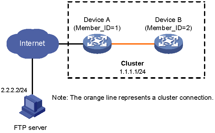

As shown in Figure 1, the cluster has two members. Each member has one active MPU (slot 0) and one standby MPU (slot 1).
Upgrade the boot, system, and feature images from T0001015 to T0001016. The two versions are compatible.
Figure 1 Network diagram
# Download the upgrade image files from the TFTP server.

Upgrade the boot, system, and feature images from T0001015 to T0001017. The two versions are incompatible.
Figure 2 Network diagram

Example: Rolling back the system software
As shown in Figure 3, the cluster has two members. Each member has one MPU in slot 0 (active MPU) and one MPU in slot 1 (standby MPU).
Roll back the boot, system, and feature images from T0001016 to T0001015 after upgrading them from T0001015 to T0001016. T0001016 and T0001015 are compatible.
Figure 3 Network diagram

Examples of using install commands for ISSU
Example: Upgrading the system software
As shown in Figure 4, the cluster has two members. Each member has one MPU in slot 0 (active MPU) and one MPU in slot 1 (standby MPU).
Upgrade the Feature1 feature image from T0001015 to T0001016. The two versions are compatible.
Figure 4 Network diagram
# Download the .ipe file that contains the T0001016 Feature1 feature image from the TFTP server.

Example: Rolling back a feature
The Feature1 feature has been upgraded from T0001015 to T0001016. However, the software change has not been committed.
Roll back the Feature1 feature from T0001016 to T0001015.
