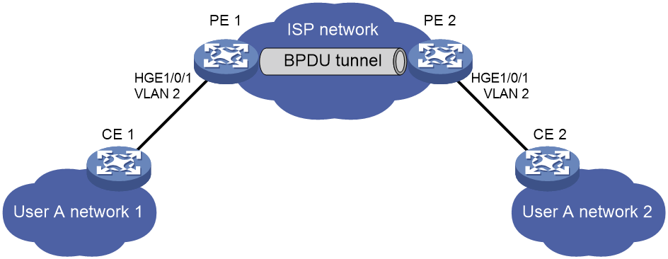

Layer 2 Protocol Tunneling (L2PT) can transparently send Layer 2 protocol packets from geographically dispersed customer networks across a service provider network or drop them.
L2PT application scenario
Dedicated lines are used in a service provider network to build user-specific Layer 2 networks. As a result, a customer network contains sites located at different sides of the service provider network.
As shown in Figure 1, Customer A's network is divided into network 1 and network 2, which are connected by the service provider network. For Customer A's network to implement Layer 2 protocol calculations, the Layer 2 protocol packets must be transmitted across the service provider network.
Upon receiving a Layer 2 protocol packet, the PEs cannot determine whether the packet is from the customer network or the service provider network. They must deliver the packet to the CPU for processing. In this case, the Layer 2 protocol calculation in Customer A's network is mixed with the Layer 2 protocol calculation in the service provider network. Neither the customer network nor the service provider network can implement independent Layer 2 protocol calculations.
Figure 1 L2PT application scenario
L2PT is introduced to resolve the problem. L2PT provides the following functions:
·     Multicasts Layer 2 protocol packets from a customer network in a VLAN. Dispersed customer networks can complete an independent Layer 2 protocol calculation, which is transparent to the service provider network.
·     Isolates Layer 2 protocol packets from different customer networks through different VLANs.

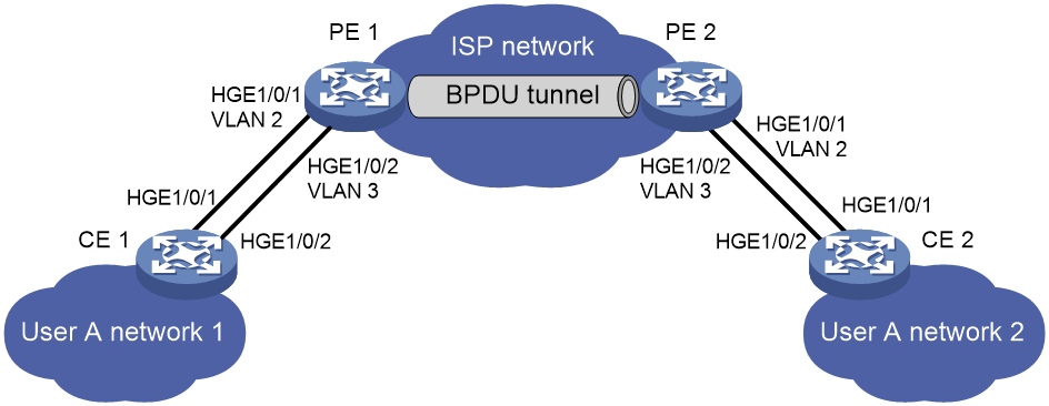

L2PT operating mechanism
As shown in Figure 2, L2PT operates as follows:
·     When a port of PE 1 receives a Layer 2 protocol packet from the customer network in a VLAN, it performs the following operations:
¡     Multicasts the packet out of all customer-facing ports in the VLAN except the receiving port.
¡     Encapsulates the packet with a specified destination multicast address, and multicasts it out of all ISP-facing ports in the VLAN. The encapsulated packet is called the BPDU tunneled packet.
·     When a port of PE 2 in the VLAN receives the tunneled packet from the service provider network, it performs the following operations:
¡     Multicasts the packet out of all ISP-facing ports in the VLAN except the receiving port.
¡     Decapsulates the packet and multicasts the decapsulated packet out of all customer-facing ports in the VLAN.
Figure 2 L2PT operating mechanism
For example, as shown in Figure 3, PE 1 receives an STP packet (BPDU) from network 1 to network 2. CEs are the edge devices on the customer network, and PEs are the edge devices on the service provider network. L2PT processes the packet as follows:
1.     PE 1 performs the following operations:
a.     Encapsulates the packet with a specified destination multicast MAC address (010f-e200-0003 by default).
b.     Sends the tunneled packet out of all ISP-facing ports in the packet's VLAN.
2.     Upon receiving the tunneled packet, PE 2 decapsulates the packet and sends the BPDU to CE 2.
Through L2PT, both the ISP network and Customer A's network can perform independent spanning tree calculations.
Figure 3 L2PT network diagram
