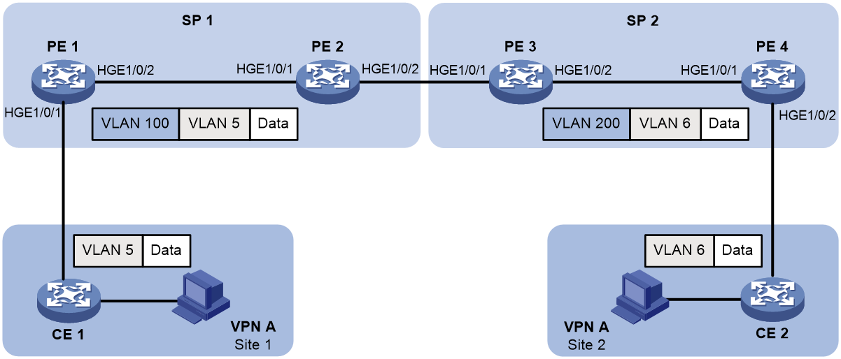

One-to-two and two-to-two VLAN mapping
One-to-two and two-to-two VLAN mapping are typically used to implement communication across different SP networks, as shown in Figure 2.
Figure 2 Application scenario of one-to-two and two-to-two VLAN mapping
As shown in Figure 2, Site 1 and Site 2 of VPN A are in VLAN 2 and VLAN 3, respectively. The SP 1 network assigns SVLAN 10 to Site 1. The SP 2 network assigns SVLAN 20 to Site 2. When the packet from Site 1 arrives at PE 1, PE 1 tags the packet with SVLAN 10 by using one-to-two VLAN mapping.
When the double-tagged packet from the SP 1 network arrives at the SP 2 network interface, PE 3 processes the packet as follows:
·     Replaces SVLAN tag 10 with SVLAN tag 20.
·     Replaces CVLAN tag 2 with CVLAN tag 3.

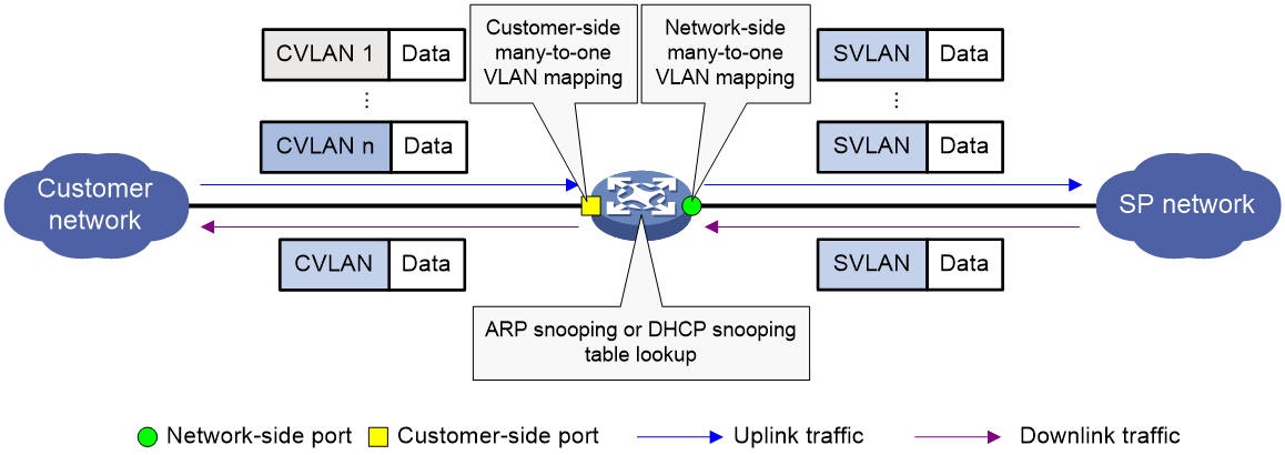

Many-to-one VLAN mapping
As shown in Figure 5, many-to-one VLAN mapping is implemented on both the customer-side and network-side ports as follows:
·     For the uplink traffic, the customer-side many-to-one VLAN mapping replaces multiple CVLANs with the same SVLAN.
·     For the downlink traffic, the network-side many-to-one VLAN mapping replaces the SVLAN with the CVLAN found in the DHCP snooping table or ARP snooping table. For more information about DHCP snooping and ARP snooping, see Layer 3—IP Services Configuration Guide.

Configure one-to-two VLAN mapping on PE 1 and PE 4, as shown in Figure 2, through which traffic from customer networks enters the service provider networks.
·     Configuring two-to-two VLAN mapping
Configure two-to-two VLAN mapping on PE 3, as shown in Figure 2, which is an edge device of the SP 2 network.

Configuring many-to-one VLAN mapping
About many-to-one VLAN mapping
Configure many-to-one VLAN mapping on campus switches (see Figure 1) to transmit the same type of traffic from different users in one VLAN.

·     Make sure hosts in different CVLANs do not use the same IP address.
·     When an IP address is no longer associated with the MAC address and VLAN in an ARP snooping entry, wait for this entry to be aged out. You can also use the reset arp snooping ip ip-address command to clear the entry.
·     Before you modify many-to-one VLAN mapping, use the reset arp snooping vlan vlan-id command to clear the ARP snooping entries in each CVLAN.
·     To ensure correct traffic forwarding from the service provider network to the customer network, do not configure many-to-one VLAN mapping together with uRPF. For more information about uRPF, see Security Configuration Guide.
Many-to-one VLAN mapping in static IP address assignment environment tasks at a glance
To configure many-to-one VLAN mapping in static IP address assignment environment, perform the following tasks:
1.     Enabling ARP snooping
2.     Configuring the customer-side port
3.     Configuring the network-side port
2.     Enter VLAN view.
vlan vlan-id
3.     Enable ARP snooping.
arp snooping enable
By default, ARP snooping is disabled.
You must enable ARP snooping for the original VLANs and the translated VLANs.
2.     Enter interface view.
¡     Enter Layer 2 Ethernet interface view.
¡     Enter Layer 2 aggregate interface view.
3.     Set the link type of the port.
port link-type { hybrid | trunk }
By default, the link type of a port is access.
4.     Assign the port to the original VLANs and the translated VLAN.
¡     Assign the trunk port to the original VLANs and the translated VLAN.
port trunk permit vlan vlan-id-list
By default, a trunk port is assigned to VLAN 1.
¡     Assign the hybrid port to the original VLANs and the translated VLAN as a tagged member.
port hybrid vlan vlan-id-list tagged
By default, a hybrid port is an untagged member of the VLAN to which the port belongs when its link type is access.
5.     Configure a many-to-one VLAN mapping.
vlan mapping uni { range vlan-range-list | single vlan-id-list } translated-vlan vlan-id
By default, no VLAN mapping is configured on an interface.
4.     Assign the port to the translated VLAN.
¡     Assign the trunk port to the translated VLAN.
¡     Assign the hybrid port to the translated VLAN as a tagged member.
5.     Configure the port to use the original VLAN tags of the many-to-one mapping to replace the VLAN tags of the packets destined for the user network.
vlan mapping nni
By default, the port does not replace the VLAN tags of the packets destined for the user network.

Example: Configuring one-to-two and two-to-two VLAN mapping
As shown in Figure 9:
·     Two VPN A branches, Site 1 and Site 2, are in VLAN 5 and VLAN 6, respectively.
·     The two sites use different VPN access services from different service providers, SP 1 and SP 2.
·     SP 1 assigns VLAN 100 to Site 1 and Site 2. SP 2 assigns VLAN 200 to Site 1 and Site 2.
Configure one-to-two VLAN mappings and two-to-two VLAN mappings to enable the two branches to communicate across networks SP 1 and SP 2.
Figure 9 Network diagram
1.     Configure PE 1:
# Create VLANs 5 and 100.
<PE1> system-view
[PE1] vlan 5
[PE1-vlan5] quit
[PE1] vlan 100
[PE1-vlan100] quit
# Configure a one-to-two VLAN mapping on the customer-side port (HundredGigE 1/0/1) to add SVLAN tag 100 to packets from VLAN 5.
[PE1] interface hundredgige 1/0/1
[PE1-HundredGigE1/0/1] vlan mapping nest single 5 nested-vlan 100
# Configure HundredGigE 1/0/1 as a hybrid port.
[PE1-HundredGigE1/0/1] port link-type hybrid
# Assign HundredGigE 1/0/1 to VLAN 100 as an untagged member.
[PE1-HundredGigE1/0/1] port hybrid vlan 100 untagged
[PE1-HundredGigE1/0/1] quit
# Configure the network-side port (HundredGigE 1/0/2) as a trunk port.
[PE1] interface hundredgige 1/0/2
[PE1-HundredGigE1/0/2] port link-type trunk
# Assign HundredGigE 1/0/2 to VLAN 100.
[PE1-HundredGigE1/0/2] port trunk permit vlan 100
[PE1-HundredGigE1/0/2] quit
2.     Configure PE 2:
# Create VLAN 100.
<PE2> system-view
[PE2] vlan 100
[PE2-vlan100] quit
# Configure HundredGigE 1/0/1 as a trunk port.
[PE2] interface hundredgige 1/0/1
[PE2-HundredGigE1/0/1] port link-type trunk
# Assign HundredGigE 1/0/1 to VLAN 100.
[PE2-HundredGigE1/0/1] port trunk permit vlan 100
[PE2-HundredGigE1/0/1] quit
# Configure HundredGigE 1/0/2 as a trunk port.
[PE2] interface hundredgige 1/0/2
[PE2-HundredGigE1/0/2] port link-type trunk
[PE2-HundredGigE1/0/2] port trunk permit vlan 100
[PE2-HundredGigE1/0/2] quit
3.     Configure PE 3:
# Create VLANs 5, 6, 100, and 200.
<PE3> system-view
[PE3] vlan 5 to 6
[PE3] vlan 100
[PE3-vlan100] quit
[PE3] vlan 200
[PE3-vlan200] quit
[PE3] interface hundredgige 1/0/1
[PE3-HundredGigE1/0/1] port link-type trunk
# Assign HundredGigE 1/0/1 to VLANs 100 and 200.
[PE3-HundredGigE1/0/1] port trunk permit vlan 100 200
# Configure a two-to-two VLAN mapping on HundredGigE 1/0/1 to map SVLAN 100 and CVLAN 5 to SVLAN 200 and CVLAN 6.
[PE3-HundredGigE1/0/1] vlan mapping tunnel 100 5 translated-vlan 200 6
[PE3-HundredGigE1/0/1] quit
[PE3] interface hundredgige 1/0/2
[PE3-HundredGigE1/0/2] port link-type trunk
# Assign HundredGigE 1/0/2 to VLAN 200.
[PE3-HundredGigE1/0/2] port trunk permit vlan 200
[PE3-HundredGigE1/0/2] quit
4.     Configure PE 4:
# Create VLANs 6 and 200.
<PE4> system-view
[PE4] vlan 6
[PE4-vlan6] quit
[PE4] vlan 200
[PE4-vlan200] quit
# Configure the network-side port (HundredGigE 1/0/1) as a trunk port.
[PE4] interface hundredgige 1/0/1
[PE4-HundredGigE1/0/1] port link-type trunk
# Assign HundredGigE 1/0/1 to VLAN 200.
[PE4-HundredGigE1/0/1] port trunk permit vlan 200
[PE4-HundredGigE1/0/1] quit
# Configure the customer-side port (HundredGigE 1/0/2) as a hybrid port.
[PE4] interface hundredgige 1/0/2
[PE4-HundredGigE1/0/2] port link-type hybrid
# Assign HundredGigE 1/0/2 to VLAN 200 as an untagged member.
[PE4-HundredGigE1/0/2] port hybrid vlan 200 untagged
# Configure a one-to-two VLAN mapping on HundredGigE 1/0/2 to add SVLAN tag 200 to packets from VLAN 6.
[PE4-HundredGigE1/0/2] vlan mapping nest single 6 nested-vlan 200
[PE4-HundredGigE1/0/2] quit
# Verify VLAN mapping information on PE 1.
[PE1] display vlan mapping
Interface HundredGigE1/0/1:
  Outer VLAN    Inner VLAN    Translated Outer VLAN    Translated Inner VLAN
  5             N/A           100                      5
# Verify VLAN mapping information on PE 3.
[PE3] display vlan mapping
  100           5             200                      6
# Verify VLAN mapping information on PE 4.
[PE4] display vlan mapping
Interface HundredGigE1/0/2:
  6             N/A           200                      6
