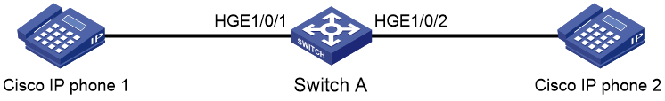

Example: Configuring CDP-compatible LLDP
As shown in Figure 6, HundredGigE 1/0/1 and HundredGigE 1/0/2 of Switch A are each connected to a Cisco IP phone, which sends tagged voice traffic.
Configure voice VLAN 2 on Switch A. Enable CDP compatibility of LLDP on Switch A to allow the Cisco IP phones to automatically configure the voice VLAN. The voice VLAN feature performs the following operations:
·     Confines the voice traffic to the voice VLAN.
·     Isolates the voice traffic from other types of traffic.
Figure 6 Network diagram
1.     Configure a voice VLAN on Switch A:
# Create VLAN 2.
<SwitchA> system-view
[SwitchA] vlan 2
[SwitchA-vlan2] quit
# Set the link type of HundredGigE 1/0/1 and HundredGigE 1/0/2 to trunk, and enable voice VLAN on them.
[SwitchA] interface hundredgige 1/0/1
[SwitchA-HundredGigE1/0/1] port link-type trunk
[SwitchA-HundredGigE1/0/1] voice-vlan 2 enable
[SwitchA-HundredGigE1/0/1] quit
[SwitchA] interface hundredgige 1/0/2
[SwitchA-HundredGigE1/0/2] port link-type trunk
[SwitchA-HundredGigE1/0/2] voice-vlan 2 enable
[SwitchA-HundredGigE1/0/2] quit
2.     Configure CDP-compatible LLDP on Switch A:
# Enable LLDP globally, and enable CDP compatibility globally.
[SwitchA] lldp global enable
[SwitchA] lldp compliance cdp
# Enable LLDP on HundredGigE 1/0/1. By default, LLDP is enabled on ports.
[SwitchA-HundredGigE1/0/1] lldp enable
# Configure LLDP to operate in TxRx mode on HundredGigE 1/0/1.
[SwitchA-HundredGigE1/0/1] lldp admin-status txrx
# Configure CDP-compatible LLDP to operate in TxRx mode on HundredGigE 1/0/1.
[SwitchA-HundredGigE1/0/1] lldp compliance admin-status cdp txrx
# Enable LLDP on HundredGigE 1/0/2. By default, LLDP is enabled on ports.
[SwitchA-HundredGigE1/0/2] lldp enable
# Configure LLDP to operate in TxRx mode on HundredGigE 1/0/2.
[SwitchA-HundredGigE1/0/2] lldp admin-status txrx
# Configure CDP-compatible LLDP to operate in TxRx mode on HundredGigE 1/0/2.
[SwitchA-HundredGigE1/0/2] lldp compliance admin-status cdp txrx
# Verify that Switch A has completed the following operations:
·     Discovering the IP phones connected to HundredGigE 1/0/1 and HundredGigE 1/0/2.
·     Obtaining IP phone information.
[SwitchA] display lldp neighbor-information
CDP neighbor-information of port 1[HundredGigE1/0/1]:
LLDP agent nearest-bridge:
 CDP neighbor index  : 1
 Chassis ID          : SEP00141CBCDBFE
 Port ID             : Port 1
CDP neighbor-information of port 2[HundredGigE1/0/2]:
 CDP neighbor index  : 2
 Chassis ID          : SEP00141CBCDBFF
 Port ID             : Port 1

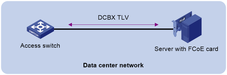

DCBX application scenario
Figure 7 DCBX application scenario
DCBX enables lossless packet transmission on DCE networks.
As shown in Figure 7, DCBX applies to an FCoE-based data center network, and operates on an access switch. DCBX enables the switch to control the server or storage adapter, and simplifies the configuration and guarantees configuration consistency. DCBX extends LLDP by using the IEEE 802.1 organizationally specific TLVs (DCBX TLVs) to transmit DCBX data, including:
·     In DCBX Rev 1.00 and DCBX Rev 1.01:
¡     Application Protocol (APP).
¡     Enhanced Transmission Selection (ETS).
¡     Priority-based Flow Control (PFC).
·     In IEEE Std 802.1Qaz-2011:
¡     ETS Configuration.
¡     ETS Recommendation.
¡     PFC.
¡     APP.
H3C devices can send these types of DCBX information to a server or storage adapter supporting FCoE. However, H3C devices cannot accept these types of DCBX information.

As shown in Figure 8, HundredGigE 1/0/1 of the access switch (Switch A) connects to the FCoE adapter of the data center server (DC server).
Configure Switch A to implement lossless FCoE and FIP frame transmission to DC server.
In this example, both Switch A and the DC server support DCBX Rev 1.01.
Figure 8 Network diagram

The output shows that the DC server will use SP queuing (priority group ID 15) for 802.1p priority 3.

The output shows that the DC server will use PFC for 802.1p priority 3.
