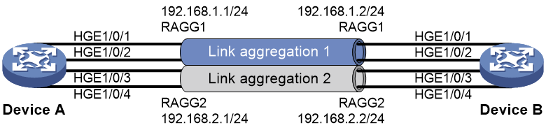

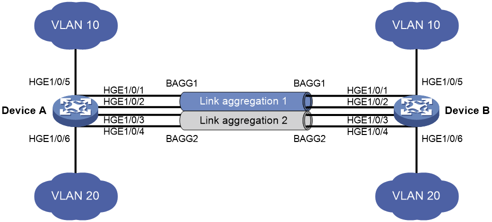

Ethernet link aggregation application scenario
As shown in Figure 1, Device A and Device B are connected by three physical Ethernet links. These physical Ethernet links are combined into an aggregate link called link aggregation 1. The bandwidth of this aggregate link can reach up to the total bandwidth of the three physical Ethernet links. At the same time, the three Ethernet links back up one another. When a physical Ethernet link fails, the traffic transmitted on the failed link is switched to the other two links.
Figure 1 Ethernet link aggregation diagram

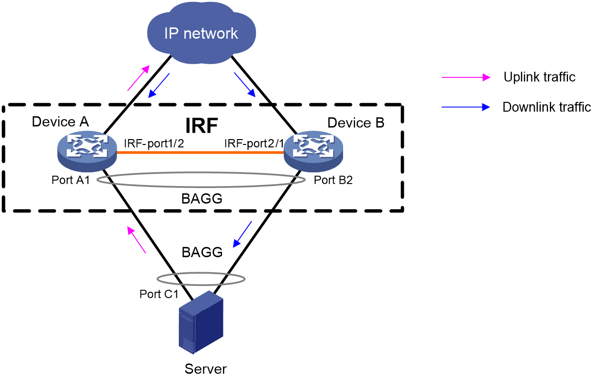

S-MLAG
Simple multichassis link aggregation (S-MLAG) enhances dynamic link aggregation to establish an aggregation that spans multiple devices to a remote device.
An S-MLAG multichassis aggregation connects one dynamic Layer 2 aggregate interface on each S-MLAG device to the remote device, as shown in Figure 5.
S-MLAG uses an S-MLAG group to manage the aggregate interfaces for each aggregation, and it runs LACP to maintain each aggregation as does dynamic link aggregation. To the remote device, the S-MLAG devices appear as one peer aggregation system.
Figure 5 S-MLAG application scenario

Configuring S-MLAG
S-MLAG is intended for a non-IRF environment. Do not configure it on an IRF fabric. For more formation about IRF, see Virtual Technologies Configuration Guide.
Each S-MLAG group can contain only one aggregate interface on each device.
The aggregate interfaces in an S-MLAG group cannot be used as DR interfaces or IPPs in DRNI. For more information about DR interfaces and IPPs, see DRNI configuration in Layer 2—LAN Switching Configuration Guide.
Do not configure the following settings on S-MLAG devices:
·     LACP MAD.
·     Link-aggregation traffic redirection.
·     Maximum or minimum number of Selected ports.
·     Automatic member port assignment.
·     Spanning tree.
As a best practice, maintain consistency across S-MLAG devices in service feature configuration.
Configure the link aggregation settings other than S-MLAG settings on each S-MLAG device. Make sure the settings are consistent across the S-MLAG devices.
2.     Set the LACP system MAC address.
lacp system-mac mac-address
By default, the LACP system MAC address is the bridge MAC address of the device.
All S-MLAG devices must use the same LACP system MAC address.
3.     Set the LACP system priority.
lacp system-priority priority
By default, the LACP system priority is 32768.
All S-MLAG devices must use the same LACP system priority.
4.     Set the LACP system number.
lacp system-number number
By default, the LACP system number is not set.
You must assign a unique LACP system number to each S-MLAG device.
5.     Enter Layer 2 aggregate interface view.
6.     Set the link aggregation mode to dynamic.
link-aggregation mode dynamic
By default, an aggregation group operates in static mode.
7.     Assign the aggregate interface to an S-MLAG group.
port s-mlag group group-id
By default, an aggregate interface is not assigned to any S-MLAG group.

Enabling local-first load sharing for link aggregation
About local-first load sharing for link aggregation
Use local-first load sharing in a multidevice link aggregation scenario to distribute traffic preferentially across member ports on the ingress slot.
When you aggregate ports on different member devices in an IRF fabric, you can use local-first load sharing to reduce traffic on IRF links, as shown in Figure 6. For more information about IRF, see Virtual Technologies Configuration Guide.
Figure 6 Load sharing for multidevice link aggregation in an IRF fabric
Enabling local-first load sharing for link aggregation globally
2.     Enable local-first load sharing for link aggregation globally.
link-aggregation load-sharing mode local-first
By default, local-first load sharing is enabled globally.

Example: Configuring a Layer 2 static aggregation group
On the network shown in Figure 8, perform the following tasks:
·     Configure a Layer 2 static aggregation group on both Device A and Device B.
·     Enable VLAN 10 at one end of the aggregate link to communicate with VLAN 10 at the other end.
·     Enable VLAN 20 at one end of the aggregate link to communicate with VLAN 20 at the other end.
Figure 8 Network diagram
1.     Configure Device A:
# Create VLAN 10, and assign port HundredGigE 1/0/4 to VLAN 10.

Example: Configuring Layer 2 aggregation load sharing
On the network shown in Figure 10, perform the following tasks:
·     Configure Layer 2 static aggregation groups 1 and 2 on Device A and Device B, respectively.
·     Configure link aggregation groups 1 and 2 to load share traffic across aggregation group member ports.
¡     Configure link aggregation group 1 to load share packets based on source MAC addresses.
¡     Configure link aggregation group 2 to load share packets based on destination MAC addresses.
Figure 10 Network diagram

Example: Configuring a Layer 2 edge aggregate interface
As shown in Figure 11, a Layer 2 dynamic aggregation group is configured on the device. The server is not configured with dynamic link aggregation.
Configure an edge aggregate interface so that both HundredGigE 1/0/1 and HundredGigE 1/0/2 can forward traffic to improve link reliability.
Figure 11 Network diagram
