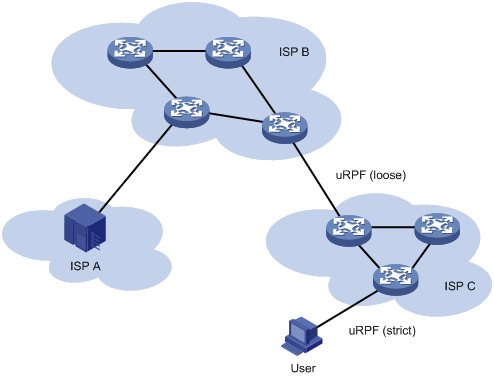

Network application
As shown in Figure 2, strict uRPF check is configured between an ISP network and a customer network. Loose uRPF check is configured between ISPs.

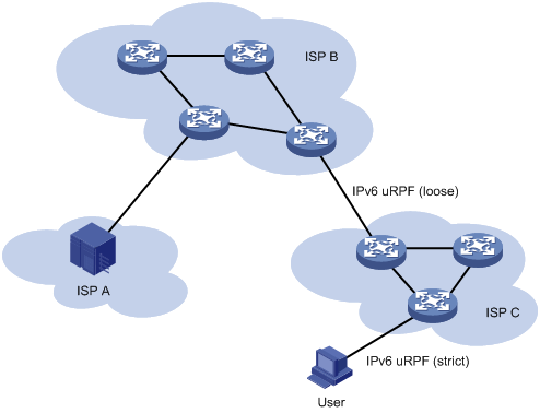

Network application
As shown in Figure 4, strict IPv6 uRPF check is configured between an ISP network and a customer network. Loose IPv6 uRPF check is configured between ISPs.
