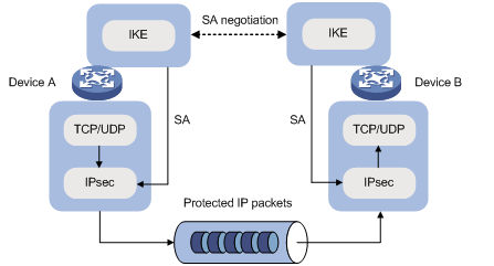

An SA is uniquely identified by a triplet, which consists of the security parameter index (SPI), destination IP address, and security protocol identifier. An SPI is a 32-bit number. It is transmitted in the AH/ESP header.
An SA can be set up manually or through IKE.
·           Manual mode—Configure all parameters for the SA through commands. This configuration mode is complex and does not support some advanced features (such as periodic key update), but it can implement IPsec without IKE. This mode is mainly used in small and static networks or when the number of IPsec peers in the network is small.
·           IKE negotiation mode—The peers negotiate and maintain the SA through IKE. This configuration mode is simple and has good expansibility. As a best practice, set up SAs through IKE negotiations in medium- and large-scale dynamic networks.
A manually configured SA never ages out. An IKE-created SA has a lifetime, which comes in two types:

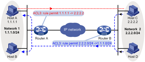

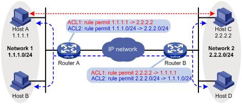

Mirror image ACLs
To make sure SAs can be set up and the traffic protected by IPsec can be processed correctly between two IPsec peers, create mirror image ACLs on the IPsec peers. As shown in Figure 4, ACL rules on Router B are mirror images of the rules on Router A. In this way, SAs can be created successfully for the traffic between Host A and Host C and for the traffic between Network 1 and Network 2.
Figure 4 Mirror image ACLs
If the ACL rules on IPsec peers do not form mirror images of each other, SAs can be set up only when both of the following requirements are met:
·           The range specified by an ACL rule on one peer is covered by its counterpart ACL rule on the other peer. As shown in Figure 5, the range specified by the ACL rule configured on Router A is covered by its counterpart on Router B.
·           The peer with the narrower rule initiates SA negotiation. If a wider ACL rule is used by the SA initiator, the negotiation request might be rejected because the matching traffic is beyond the scope of the responder. As shown in Figure 5, the SA negotiation initiated by Host A to Host C is accepted but the SA negotiations from Host C to Host A, from Host C to Host B, and from Host D to Host A are rejected.
Figure 5 Non-mirror image ACLs

Relationship between IPsec and IKE
As shown in Figure 10, IKE negotiates SAs for IPsec and transfers the SAs to IPsec, and IPsec uses the SAs to protect IP packets.
Figure 10 Relationship between IKE and IPsec

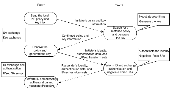

IKE negotiation process
IKE negotiates keys and SAs for IPsec in two phases:
1.      Phase 1—The two peers establish an IKE SA, a secure, authenticated channel for communication.
2.      Phase 2—Using the IKE SA established in phase 1, the two peers negotiate to establish IPsec SAs.
Phase 1 negotiation can use either main mode or aggressive mode.

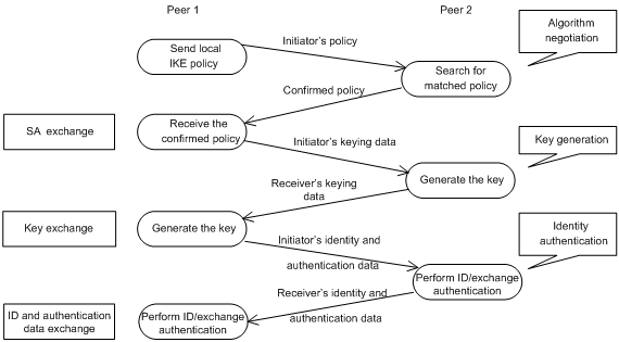

IKE exchange process in main mode
As shown in Figure 11, the main mode of IKE negotiation in phase 1 involves three pairs of messages:
·           SA exchange—Used for negotiating the IKE security policy.
·           Key exchange—Used for exchanging the DH public value and other values, such as the random number. The two peers use the exchanged data to generate key data and use the encryption key and authentication key to ensure the security of IP packets.
·           ID and authentication data exchange—Used for identity authentication.
Figure 11 IKE exchange process in main mode

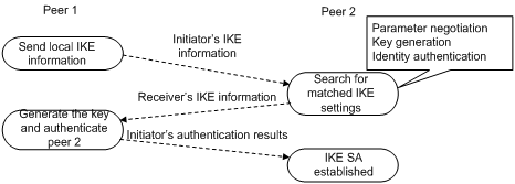

IKE exchange process in aggressive mode
As shown in Figure 12, the process of phase 1 IKE negotiation in aggressive mode is as follows:
1.      The initiator (peer 1) sends a message containing the local IKE information to peer 2. The message includes parameters used for IKE SA establishment, keying data, and peer 1's identity information.
2.      Peer 2 chooses the IKE establishment parameters to use, generate the key, and authenticate peer 1's identity. Then it sends the IKE data to peer 1.
3.      Peer 1 generates the key, authenticates peer 2's identity, and sends the results to peer 1.
After the preceding process, an IKE SA is established between peer 1 and peer 2.
The aggressive mode is faster than the main mode but it does not provide identity information protection. The main mode provides identity information protection but is slower. Choose the appropriate negotiation mode according to your requirements.
Figure 12 IKE exchange process in aggressive mode
