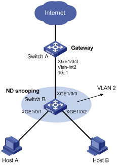

Example: Configuring SLAAC-only SAVI
As shown in Figure 2, configure SAVI on Switch B to meet the following requirements:
·           Hosts obtain IPv6 addresses only through SLAAC.
·           DHCPv6 messages are dropped on Ten-GigabitEthernet 1/0/1 through Ten-GigabitEthernet 1/0/3 in VLAN 2.
·           SAVI checks the source addresses of ND messages and IPv6 data packets on Ten-GigabitEthernet 1/0/1 and Ten-GigabitEthernet 1/0/2.
Figure 2 Network diagram
# Enable SAVI.
<SwitchB> system-view
[SwitchB] ipv6 savi strict
# Assign Ten-GigabitEthernet 1/0/1 through Ten-GigabitEthernet 1/0/3 to VLAN 2.
[SwitchB] vlan 2
[SwitchB-vlan2] port ten-gigabitethernet 1/0/1 ten-gigabitethernet 1/0/2 ten-gigabitethernet 1/0/3
[SwitchB-vlan2] quit
# Enable ND snooping for global unicast addresses in VLAN 2.
[SwitchB] vlan 2
[SwitchB-vlan2] ipv6 nd snooping enable global
# Enable ND attack detection for VLAN 2.
[SwitchB-vlan2] ipv6 nd detection enable
# Enable DHCPv6 snooping.
[SwitchB] ipv6 dhcp snooping enable
# Configure Ten-GigabitEthernet 1/0/3 as an ND trusted port.
[SwitchB] interface ten-gigabitethernet 1/0/3
[SwitchB-Ten-GigabitEthernet1/0/3] ipv6 nd detection trust
[SwitchB-Ten-GigabitEthernet1/0/3] quit
# Enable IPv6 source guard on Ten-GigabitEthernet 1/0/1 and Ten-GigabitEthernet 1/0/2.
[SwitchB] interface ten-gigabitethernet 1/0/1
[SwitchB-Ten-GigabitEthernet1/0/1] ipv6 verify source ip-address mac-address
[SwitchB-Ten-GigabitEthernet1/0/1] quit
[SwitchB] interface ten-gigabitethernet 1/0/2
[SwitchB-Ten-GigabitEthernet1/0/2] ipv6 verify source ip-address mac-address
[SwitchB-Ten-GigabitEthernet1/0/2] quit
