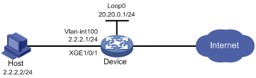

Web authentication system
A typical Web authentication system consists of four basic components: authentication client, access device, local portal Web server, and AAA server.
Figure 1 Web authentication system using the local portal server

Local portal Web server
The access device acts as the local portal Web server. The local portal Web server pushes the Web authentication page to authentication clients and obtains user authentication information (username and password).

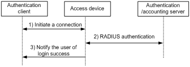

Web authentication process
Figure 2 Web authentication process
The Web authentication process is as follows:
1.      An unauthenticated user sends an HTTP or HTTPS request. When the access device receives the HTTP or HTTPS request on a Layer 2 Ethernet interface enabled with Web authentication, it redirects the request to the Web authentication page. The user enters the username and password on the Web authentication page.
If the user requests the Web authentication page or free Web resources, the access device permits the request. No Web authentication is performed.
2.      The access device and the AAA server exchange RADIUS packets to authenticate the user.
3.      If the user passes RADIUS authentication, the local portal Web server pushes a login success page to the authentication client.
If the user fails RADIUS authentication, the local portal Web server pushes a login failure page to the authentication client.

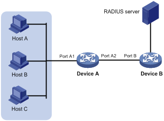

As a best practice, perform Web authentication on users directly connected to the device. As shown in Figure 3, if you enable Web authentication on Port B to authenticate non-directly connected users (the hosts), you must follow these restrictions and guidelines:
·           If the RADIUS server assigns an authorization VLAN to the users, make sure the following conditions are met:
¡  The link between Device A and Device B is a trunk link.
¡  The PVIDs of Port A1 and Port B are the same as the authorization VLAN ID.
·           If the RADIUS server does not assign an authorization VLAN to the users, make sure the PVIDs of Port A1 and Port B are the same.
Figure 3 Web authentication for non-directly connected users

Example: Configuring Web authentication by using the local authentication method
As shown in Figure 4, the host is directly connected to the device through Ten-GigabitEthernet 1/0/1.
Configure Web authentication on Ten-GigabitEthernet 1/0/1, and use local authentication and authorization for the users.
Configure the device to push customized Web authentication pages to users and use HTTP or HTTPS to transfer the authentication data.
Figure 4 Network diagram
1.      Customize the authentication pages, compress them to a file, and upload the file to the root directory of the storage medium of the device. In this example, the file is abc.zip. (Details not shown.)
2.      Assign IP addresses to the host and the device as shown in Figure 4, and make sure the host and the device can reach each other.
3.      Configure a local user:
# Create a local network access user named localuser.
<Device>system-view
[Device] local-user localuser class network
# Set the password to localpass in plaintext form for user localuser.
[Device-luser-network-localuser] password simple localpass
# Authorize the user to use LAN access services.
[Device-luser-network-localuser] service-type lan-access
[Device-luser-network-localuser] quit
4.      Configure an ISP domain:
# Create an ISP domain named local.
[Device] domain local
# Configure the ISP domain to perform local authentication, authorization, and accounting for LAN access users.
[Device-isp-local] authentication lan-access local
[Device-isp-local] authorization lan-access local
[Device-isp-local] accounting lan-access local
[Device-isp-local] quit
5.      Configure a local portal Web service:
# Create an HTTP-based local portal Web service and enter its view.
[Device] portal local-web-server http
# Specify file abc.zip as the default authentication page file for the local portal Web service. (This file must exist in the root directory of the device.)
[Device-portal-local-websvr-http] default-logon-page abc.zip
# Specify the HTTP listening port number as 80 for the portal Web service.
[Device–portal-local-websvr-http] tcp-port 80
[Device-portal-local-websvr-http] quit
6.      Configure Web authentication:
# Create a Web authentication server named user.
[Device] web-auth server user
# Configure the redirection URL for the Web authentication server as http://20.20.0.1/portal/.
[Device-web-auth-server-user] url http://20.20.0.1/portal/
# Specify 20.20.0.1 as the IP address and 80 as the port number for the Web authentication server.
[Device-web-auth-server-user] ip 20.20.0.1 port 80
[Device-web-auth-server-user] quit
# Specify ISP domain local as the Web authentication domain.
[Device] interface ten-gigabitethernet 1/0/1
[Device-Ten-GigabitEthernet1/0/1] web-auth domain local
# Enable Web authentication by using Web authentication server user.
[Device-Ten-GigabitEthernet1/0/1] web-auth enable apply server user
[Device-Ten-GigabitEthernet1/0/1] quit
# Display online Web authentication user information after user localuser passes Web authentication.
<Device> display web-auth user
  Total online web-auth users: 1
User Name: localuser
  MAC address: acf1-df6c-f9ad
  Access interface: Ten-GigabitEthernet1/0/1
  Initial VLAN: 100
  Authorization VLAN: N/A
  Authorization ACL ID: N/A
  Authorization user profile: N/A
Example: Configuring Web authentication by using the RADIUS authentication method
As shown in Figure 5, the host is directly connected to the device through Ten-GigabitEthernet 1/0/1.
Configure Web authentication on Ten-GigabitEthernet 1/0/1, and use a RADIUS server to perform authentication and authorization for the users.
Configure the device to push customized Web authentication pages to users and use HTTP to transfer the authentication data.
Figure 5 Network diagram
1.      Configure the RADIUS server properly to provide authentication and accounting functions for users. In this example, the username is configured as user1 on the RADIUS server. (Details not shown.)
2.      Customize the authentication pages, compress them to a file, and upload the file to the root directory of the storage medium of the switch. In this example, the file is abc.zip.
3.      Create VLANs, assign IP addresses to the VLAN interfaces, and assign interfaces to the VLANs. Make sure the host, the RADIUS server, and the device can reach each other. (Details not shown.)
4.      Configure a RADIUS scheme:
# Create a RADIUS scheme named rs1.
<Device> system-view
[Device] radius scheme rs1
# Specify the primary authentication server and primary accounting server, and configure the keys for communication with the servers.
[Device-radius-rs1] primary authentication 192.168.0.112
[Device-radius-rs1] primary accounting 192.168.0.112
[Device-radius-rs1] key authentication simple radius
[Device-radius-rs1] key accounting simple radius
# Exclude the ISP domain name from the username sent to the RADIUS server.
[Device-radius-rs1] user-name-format without-domain
[Device-radius-rs1] quit
5.      Configure an authentication domain:
# Create an ISP domain named dm1.
[Device] domain dm1
# Configure AAA methods for the ISP domain
[Device-isp-dm1] authentication lan-access radius-scheme rs1
[Device-isp-dm1] authorization lan-access radius-scheme rs1
[Device-isp-dm1] accounting lan-access radius-scheme rs1
[Device-isp-dm1] quit
6.      Configure a local portal Web service:
# Create an HTTP-based local portal Web service.
# Specify the file abc.zip as the default authentication page file for the local portal Web service. (This file must exist in the directly root directory of the storage medium.)
# Specify 80 as the port number listened by the local portal Web service.
7.      Configure Web authentication:
# Create Web authentication server named user.
# Specify http://20.20.0.1/portal/ as the redirection URL for the Web authentication server.
# Specify the IP address of the Web authentication server as 20.20.0.1 (the IP address of Loopback 0) and the port number as 80.
# Specify domain dml as the Web authentication domain.
[Device-Ten-GigabitEthernet1/0/1] web-auth domain dm1
# Display Web authentication user information after user user1 passes Web authentication.
User Name: user1
  Initial VLAN: 100
