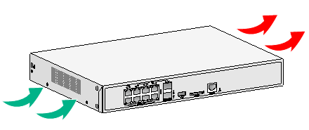

Cooling
The device uses left to right airflow for heat dissipation. Plan the installation site for adequate ventilation.
·          As a best practice, leave a minimum of 10 cm (3.94 in) of clearance around the air vents.
·          Make sure the rack or workbench has a good ventilation system.
Figure1-1 Airflow through the chassis

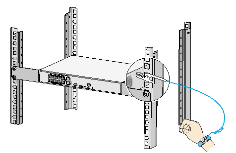

To attach an ESD wrist strap:
1.        Wear the wrist strap on your wrist.
2.        Lock the wrist strap tight around your wrist to maintain good contact with the skin.
3.        Secure the wrist strap lock and the alligator clip lock together.
4.        Attach the alligator clip to the rack.
5.        Make sure the rack is reliably grounded.
Figure1-2 Attaching an ESD wrist strap
