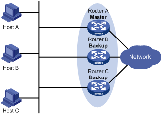

As shown in Figure 2, Router A, Router B, and Router C form a virtual router, which has its own IP address. Hosts on the subnet use the virtual router as the default gateway.
The router with the highest priority among the three routers is elected as the master, and the other two are backups. Only the master in the VRRP group can provide gateway service. When the master fails, the backup routers elect a new master to take over for nonstop gateway service.
Figure 2 VRRP networking

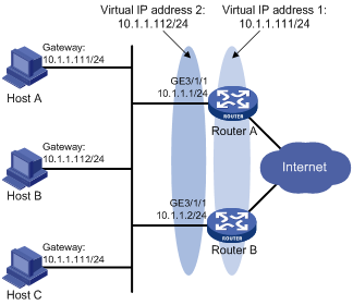

A router can join multiple VRRP groups. With different priorities in different VRRP groups, the router can act as the master in one VRRP group and a backup in another.
In load sharing mode, multiple VRRP groups provide gateway services. This mode requires a minimum of two VRRP groups, and each group has one master and multiple backups. The master roles in the VRRP groups are assumed by different routers, as shown in Figure 4.
Figure 4 Load sharing of VRRP
A router can be in multiple VRRP groups and have a different priority in each group.
As shown in Figure 4, the following VRRP groups exist:
·          VRRP group 1—Router A is the master. Router B and Router C are the backups.
·          VRRP group 2—Router B is the master. Router A and Router C are the backups.
·          VRRP group 3—Router C is the master. Router A and Router B are the backups.

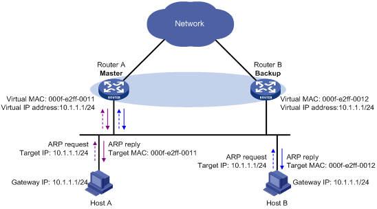

2.        When an ARP request arrives, the master (Router A) selects a virtual MAC address based on the load balancing algorithm to answer the ARP request. In this example, Router A returns the virtual MAC address of itself in response to the ARP request from Host A. Router A returns the virtual MAC address of Router B in response to the ARP request from Host B. See Figure 6.
Figure 6 Answering ARP requests
3.        Each host sends packets to the returned MAC address. As shown in Figure 7, Host A sends packets to Router A and Host B sends packets to Router B.
Figure 7 Sending packets to different routers for forwarding
In the ARP reply sent by the master, the source MAC address in the Ethernet header is different from the sender MAC address in the message body. For the Layer 2 device to forward the ARP packet, follow these configuration guidelines on the Layer 2 device:

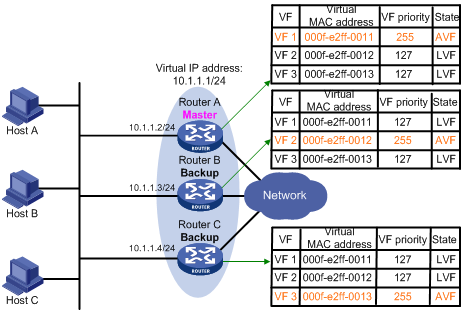

Virtual MAC addresses enable traffic distribution across routers in a VRRP group. To enable routers in the VRRP group to forward packets, VFs must be created on them. Each VF is associated with a virtual MAC address in the VRRP group and forwards packets that are sent to this virtual MAC address.
VFs are created on routers in a VRRP group, as follows:
1.        The master assigns virtual MAC addresses to all routers in the VRRP group. Each member router creates a VF for this MAC address and becomes the owner of this VF.
2.        Each VF owner advertises its VF information to the other member routers.
3.        After receiving the VF advertisement, each of the other routers creates the advertised VF.
Eventually, every member router maintains one VF for each virtual MAC address in the VRRP group.
VF weight and priority
The weight of a VF indicates the forwarding capability of a VF. A higher weight means higher forwarding capability. When the weight is lower than the lower limit of failure, the VF cannot forward packets.
The priority of a VF determines the VF state. Among the VFs created on different member routers for the same virtual MAC address, the VF with the highest priority is in active state. This VF, known as the active virtual forwarder (AVF), forwards packets. All other VFs listen to the state of the AVF and are known as the listening virtual forwarders (LVFs). VF priority is in the range of 0 to 255, where 255 is reserved for the VF owner. When the weight of a VF owner is higher than or equal to the lower limit of failure, the priority of the VF owner is 255.
The priority of a VF is calculated based on its weight.
·          If the VF weight is higher than or equal to the lower limit of failure, the following VF priorities apply:
¡  On a VF owner, the VF priority is 255.
¡  On a non-VF owner, the VF priority is calculated as weight/(number of local AVFs + 1).
·          If the VF weight is lower than the lower limit of failure, the VF priority is 0.

The VFs corresponding to a virtual MAC address on different routers in the VRRP group back up one another.
Figure 8 VF information
Figure 8 shows the VF table on each router in the VRRP group and how the VFs back up one another. The master, Router A, assigns virtual MAC addresses 000f-e2ff-0011, 000f-e2ff-0012, and 000f-e2ff-0013 to itself, Router B, and Router C, respectively. Each router creates VF 1, VF 2, and VF 3 for virtual MAC addresses 000f-e2ff-0011, 000f-e2ff-0012, and 000f-e2ff-0013, respectively. The VFs for the same virtual MAC address on different routers back up one another. For example, the VF 1 instances on Router A, Router B, and Router C back up one another.
·          The VF 1 instance on Router A (the VF 1 owner) has priority 255. It acts as the AVF to forward packets sent to virtual MAC address 000f-e2ff-0011.
·          The VF 1 instances on Router B and Router C have a priority of 255/(1 + 1), or 127. Because their priorities are lower than the priority of the VF 1 instance on Router A, they act as LVFs. These LVFs listen to the state of the VF 1 instance on Router A.
·          When the VF 1 instance on Router A fails, the VF 1 instances on Router B and Router C elect the one with higher priority as the new AVF. This AVF forwards packets destined for virtual MAC address 000f-e2ff-0011. If the two LVFs' priorities are the same, the LVF with a greater device MAC address becomes the new AVF.
A VF always operates in preemptive mode. When an LVF finds its priority value higher than the one advertised by the AVF, the LVF declares itself as the AVF.

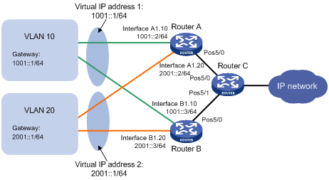

As shown in Figure 9, ambiguous VLAN termination is configured for VLAN 10 and VLAN 20 on the Layer 3 Ethernet subinterfaces on routers. To allow the master to regularly send VRRP advertisements in multicast to the backups, enable the VLAN termination-enabled subinterfaces to transmit broadcast packets and multicast packets. Then, the master can send VRRP advertisements within all VLANs whose VLAN packets are configured to be terminated by the subinterfaces. If ambiguous VLAN termination is configured on the Layer 3 Ethernet subinterfaces for a large range of VLANs, the VRRP advertisements might overload the subinterfaces. This adversely affects the performance of the routers.
To resolve this problem, you can disable the VLAN termination-enabled subinterfaces from transmitting broadcast packets and multicast packets and configure a VRRP control VLAN. The master sends VRRP advertisements only within the control VLAN.
Figure 9 VRRP control VLAN
Specify VRRP control VLANs according to the VLAN termination type.
·          For ambiguous Dot1q termination, specify one control VLAN by the outermost layer of VLAN tag.
·          For ambiguous QinQ termination, specify two control VLANs by the outermost two layers of VLAN tags.
For more information about VLAN termination, see Layer 2—LAN Switching Configuration Guide.

Specifying an IPv6 VRRP control VLAN
About IPv6 VRRP control VLANs
As shown in Figure 11, ambiguous VLAN termination is configured for VLAN 10 and VLAN 20 on the Layer 3 Ethernet subinterfaces on routers. To allow the master to regularly send IPv6 VRRP advertisements in multicast to the backups, enable the VLAN termination-enabled subinterfaces to transmit broadcast packets and multicast packets. Then, the master can send IPv6 VRRP advertisements within all VLANs whose VLAN packets are configured to be terminated by the subinterfaces. If ambiguous VLAN termination is configured on the Layer 3 Ethernet subinterfaces for a large range of VLANs, the IPv6 VRRP advertisements might overload the subinterfaces. This adversely affects the performance of the routers.
To resolve this problem, you can disable the VLAN termination-enabled subinterfaces from transmitting broadcast packets and multicast packets and configure an IPv6 VRRP control VLAN. The master sends IPv6 VRRP advertisements only within the control VLAN.
Figure 11 IPv6 VRRP control VLAN
Specify IPv6 VRRP control VLANs according to the VLAN termination type.
When IPv6 VRRP is operating in load balancing mode, you cannot specify the IPv6 VRRP control VLAN.
1.        Enter system view.
2.        Enter Layer 3 Ethernet subinterface view or Layer 3 aggregate subinterface view.
3.        Specify IPv6 VRRP control VLANs.
¡  Specify an IPv6 VRRP control VLAN for the ambiguous Dot1q termination-enabled subinterface.
vrrp ipv6 dot1q vid vlan-id
¡  Specify IPv6 VRRP control VLANs for the ambiguous QinQ termination-enabled subinterface.
vrrp ipv6 dot1q vid vlan-id secondary-dot1q secondary-vlan-id
By default, no IPv6 VRRP control VLAN is specified. The master sends IPv6 VRRP advertisements within all VLANs whose VLAN packets are configured to be terminated by the subinterface.

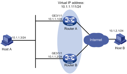

Example: Configuring a single VRRP group
As shown in Figure 13, Router A and Router B form a VRRP group. They use the virtual IP address 10.1.1.111/24 to provide gateway service for the subnet where Host A resides.
Router A operates as the master to forward packets from Host A to Host B. When Router A fails, Router B takes over to forward packets for Host A.
Configure Router A to operate in preempt mode so Router A can forward traffic as long as Router A operates correctly. Set the preemption delay to 5000 centiseconds to avoid frequent status change.
Figure 13 Network diagram

Example: Configuring multiple VRRP groups
To implement load sharing between the VRRP groups, manually configure the default gateway 10.1.1.111 for some hosts and 10.1.1.112 for the other on the subnet 10.1.1.0/24.
As shown in Figure 14, Router A and Router B form two VRRP groups to implement load sharing and mutual backup. VRRP group 1 uses the virtual IP address 10.1.1.111/24 to provide gateway service for some hosts on the subnet 10.1.1.0/24. VRRP group 2 uses the virtual IP address 10.1.1.112/24 to provide gateway service for the other hosts on the subnet.
Figure 14 Network diagram

As shown in Figure 15, Router A, Router B, and Router C form a load-balanced VRRP group. They use the virtual IP address 10.1.1.1/24 to provide gateway service for subnet 10.1.1.0/24.
Configure VFs on Router A, Router B, and Router C to monitor their respective GigabitEthernet 3/1/2. When the interface on any one of them fails, the weights of the VFs on the problematic router decrease so another AVF can take over.
Figure 15 Network diagram

# Display detailed information about VRRP group 1 on Router B.
[RouterB-GigabitEthernet3/1/1] display vrrp verbose
IPv4 virtual router information:
 Running mode      : Load balance
 Total number of virtual routers : 1
   Interface GigabitEthernet3/1/1
     VRID             : 1                    Adver timer  : 100 centiseconds
     Admin status     : Up                   State        : Backup
     Config pri       : 110                  Running pri  : 110
     Preempt mode     : Yes                  Delay time   : 5000 centiseconds
     Become master    : 426ms milliseconds left
     Auth type        : None
     Virtual IP       : 10.1.1.1
     Member IP list   : 10.1.1.3 (Local, Backup)
                        10.1.1.2 (Master)
                        10.1.1.4 (Backup)
   Forwarder information: 3 Forwarders 1 Active
     Config weight  : 255
     Running weight : 255
    Forwarder 01
     State          : Listening
     Virtual MAC    : 000f-e2ff-0011 (Learnt)
     Owner ID       : 0000-5e01-1101
     Priority       : 127
     Active         : 10.1.1.2
    Forwarder 02
     State          : Active
     Virtual MAC    : 000f-e2ff-0012 (Owner)
     Owner ID       : 0000-5e01-1103
     Priority       : 255
     Active         : local
    Forwarder 03
     State          : Listening
     Virtual MAC    : 000f-e2ff-0013 (Learnt)
     Owner ID       : 0000-5e01-1105
     Priority       : 127
     Active         : 10.1.1.4
   Forwarder weight track information:
     Track object   : 1          State : Positive   Weight reduced : 250
# Display detailed information about VRRP group 1 on Router C.
[RouterC-GigabitEthernet3/1/1] display vrrp verbose
     Config pri       : 100                  Running pri  : 100 centiseconds
     Become master    : 417 milliseconds left
     Auth type        : None
     Member IP list   : 10.1.1.4 (Local, Backup)
                        10.1.1.2 (Master)
                        10.1.1.3 (Backup)
     Config weight  : 255
    Forwarder 01
     State          : Listening
     Priority       : 127
     Active         : 10.1.1.2
    Forwarder 02
     State          : Listening
     Virtual MAC    : 000f-e2ff-0012 (Learnt)
     Priority       : 127
     Active         : 10.1.1.3
    Forwarder 03
     State          : Active
     Virtual MAC    : 000f-e2ff-0013 (Owner)
     Priority       : 255
     Active         : local
The output shows that Router A is the master in VRRP group 1, and each of the three routers has one AVF and two LVFs.
# Disconnect the link of GigabitEthernet 3/1/2 on Router A, and display detailed information about VRRP group 1 on Router A.
[RouterA-GigabitEthernet3/1/1] display vrrp verbose
     Admin status     : Up                   State        : Master
     Config pri       : 120                  Running pri  : 120
     Auth type        : None
     Member IP list   : 10.1.1.2 (Local, Master)
                        10.1.1.3 (Backup)
                        10.1.1.4 (Backup)
   Forwarder information: 3 Forwarders 0 Active
     Config weight  : 255
     Running weight : 5
    Forwarder 01
     State          : Initialize
     Virtual MAC    : 000f-e2ff-0011 (Owner)
     Priority       : 0
     Active         : 10.1.1.4
    Forwarder 02
     State          : Initialize
     Priority       : 0
     Active         : 10.1.1.3
    Forwarder 03
     State          : Initialize
     Priority       : 0
     Active         : 10.1.1.4
     Track object   : 1          State : Negative   Weight reduced : 250
     Become master    : 412 milliseconds left
     Auth type        : None
                        10.1.1.2 (Master)
                        10.1.1.3 (Backup)
   Forwarder information: 3 Forwarders 2 Active
     Config weight  : 255
    Forwarder 01
     State          : Active
     Virtual MAC    : 000f-e2ff-0011 (Take Over)
     Priority       : 85
     Active         : local
    Forwarder 02
     State          : Listening
     Priority       : 85
     Active         : 10.1.1.3
    Forwarder 03
     State          : Active
     Priority       : 255
     Active         : local
The output shows that when GigabitEthernet 3/1/2 on Router A fails, the weights of the VFs on Router A drop below the lower limit of failure. All VFs on Router A transit to the Initialize state and cannot forward traffic. The VF for MAC address 000f-e2ff-0011 on Router C becomes the AVF to forward traffic.
# When the timeout timer (about 1800 seconds) expires, display detailed information about VRRP group 1 on Router C.
     Auth type        : None
                        10.1.1.2 (Master)
                        10.1.1.3 (Backup)
   Forwarder information: 2 Forwarders 1 Active
     Config weight  : 255
    Forwarder 02
     State          : Listening
     Priority       : 127
     Active         : 10.1.1.3
    Forwarder 03
     State          : Active
     Priority       : 255
     Active         : local
The output shows that when the timeout timer expires, the VF for virtual MAC address 000f-e2ff-0011 is removed. The VF no longer forwards the packets destined for the MAC address.
# When Router A fails, display detailed information about VRRP group 1 on Router B.
     Auth type        : None
     Member IP list   : 10.1.1.3 (Local, Master)
                        10.1.1.4 (Backup)
     Config weight  : 255
    Forwarder 02
     State          : Active
     Priority       : 255
     Active         : local
    Forwarder 03
     State          : Listening
     Priority       : 127
     Active         : 10.1.1.4
The output shows the following information:
·          When Router A fails, Router B becomes the master because it has a higher priority than Router C.
·          The VF for virtual MAC address 000f-e2ff-0011 is removed.

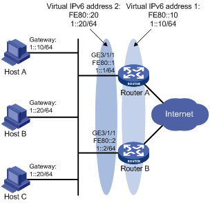

IPv6 VRRP configuration examples
As shown in Figure 16, Router A and Router B form a VRRP group. They use the virtual IP addresses 1::10/64 and FE80::10 to provide gateway service for the subnet where Host A resides.
Host A learns 1::10/64 as its default gateway from RA messages sent by the routers.
Figure 16 Network diagram
1.        Configure Router A:
# Specify an IPv6 address for Router A.
<RouterA> system-view
[RouterA] interface gigabitethernet 3/1/1
[RouterA-GigabitEthernet3/1/1] ipv6 address fe80::1 link-local
[RouterA-GigabitEthernet3/1/1] ipv6 address 1::1 64
# Create VRRP group 1, and set its virtual IPv6 addresses to FE80::10 and 1::10.
[RouterA-GigabitEthernet3/1/1] vrrp ipv6 vrid 1 virtual-ip fe80::10 link-local
[RouterA-GigabitEthernet3/1/1] vrrp ipv6 vrid 1 virtual-ip 1::10
# Assign Router A a higher priority than Router B in VRRP group 1, so Router A can become the master.
[RouterA-GigabitEthernet3/1/1] vrrp ipv6 vrid 1 priority 110
# Configure Router A to operate in preemptive mode, so it can become the master whenever it operates correctly. Set the preemption delay to 5000 centiseconds to avoid frequent status switchover.
[RouterA-GigabitEthernet3/1/1] vrrp ipv6 vrid 1 preempt-mode delay 5000
# Enable Router A to send RA messages, so Host A can learn the default gateway address.
[RouterA-GigabitEthernet3/1/1] undo ipv6 nd ra halt
2.        Configure Router B:
# Specify an IPv6 address for Router B.
<RouterB> system-view
[RouterB] interface gigabitethernet 3/1/1
[RouterB-GigabitEthernet3/1/1] ipv6 address fe80::2 link-local
[RouterB-GigabitEthernet3/1/1] ipv6 address 1::2 64
[RouterB-GigabitEthernet3/1/1] vrrp ipv6 vrid 1 virtual-ip fe80::10 link-local
[RouterB-GigabitEthernet3/1/1] vrrp ipv6 vrid 1 virtual-ip 1::10
# Configure Router B to operate in preemptive mode, and set the preemption delay to 5000 centiseconds.
[RouterB-GigabitEthernet3/1/1] vrrp ipv6 vrid 1 preempt-mode delay 5000
# Enable Router B to send RA messages, so Host A can learn the default gateway address.
[RouterB-GigabitEthernet3/1/1] undo ipv6 nd ra halt
# Ping Host B from Host A. (Details not shown.)
# Display detailed information about VRRP group 1 on Router A.
[RouterA-GigabitEthernet3/1/1] display vrrp ipv6 verbose
IPv6 virtual router information:
 Running mode      : Standard
     Auth type        : None
     Virtual IP       : FE80::10
                        1::10
     Virtual MAC      : 0000-5e00-0201
     Master IP        : FE80::1
[RouterB-GigabitEthernet3/1/1] display vrrp ipv6 verbose
     Become master    : 411 milliseconds left
     Auth type        : None
                        1::10
     Master IP        : FE80::1
The output shows that Router A is operating as the master in VRRP group 1 to forward packets from Host A to Host B.
# Disconnect the link between Host A and Router A, and verify that Host A can still ping Host B. (Details not shown.)
To implement load sharing between the VRRP groups, manually configure the default gateway 1::10 for some hosts and 1::20 for the other hosts on the subnet 1::/64.
As shown in Figure 17, Router A and Router B form two VRRP groups to implement load sharing and mutual backup. VRRP group 1 uses the virtual IP address 1::10/64 to provide gateway service for some hosts on the subnet 1::/64. VRRP group 2 uses the virtual IP address 1::20/64 to provide gateway service for the other hosts on the subnet.
Figure 17 Network diagram
# Create VRRP group 1, and set its virtual IPv6 addresses to FE80::10 to 1::10.
# Assign a higher priority to Router A than Router B in VRRP group 1, so Router A can become the master in the group.
# Create VRRP group 2, and set its virtual IPv6 addresses to FE80::20 and 1::20.
[RouterA-GigabitEthernet3/1/1] vrrp ipv6 vrid 2 virtual-ip fe80::20 link-local
[RouterA-GigabitEthernet3/1/1] vrrp ipv6 vrid 2 virtual-ip 1::20
[RouterB-GigabitEthernet3/1/1] vrrp ipv6 vrid 2 virtual-ip fe80::20 link-local
[RouterB-GigabitEthernet3/1/1] vrrp ipv6 vrid 2 virtual-ip 1::20
# Assign Router B a higher priority than Router A in VRRP group 2, so Router B can become the master in the group.
[RouterB-GigabitEthernet3/1/1] vrrp ipv6 vrid 2 priority 110
# Display detailed information about the VRRP groups on Router A.
 Total number of virtual routers : 2
     Preempt mode     : Yes                  Delay time   : 0 centiseconds
     Auth type        : None
                        1::10
     Master IP        : FE80::1
     VRID             : 2                    Adver timer  : 100 centiseconds
     Become master    : 410 milliseconds left
     Auth type        : None
     Virtual IP       : FE80::20
                        1::20
     Master IP        : FE80::2
# Display detailed information about the VRRP groups on Router B.
     Become master    : 407 milliseconds left
     Auth type        : None
                        1::10
     Master IP        : FE80::1
     Auth type        : None
                        1::20
     Virtual MAC      : 0000-5e00-0202
     Master IP        : FE80::2
·          Router A is operating as the master in VRRP group 1 to forward Internet traffic for hosts that use the default gateway 1::10/64.
·          Router B is operating as the master in VRRP group 2 to forward Internet traffic for hosts that use the default gateway 1::20/64.
Example: Configuring VRRP load balancing
As shown in Figure 18, Router A, Router B, and Router C form a load balanced VRRP group and use the virtual IPv6 addresses FE80::10 and 1::10 to provide gateway service for the subnet 1::/64.
Hosts on subnet 1::/64 learn 1::10 as their default gateway from RA messages sent by the routers.
Configure VFs on Router A, Router B, or Router C to monitor their respective GigabitEthernet 3/1/2. When the interface on any of them fails, the weights of the VFs on the problematic router decrease so another AVF can take over.
Figure 18 Network diagram

The output shows that when GigabitEthernet 3/1/2 on Router A fails, the weights of the VFs on Router A drop below the lower limit of failure. All VFs on Router A transit to the Initialize state and cannot forward traffic. The VF for MAC address 000f-e2ff-4011 on Router C becomes the AVF to forward traffic.

The output shows that when the timeout timer expires, the VF for virtual MAC address 000f-e2ff-4011 is removed. The VF no longer forwards the packets destined for the MAC address.
·          The VF for virtual MAC address 000f-e2ff-4011 is removed.
