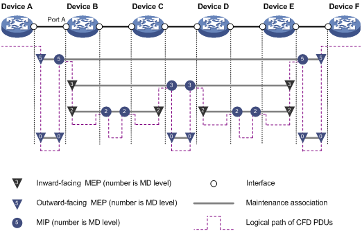

CFD grading example
Figure 3 demonstrates a grading example of the CFD module. Four levels of MDs (0, 2, 3, and 5) are designed. The bigger the number, the higher the level and the larger the area covered. MPs are configured on the ports of Device A through Device F. Port A of Device B is configured with the following MPs:
·          A level 5 MIP.
·          A level 3 inward-facing MEP.
·          A level 2 inward-facing MEP.
·          A level 0 outward-facing MEP.
Figure 3 CFD grading example

CFD configuration examples
Example: Configuring CFD
As shown in Figure 4:
·          The network comprises five devices and is divided into two MDs: MD_A (level 5) and MD_B (level 3). All ports belong to VLAN 100, and the MAs in the two MDs all serve VLAN 100. Assume that the MAC addresses of Device A through Device E are 0010-FC01-6511, 0010-FC02-6512, 0010-FC03-6513, 0010-FC04-6514, and 0010-FC05-6515, respectively.
·          MD_A has three edge ports: GigabitEthernet 3/1/1 on Device A, GigabitEthernet 3/1/3 on Device D, and GigabitEthernet 3/1/4 on Device E. They are all inward-facing MEPs. MD_B has two edge ports: GigabitEthernet 3/1/3 on Device B and GigabitEthernet 3/1/1 on Device D. They are both outward-facing MEPs.
·          In MD_A, Device B is designed to have MIPs when its port is configured with low level MEPs. Port GigabitEthernet 3/1/3 is configured with MEPs of MD_B, and the MIPs of MD_A can be configured on this port. You must configure the MIP generation rule of MD_A as explicit.
·          The MIPs of MD_B are designed on Device C, and are configured on all ports. You must configure the MIP generation rule as default.
·          Configure CC to monitor the connectivity among all the MEPs in MD_A and MD_B. Configure LB to locate link faults, and use the AIS and EAIS functions to suppress the error alarms that are reported.
·          After the status information of the entire network is obtained, use LT, LM, one-way DM, two-way DM, and TST to detect link faults.
Figure 4 Network diagram
1.        Configure a VLAN and assign ports to it:
On each device shown in Figure 4, create VLAN 100 and assign ports GigabitEthernet 3/1/1 through GigabitEthernet 3/1/4 to VLAN 100.
