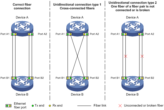

Application scenario
A link becomes unidirectional when only one end of the link can receive packets from the other end.
Unidirectional fiber links occur in the following cases:
·          Fibers are cross-connected.
·          A fiber is not connected at one end or one fiber of a fiber pair is broken.
Figure 1 shows a correct fiber connection and two types of unidirectional fiber connections.
When DLDP detects unidirectional links, it can automatically shut down the faulty port to avoid network problems. Alternatively, a user can manually shut down the faulty port.
Figure 1 Correct and incorrect fiber connections

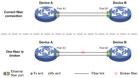

Figure 3 Broken fiber
As shown in Figure 3, Device A and Device B are connected through an optical fiber. After you enable DLDP, Port A1 and Port B1 establish the bidirectional neighborship in the following way:
a.    Port A1 that is physically up enters the unidirectional state and sends a RecoverProbe packet.
b.    After receiving the RecoverProbe packet, Port B1 returns a RecoverEcho packet.
c.    After Port A1 receives the RecoverEcho packet, it examines the neighbor information in the packet. If the neighbor information matches the local information, Port A1 establishes the neighborship with Port B1 and transits to bidirectional state. Port A1 then starts the Entry timer and periodically sends Advertisement packets.
d.    After Port B1 receives the Advertisement packet, it establishes the Unconfirmed neighborship with Port A1. Port B1 then starts the Echo timer and Probe timer, and periodically sends Probe packets.
e.    After receiving the Probe packet, Port A1 returns an Echo packet.
f.     After Port B1 receives the Echo packet, it examines the neighbor information in the packet. If the neighbor information matches the local information, the neighbor state of Port A1 becomes Confirmed. Port B1 then transits to bidirectional state, starts the Entry timer, and periodically sends Advertisement packets.
The bidirectional neighborship between Port A1 and Port B1 is now established.
After that, when Port B1's Rx end fails to receive signals, Port B1 is physically down and enters the Inactive state. Because Port B1's Tx end can still send signals to Port A1, Port A1 stays up. After the Entry timer for Port B1 expires, Port A1 starts the Enhanced timer and Echo timer, and sends a probe packet to Port B1. Because Port A1's Tx line is broken, Port A1 cannot receive the Echo packet from Port B1 after the Echo timer expires. Port A1 then enters the unidirectional state, and sends a Disable packet to Port B1. At the same time, Port A1 deletes the neighborship with Port B1, and starts the RecoverProbe timer. Port B1 stays in Inactive state during this process.
When an interface is physically down, but the Tx end of the interface is still operating, DLDP sends a LinkDown packet to inform the peer to delete the relevant neighbor entry.

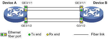

DLDP configuration examples
Example: Automatically shutting down unidirectional links
As shown in Figure 5, Device A and Device B are connected through two fiber pairs.
Configure DLDP to automatically shut down the faulty port upon detecting a unidirectional link, and automatically bring up the port after you clear the fault.
Figure 5 Network diagram

The output shows that the DLDP port status of both GigabitEthernet 3/1/1 and GigabitEthernet 3/1/2 is unidirectional. DLDP detects unidirectional links on them and automatically shuts down the two ports.
The unidirectional links are caused by cross-connected fibers. Correct the fiber connections. As a result, the ports shut down by DLDP automatically recover, and Device A displays the following log information:

Example: Manually shutting down unidirectional links
As shown in Figure 6, Device A and Device B are connected through two fiber pairs.
Configure DLDP to detect unidirectional links. When a unidirectional link is detected, the administrator must manually shut down the port.
Figure 6 Network diagram

The output shows that the DLDP port status of both GigabitEthernet 3/1/1 and GigabitEthernet 3/1/2 is unidirectional. DLDP detects unidirectional links on the two ports but does not shut them down.
The unidirectional links are caused by cross-connected fibers. Manually shut down the two ports:
