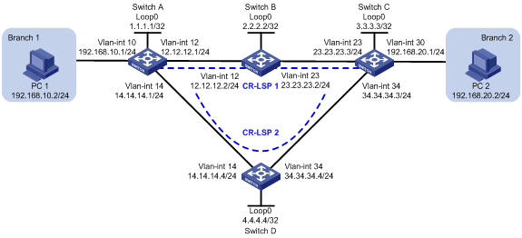

Example: Configuring BFD for an LSP
As shown in Figure 1, a company has two branches that are connected to the MPLS backbone. It requires the MPLS backbone to establish LSPs for communication between the branches, and to provide high availability services for uninterrupted business between the branches.
To meet the requirements:
·          Establish LSPs by using LDP.
·          Configure OSPF FRR on the MPLS backbone so LDP can establish a primary LSP and a backup LSP.
·          Configure BFD for the primary LSP. When the primary LSP fails, BFD can quickly detect the failure and notify LDP of the failure, so LDP can immediately switch traffic to the backup LSP.
Figure 1 Network diagram

1.        Configure IP addresses for interfaces:
# On PE 1, configure IP addresses and masks for interfaces, including the loopback interface, as shown in Figure 1.
<PE1> system-view
[PE1] vlan 10
[PE1-vlan10] port ten-gigabitethernet 1/0/3
[PE1-vlan10] quit
[PE1] interface vlan-interface 10
[PE1-Vlan-interface10] ip address 192.168.10.1 24
[PE1] vlan 12
[PE1-vlan12] port ten-gigabitethernet 1/0/1
[PE1-vlan12] quit
[PE1] interface vlan-interface 12
[PE1-Vlan-interface12] ip address 12.12.12.1 24
[PE1-Vlan-interface12] quit
[PE1] vlan 14
[PE1-vlan14] port ten-gigabitethernet 1/0/2
[PE1-vlan14] quit
[PE1] interface vlan-interface 14
[PE1-Vlan-interface14] ip address 14.14.14.1 24
[PE1-Vlan-interface14] quit
[PE1] interface loopback 0
[PE1-LoopBack0] ip address 1.1.1.1 32
[PE1-LoopBack0] quit
# Configure other devices in the same way that PE 1 is configured. (Details not shown.)

Example: Configuring BFD for an MPLS TE tunnel
As shown in Figure 2, a company has two branches that are connected to the MPLS backbone. It requires the MPLS backbone to establish an MPLS TE tunnel for communication between the branches, and to provide high availability services for uninterrupted business between the branches.
·          Use RSVP-TE to establish an MPLS TE tunnel between Switch A and Switch C.
·          Configure CRLSP backup for the MPLS TE tunnel to simultaneously establish a primary CRLSP (CR-LSP 1) and a backup CRLSP (CR-LSP 2).
·          Configure BFD for the MPLS TE tunnel. When the primary CRLSP fails, BFD can quickly detect the failure and notify RSVP of the failure, so RSVP can immediately switch traffic to the backup CRLSP.
Figure 2 Network diagram
Software versions used
This configuration example was created and verified on S6890-CMW710-R2712.
When you configure BFD for an MPLS TE tunnel, follow these restrictions and guidelines:
·          Before configuration, disable the spanning tree feature globally or map each VLAN to an MSTI.
·          OSPF TE uses Type-10 opaque LSAs to carry the TE attributes for a link. Before you configure OSPF TE, you must enable opaque LSA advertisement and reception by using the opaque-capability enable command. For more information about opaque LSA advertisement and reception, see Layer 3—IP Routing Configuration Guide.
·          MPLS TE cannot reserve resources and distribute labels for an OSPF virtual link. Make sure no virtual link exists in an OSPF area before you configure MPLS TE.
·          By default, interfaces on the device are disabled (in ADM or Administratively Down state). To have an interface operate, you must use the undo shutdown command to enable that interface.
Procedures
# On Switch A, configure IP addresses and masks for interfaces, including the loopback interface, as shown in Figure 2.
<SwitchA> system-view
[SwitchA] vlan 10
[SwitchA-vlan10] port ten-gigabitethernet 1/0/3
[SwitchA-vlan10] quit
[SwitchA-Vlan-interface10] ip address 192.168.10.1 24
[SwitchA] vlan 12
[SwitchA-vlan12] port ten-gigabitethernet 1/0/1
[SwitchA-vlan12] quit
[SwitchA] interface vlan-interface 12
[SwitchA-Vlan-interface12] ip address 12.12.12.1 24
[SwitchA-Vlan-interface12] quit
[SwitchA] vlan 14
[SwitchA-vlan14] port ten-gigabitethernet 1/0/2
[SwitchA-vlan14] quit
[SwitchA] interface vlan-interface 14
[SwitchA-Vlan-interface14] ip address 14.14.14.1 24
[SwitchA-Vlan-interface14] quit
[SwitchA] interface loopback 0
[SwitchA-LoopBack0] ip address 1.1.1.1 32
[SwitchA-LoopBack0] quit
# Configure other devices in the same way that Switch A is configured. (Details not shown.)
2.        Configure an LSR ID, and enable MPLS, MPLS TE, and RSVP-TE:
# Configure Switch A.
[SwitchA] mpls lsr-id 1.1.1.1
[SwitchA] mpls te
[SwitchA-te] quit
[SwitchA] rsvp
[SwitchA-rsvp] quit
[SwitchA-Vlan-interface12] mpls enable
[SwitchA-Vlan-interface12] mpls te enable
[SwitchA-Vlan-interface12] rsvp enable
[SwitchA-Vlan-interface14] mpls enable
[SwitchA-Vlan-interface14] mpls te enable
[SwitchA-Vlan-interface14] rsvp enable
# Configure Switch B, Switch C, and Switch D in the same way that Switch A is configured. (Details not shown.)
3.        Configure OSPF to ensure IP connectivity within the MPLS backbone, enable opaque LSA advertisement and reception, and enable MPLS TE for OSPF area 0:
[SwitchA] ospf
[SwitchA-ospf-1] opaque-capability enable
[SwitchA-ospf-1] area 0
[SwitchA-ospf-1-area-0.0.0.0] mpls te enable
[SwitchA-ospf-1-area-0.0.0.0] network 1.1.1.1 0.0.0.0
[SwitchA-ospf-1-area-0.0.0.0] network 12.12.12.0 0.0.0.255
[SwitchA-ospf-1-area-0.0.0.0] network 14.14.14.0 0.0.0.255
[SwitchA-ospf-1-area-0.0.0.0] network 192.168.10.0 0.0.0.255
[SwitchA-ospf-1-area-0.0.0.0] quit
[SwitchA-ospf-1] quit
# Configure Switch B.
[SwitchB] ospf
[SwitchB-ospf-1] opaque-capability enable
[SwitchB-ospf-1] area 0
[SwitchB-ospf-1-area-0.0.0.0] mpls te enable
[SwitchB-ospf-1-area-0.0.0.0] network 2.2.2.2 0.0.0.0
[SwitchB-ospf-1-area-0.0.0.0] network 12.12.12.0 0.0.0.255
[SwitchB-ospf-1-area-0.0.0.0] network 23.23.23.0 0.0.0.255
[SwitchB-ospf-1-area-0.0.0.0] quit
[SwitchB-ospf-1] quit
# Configure Switch C.
[SwitchC] ospf
[SwitchC-ospf-1] opaque-capability enable
[SwitchC ospf-1] area 0
[SwitchC-ospf-1-area-0.0.0.0] mpls te enable
[SwitchC-ospf-1-area-0.0.0.0] network 3.3.3.3 0.0.0.0
[SwitchC ospf-1-area-0.0.0.0] network 23.23.23.0 0.0.0.255
[SwitchC ospf-1-area-0.0.0.0] network 34.34.34..0 0.0.0.255
[SwitchC ospf-1-area-0.0.0.0] network 192.168.20.0 0.0.0.255
[SwitchC ospf-1-area-0.0.0.0] quit
[SwitchC ospf-1] quit
# Configure Switch D.
[SwitchD] ospf
[SwitchD-ospf-1] opaque-capability enable
[SwitchD-ospf-1] area 0
[SwitchD-ospf-1-area-0.0.0.0] network 4.4.4.4 0.0.0.0
[SwitchD-ospf-1-area-0.0.0.0] network 14.14.14.0 0.0.0.255
[SwitchD-ospf-1-area-0.0.0.0] network 34.34.34.0 0.0.0.255
[SwitchD-ospf-1-area-0.0.0.0] quit
[SwitchD-ospf-1] quit
4.        Configure an MPLS TE tunnel:
# On Switch A, configure MPLS TE tunnel interface Tunnel 3, and specify the tunnel destination address as the LSR ID of Switch C.
[SwitchA] interface tunnel 3 mode mpls-te
[SwitchA-Tunnel3] ip address 9.1.1.1 255.255.255.0
[SwitchA-Tunnel3] destination 3.3.3.3
# Configure MPLS TE to use RSVP-TE to establish the tunnel, and enable CRLSP hot backup for the tunnel.
[SwitchA-Tunnel3] mpls te signaling rsvp-te
[SwitchA-Tunnel3] mpls te backup hot-standby
[SwitchA-Tunnel3] quit
# Configure explicit paths for the MPLS TE tunnel.
[SwitchA] explicit-path cr-lsp1
[SwitchA-explicit-path-cr-lsp1] nexthop 12.12.12.2
[SwitchA-explicit-path-cr-lsp1] quit
[SwitchA]explicit-path cr-lsp2
[SwitchA-explicit-path-cr-lsp2] nexthop 14.14.14.4
[SwitchA-explicit-path-cr-lsp2]quit
# Set the preference to 1 for CR-LSP 1 and set the preference to 2 for CR-LSP 2.
[SwitchA-Tunnel3] mpls te path preference 1 explicit-path cr-lsp1
[SwitchA-Tunnel3] mpls te path preference 2 explicit-path cr-lsp2
# On Switch C, configure MPLS TE tunnel interface Tunnel 3, and specify the tunnel destination address as the LSR ID of Switch A.
[SwitchC] interface tunnel 3 mode mpls-te
[SwitchC-Tunnel3] ip address 9.3.3.3 255.255.255.0
[SwitchC-Tunnel3] destination 1.1.1.1
[SwitchC-Tunnel3] mpls te signaling rsvp-te
[SwitchC-Tunnel3] mpls te backup hot-standby
[SwitchC-Tunnel3] quit
[SwitchC] explicit-path cr-lsp1
[SwitchC-explicit-path-cr-lsp1] nexthop 23.23.23.2
[SwitchC-explicit-path-cr-lsp1] quit
[SwitchC]explicit-path cr-lsp2
[SwitchC-explicit-path-cr-lsp2] nexthop 34.34.34.4
[SwitchC-explicit-path-cr-lsp2]quit
[SwitchC-Tunnel3] mpls te path preference 1 explicit-path cr-lsp1
[SwitchC-Tunnel3] mpls te path preference 2 explicit-path cr-lsp2
5.        Configure static routing to direct traffic to the MPLS TE tunnel:
# Configure a static route on Switch A to direct the traffic destined for subnet 192.168.20.0/24 to MPLS TE Tunnel 3.
[SwitchA] ip route-static 192.168.20.0 24 tunnel 3 preference 1
# Configure a static route on Switch C to direct the traffic destined for subnet 192.168.10.0/24 to MPLS TE Tunnel 3.
[SwitchC] ip route-static 192.168.10.0 24 tunnel 3 preference 1
6.        Enable BFD for MPLS and use BFD to verify MPLS TE tunnel connectivity:
[SwitchA] mpls bfd enable
[SwitchA-Tunnel3] mpls bfd
[SwitchC] mpls bfd enable
[SwitchC-Tunnel3] mpls bfd

# Execute the display rsvp lsp verbose command on Switch A. The output shows detailed information about the primary and backup CRLSPs. The primary CRLSP uses the output interface VLAN-interface 12 and the next hop 12.12.12.2. The backup CRLSP uses the output interface VLAN-interface 14 and the next hop 14.14.14.4.
<SwitchA> display rsvp lsp destination 3.3.3.3 verbose
Tunnel name: Tunnel3
Destination: 3.3.3.3                      Source: 1.1.1.1
Tunnel ID: 3                              LSP ID: 37161
LSR type: Ingress                         Direction: Unidirectional
Setup priority: 7                         Holding priority: 7
In-Label: -                               Out-Label: 1149
In-Interface: -                           Out-Interface: Vlan12
Nexthop: 12.12.12.2                       Exclude-any: 0
Include-Any: 0                            Include-all: 0
Mean rate (CIR): 0 kbps                   Mean burst size (CBS): 1000.00 bytes
Path MTU: 1500                            Class type: CT0
RRO number: 6
  12.12.12.1/32      Flag: 0x00 (No FRR)
  12.12.12.2/32      Flag: 0x00 (No FRR)
  2.2.2.2/32         Flag: 0x20 (No FRR/Node-ID)
  23.23.23.2/32      Flag: 0x00 (No FRR)
  23.23.23.3/32      Flag: 0x00 (No FRR)
  3.3.3.3/32         Flag: 0x20 (No FRR/Node-ID)
Fast Reroute protection: None
Tunnel ID: 3                              LSP ID: 37162
In-Interface: -                           Out-Interface: Vlan14
Nexthop: 14.14.14.4                       Exclude-any: 0
RRO number: 6
  14.14.14.1/32      Flag: 0x00 (No FRR)
  14.14.14.4/32      Flag: 0x00 (No FRR)
  4.4.4.4/32         Flag: 0x20 (No FRR/Node-ID)
  34.34.34.4/32      Flag: 0x00 (No FRR)
  34.34.34.3/32      Flag: 0x00 (No FRR)
2.        Display BFD information for the MPLS TE tunnel on Switch A. The output shows that BFD sessions have been established for the primary and backup CRLSPs and the state of the session is up.
<SwitchA> display mpls bfd te tunnel 3
 Total number of sessions: 2, 2 up, 0 down, 0 init
 FEC Type: TE Tunnel
 FEC Info:
   Send Addr: 1.1.1.1
   End  Addr: 3.3.3.3
   Tunnel ID: 3
   LSP ID   : 37161
 NHLFE ID: 1029
 Local Discr: 34                     Remote Discr: 33
 Source IP: 1.1.1.1                  Destination IP: 127.0.0.1
 Session State: Up                   Session Role: Passive
 Template Name: -
 FEC Type: TE Tunnel
 FEC Info:
   Send Addr: 1.1.1.1
   End  Addr: 3.3.3.3
   Tunnel ID: 3
   LSP ID   : 37162
 NHLFE ID: 1031
 Local Discr: 33                     Remote Discr: 36
 Source IP: 1.1.1.1                  Destination IP: 127.0.0.4
 Template Name: -
3.        Shut down VLAN-interface 23 on Switch B, and display MPLS TE tunnel information and BFD information:
# Shut down VLAN-interface 23 on Switch B.
[SwitchB] interface vlan-interface 23
[SwitchB-Vlan-interface23] shutdown
# Execute the display mpls te tunnel-interface command on Switch A. The output shows that the primary CRLSP is down and the backup CRLSP is up.
<SwitchA> display mpls te tunnel-interface
Tunnel Name            : Tunnel 3
Tunnel State           : Up (Main CRLSP down, Backup CRLSP up)
Tunnel Attributes      :
  LSP ID               : 0               Tunnel ID            : 3
  Admin State          : Normal
  Ingress LSR ID       : -               Egress LSR ID        : 3.3.3.3
  Signaling            : RSVP-TE         Static CRLSP Name    : -
  Resv Style           : SE
  Tunnel mode          : -
  Reverse-LSP name     : -
  Reverse-LSP LSR ID   : -               Reverse-LSP Tunnel ID: -
  Class Type           : CT0             Tunnel Bandwidth     : 0 kbps
  Reserved Bandwidth   : 0 kbps
  Setup Priority       : 7               Holding Priority     : 7
  Affinity Attr/Mask   : 0/0
  Explicit Path        : -
  Backup Explicit Path : -
  Metric Type          : TE
  Record Route         : Enabled         Record Label         : Disabled
  FRR Flag             : Disabled        Bandwidth Protection : Disabled
  Backup Bandwidth Flag: Disabled        Backup Bandwidth Type: -
  Backup Bandwidth     : -
  Bypass Tunnel        : No              Auto Created         : No
  Route Pinning        : Disabled
  Retry Limit          : 3               Retry Interval       : 2 sec
  Reoptimization       : Disabled        Reoptimization Freq  : -
  Backup Type          : Hot Standby     Backup LSP ID        : 37162
  Auto Bandwidth       : Disabled        Auto Bandwidth Freq  : -
  Min Bandwidth        : -               Max Bandwidth        : -
  Collected Bandwidth  : -
# Display BFD information for CR-LSP 2 on Switch A.
 Total number of sessions: 1, 1 up, 0 down, 0 init
 FEC Type: TE Tunnel
 FEC Info:
   Send Addr: 1.1.1.1
   End  Addr: 3.3.3.3
   Tunnel ID: 3
   LSP ID   : 37162
 NHLFE ID: 1031
 Template Name: -
4.        Bring up VLAN-interface 23 on Switch B and display MPLS TE tunnel information:
# Bring up VLAN-interface 23 on Switch B.
[SwitchB-Vlan-interface23] undo shutdown
# Execute the display mpls te tunnel-interface command on Switch A. The output shows that the primary CRLSP becomes available again.
Tunnel State           : Up (Main CRLSP up, Backup CRLSP up)
Tunnel Attributes      :
  LSP ID               : 37177           Tunnel ID            : 3
  Ingress LSR ID       : 1.1.1.1         Egress LSR ID        : 3.3.3.3
  Resv Style           : SE
  Tunnel mode          : -
  Explicit Path        : cr-lsp1
  Metric Type          : TE
  Backup Type          : Hot Standby     Backup LSP ID        : 37178
Configuration files
·          Switch A:
ospf 1
 area 0.0.0.0
  mpls te enable
 mpls lsr-id 1.1.1.1
vlan 10
vlan 12
vlan 14
mpls te
 nexthop index 1 12.12.12.2 include strict
 nexthop index 1 14.14.14.4 include strict
rsvp
 mpls bfd enable
interface LoopBack0
 ip address 1.1.1.1 255.255.255.255
interface Vlan-interface10
 ip address 192.168.10.1 255.255.255.0
interface Vlan-interface12
 ip address 12.12.12.1 255.255.255.0
 mpls enable
 mpls te enable
 rsvp enable
interface Vlan-interface14
 ip address 14.14.14.1 255.255.255.0
 mpls enable
 mpls te enable
 rsvp enable
interface Ten-GigabitEthernet1/0/1
 port link-mode bridge
 port access vlan 12
interface Ten-GigabitEthernet1/0/2
 port access vlan 14
interface Ten-GigabitEthernet1/0/3
 port access vlan 10
interface Tunnel3 mode mpls-te
 mpls bfd
 destination 3.3.3.3
 ip route-static 192.168.20.0 24 Tunnel3 preference 1
·          Switch B:
ospf 1
 area 0.0.0.0
  mpls te enable
 mpls lsr-id 2.2.2.2
vlan 12
vlan 23
mpls te
rsvp
interface LoopBack0
 ip address 2.2.2.2 255.255.255.255
 ip address 12.12.12.2 255.255.255.0
 mpls enable
 mpls te enable
 rsvp enable
interface Vlan-interface23
 ip address 23.23.23.2 255.255.255.0
 mpls enable
 mpls te enable
 rsvp enable
 port access vlan 12
 port access vlan 23
·          Switch C:
ospf 1
 area 0.0.0.0
  mpls te enable
 mpls lsr-id 3.3.3.3
vlan 23
vlan 30
vlan 34
mpls te
 nexthop index 1 23.23.23.2 include strict
 nexthop index 1 34.34.34.4 include strict
rsvp
 mpls bfd enable
interface LoopBack0
 ip address 3.3.3.3 255.255.255.255
 ip address 23.23.23.3 255.255.255.0
 mpls enable
 mpls te enable
 rsvp enable
interface Vlan-interface30
 ip address 192.168.20.1 255.255.255.0
interface Vlan-interface34
 ip address 34.34.34.3 255.255.255.0
 mpls enable
 mpls te enable
 rsvp enable
 port access vlan 34
 port access vlan 23
 port access vlan 30
 mpls bfd
 destination 1.1.1.1
 ip route-static 192.168.10.0 24 Tunnel3 preference 1
·          Switch D:
ospf 1
 area 0.0.0.0
  mpls te enable
 mpls lsr-id 4.4.4.4
vlan 14
vlan 34
mpls te
rsvp
interface LoopBack0
 ip address 4.4.4.4 255.255.255.255
 ip address 14.14.14.4 255.255.255.0
 mpls enable
 mpls te enable
 rsvp enable
