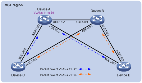

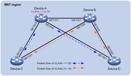

As shown in Figure 1:
·          Device A and Device B are core layer devices. Device C and Device D are aggregation layer devices.
·          Ports on all devices allow packets from VLANs 11 through 30 to pass through.
·          MSTP implements load balancing and link backup for traffic of VLANs 11 through 30 between the core layer devices and the aggregation layer devices.
Configure MVRP on all devices to synchronize and update VLAN information. When the network is stable, set the registration mode to fixed on GigabitEthernet 1/0/1 of Device B to maintain dynamic VLAN information.
Figure 1 Network diagram

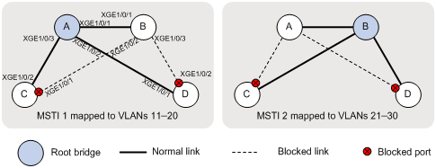

Verifying MSTI topologies
# Display brief spanning tree information on Device A.
[DeviceA] display stp brief
 MST ID   Port                                Role  STP State   Protection
 1        GigabitEthernet1/0/1                DESI  FORWARDING  NONE
 1        GigabitEthernet1/0/2                DESI  FORWARDING  NONE
 1        GigabitEthernet1/0/3                DESI  FORWARDING  NONE
 2        GigabitEthernet1/0/1                ROOT  FORWARDING  NONE
 2        GigabitEthernet1/0/2                DESI  FORWARDING  NONE
 2        GigabitEthernet1/0/3                DESI  FORWARDING  NONE
# Display brief spanning tree information on Device B.
[DeviceB] display stp brief
 1        GigabitEthernet1/0/1                ROOT  FORWARDING  NONE
 2        GigabitEthernet1/0/1                DESI  FORWARDING  NONE
# Display brief spanning tree information on Device C.
[DeviceC] display stp brief
 1        GigabitEthernet1/0/1                ALTE  DISCARDING  NONE
 1        GigabitEthernet1/0/2                ROOT  FORWARDING  NONE
 2        GigabitEthernet1/0/2                ALTE  DISCARDING  NONE
# Display brief spanning tree information on Device D.
[DeviceD] display stp brief
 1        GigabitEthernet1/0/2                ALTE  DISCARDING  NONE
 2        GigabitEthernet1/0/1                ALTE  DISCARDING  NONE
 2        GigabitEthernet1/0/2                ROOT  FORWARDING  NONE

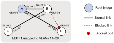

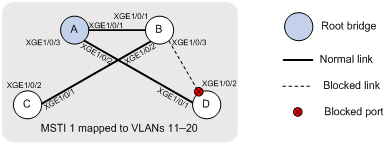

Based on the output, you can get MSTI topologies, as shown in Figure 2.
 0        GigabitEthernet1/0/1                ROOT  FORWARDING  NONE
 0        GigabitEthernet1/0/2                ALTE  DISCARDING  NONE
Based on the output, you can get the topology of MSTI 1, as shown in Figure 3.
