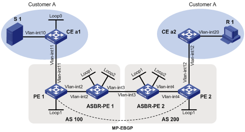

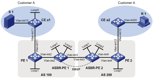

Example: Configuring inter-AS option A MDT-based MVPN
As shown in Figure 2:
·          Customer A has two branches that separately connect to AS 100 and AS 200.
·          ASBR-PE 1 and ASBR-PE 2 are interconnected by using the inter-AS option A solution.
·          PIM-SM runs within the two branches.
·          The multicast source and the receiver host are in different branches.
Configure inter-AS option A MDT-based MVPN so that the receiver host can receive the multicast data from the source.
Figure 2 Network diagram
Device
Interface
IP address
Device
Interface
IP address
S 1
10.11.3.2/24
R 1
10.11.4.2/24
PE 1
Vlan-int2
192.168.1.2/24
ASBR-PE 2
Vlan-int4
192.168.3.2/24
PE 1
Vlan-int11
10.11.1.1/24
ASBR-PE 2
Vlan-int3
192.168.2.2/24
PE 1
Loop1
1.1.1.1/32
ASBR-PE 2
Loop1
1.1.1.3/32
ASBR-PE 1
Vlan-int2
192.168.1.1/24
ASBR-PE 2
Loop2
22.22.22.22/32
ASBR-PE 1
Vlan-int3
192.168.2.1/24
PE 2
Vlan-int4
192.168.3.1/24
ASBR-PE 1
Loop1
1.1.1.2/32
PE 2
Vlan-int12
10.11.2.1/24
ASBR-PE 1
Loop2
11.11.11.11/32
PE 2
Loop1
1.1.1.4/32
CE a1
Vlan-int10
10.11.3.1/24
CE a2
Vlan-int20
10.11.4.1/24
CE a1
Vlan-int11
10.11.1.2/24
CE a2
Vlan-int12
10.11.2.2/24
CE a1
Loopback 0
2.2.2.2/32
Analysis
To meet the network requirement, you must create a separate MVPN for each AS.
Software versions used
This configuration example was created and verified on S6890-CMW710-R2712.
When you configure the inter-AS option A MDT-based MVPN, follow these restrictions and guidelines:
·          You must enable the same PIM mode for all interfaces that belong to the same VPN instance (including the interface associated with the VPN instance). You may enable different PIM modes for the public network in different ASs.
·          You must specify the same default-group for the same MDT-based MVPN instance in the same AS. You may specify different default-groups for the same MVPN instance in different ASs.
·          By default, interfaces on the device are disabled (in ADM or Administratively Down state). To have an interface operate, you must use the undo shutdown command to enable that interface.
Procedures
1.        Assign an IP address and subnet mask to each interface on CE a1, as shown in Table 2.
<CEa1> system-view
[CEa1] interface vlan-interface 10
[CEa1-Vlan-interface10] ip address 10.11.3.1 24
[CEa1-Vlan-interface10] quit
[CEa1] interface loopback 0
[CEa1-LoopBack0] ip address 2.2.2.2 32
[CEa1-LoopBack0] quit
[CEa1] interface vlan-interface 11
[CEa1-Vlan-interface11] ip address 10.11.1.2 24
[CEa1-Vlan-interface11] quit
# Configure PE 1, ASBR-PE 1, ASBR-PE2, PE 2, and CE a2 in the same way CE a1 is configured. (Details not shown.)
2.        Configure a unicast routing protocol and MPLS L3VPN inter-AS option A on all devices so that all devices in the ASs are interoperable at the network layer. (Details not shown)

Example: Configuring inter-AS option C MDT-based MVPN
As shown in Figure 3:
·          ASBR-PE 1 and ASBR-PE 2 are interconnected by using the inter-AS option C solution.
Configure inter-AS option C MDT-based MVPN so that the receiver host can receive the multicast data from the source.
Figure 3 Network diagram

Analysis
To meet the network requirement, you must perform the following tasks:
·          Create the same MVPN for each AS.
·          Establish MSDP peering relationships between the RPs in the ASs to share the multicast source information in different PIM-SM domains.
