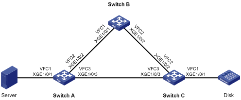

Example: Configuring FC static routes
As shown in Figure 1, configure FCoE to meet the following requirements:
·          Any two FCF switches can communicate with each other.
·          SAN traffic can be transmitted on lossless Ethernet.
·          The server can access the disk device through the fabric.
Figure 1 Network diagram

[SwitchB] vsan 1
[SwitchB-vsan1] undo domain configure enable
# Configure a fabric name in VSAN 1.
[SwitchB-vsan1] fabric-name 11:11:11:11:11:11:11:11
# Configure the domain ID as 2 in VSAN 1.
[SwitchB-vsan1] domain-id 2 static
Non-disruptive reconfiguration or isolating the switch may be performed. Continue? [Y/N]:y
[SwitchB-vsan1] quit
# Create interface VFC 1, and configure it to operate in E mode.
[SwitchB] interface vfc 1
[SwitchB-Vfc1] fc mode e
# Bind interface VFC 1 to interface Ten-GigabitEthernet 1/0/1, and assign VFC 1 to VSAN 1 as a trunk port.
[SwitchB-Vfc1] bind interface ten-gigabitethernet 1/0/1
[SwitchB-Vfc1] port trunk vsan 1
[SwitchB-Vfc1] quit
# Create interface VFC 2, and configure it to operate in E mode.
[SwitchB] interface vfc 2
[SwitchB-Vfc2] fc mode e
# Bind interface VFC 2 to interface Ten-GigabitEthernet 1/0/2, and assign VFC 2 to VSAN 1 as a trunk port.
[SwitchB-Vfc2] bind interface ten-gigabitethernet 1/0/2
[SwitchB-Vfc2] port trunk vsan 1
[SwitchB-Vfc2] quit
# Assign interfaces Ten-GigabitEthernet 1/0/1 and Ten-GigabitEthernet 1/0/2 to VLAN 10 as trunk ports.
[SwitchB] interface range ten-gigabitethernet 1/0/1 to ten-gigabitethernet 1/0/2
[SwitchB-if-range] port link-type trunk
[SwitchB-if-range] port trunk permit vlan 10
[SwitchB-if-range] quit
# Enable FCoE for VLAN 10 and map VLAN 10 to VSAN 1.
[SwitchB] vlan 10
[SwitchB-vlan10] fcoe enable vsan 1
[SwitchB-vlan10] quit
# Permit the members in the default zone of VSAN 1 to access each other.
[SwitchB] vsan 1
[SwitchB-vsan1] zone default-zone permit
# Configure static routes to Switch A and Switch C.
[SwitchB-vsan1] fc route-static 010000 8 vfc 1
[SwitchB-vsan1] fc route-static 030000 8 vfc 2
Configuring Switch C
1.        Configure the advanced mode:
# Configure the switch to operate in advanced mode. (Skip this step if the switch is already operating in advanced mode.)
<SwitchC> system-view
[SwitchC] system-working-mode advance
Do you want to change the system working mode? [Y/N]:y
The system working mode is changed, please save the configuration and reboot the
 system to make it effective.
# Save the configuration.
[SwitchC] save
The current configuration will be written to the device. Are you sure? [Y/N]:y
Please input the file name(*.cfg)[flash:/startup.cfg]
(To leave the existing filename unchanged, press the enter key):
Validating file. Please wait...
Saved the current configuration to mainboard device successfully.
Slot 1:
Save next configuration file successfully.
[SwitchC] quit
# Reboot the switch.
<SwitchC> reboot
Start to check configuration with next startup configuration file, please wait.........DONE!
This command will reboot the device. Continue? [Y/N]:y
Now rebooting, please wait...
2.        Configure DCBX:
# Enable LLDP globally.
[SwitchC] lldp global enable
# Enable LLDP on interface Ten-GigabitEthernet 1/0/2, and enable the interface to advertise DCBX TLVs.
[SwitchC] interface ten-gigabitethernet 1/0/2
[SwitchC-Ten-GigabitEthernet1/0/2] lldp enable
[SwitchC-Ten-GigabitEthernet1/0/2] lldp tlv-enable dot1-tlv dcbx
[SwitchC-Ten-GigabitEthernet1/0/2] quit
# Create a Layer 2 ACL named DCBX.
[SwitchC] acl mac name DCBX
# Configure two rules in the ACL to match FCoE frames (protocol type 0x8906) and FIP frames (protocol type 0x8914).
[SwitchC-acl-ethernetframe-DCBX] rule 0 permit type 8906 ffff
[SwitchC-acl-ethernetframe-DCBX] rule 5 permit type 8914 ffff
[SwitchC-acl-ethernetframe-DCBX] quit
# Create a class named DCBX with the operator as OR, and specify ACL DCBX as the match criterion.
[SwitchC] traffic classifier DCBX operator or
[SwitchC-classifier-DCBX] if-match acl mac name DCBX
[SwitchC-classifier-DCBX] quit
# Create a behavior named DCBX, and configure the action of marking packets with 802.1p priority 3.
[SwitchC] traffic behavior DCBX
[SwitchC-behavior-DCBX] remark dot1p 3
[SwitchC-behavior-DCBX] quit
# Create a QoS policy named DCBX.
[SwitchC] qos policy DCBX
# Associate the class DCBX with the behavior DCBX in the QoS policy, and specify that the class-behavior association applies only to DCBX.
[SwitchC-qospolicy-DCBX] classifier DCBX behavior DCBX mode dcbx
[SwitchC-qospolicy-DCBX] quit
# Apply the QoS policy DCBX to the outbound direction of Ten-GigabitEthernet 1/0/2.
[SwitchC-Ten-GigabitEthernet1/0/2] qos apply policy DCBX outbound
3.        Configure PFC:
# Configure interface Ten-GigabitEthernet 1/0/2 to automatically negotiate with its peer to enable PFC.
[SwitchC-Ten-GigabitEthernet1/0/2] priority-flow-control auto
# Enable PFC for 802.1p priority 3 on the interface.
[SwitchC-Ten-GigabitEthernet1/0/2] priority-flow-control no-drop dot1p 3
# Configure the interface to trust the 802.1p priority carried in packets.
[SwitchC-Ten-GigabitEthernet1/0/2] qos trust dot1p
# Forcibly enable PFC on interface Ten-GigabitEthernet 1/0/1.
[SwitchC] interface ten-gigabitethernet 1/0/1
[SwitchC-Ten-GigabitEthernet1/0/1] priority-flow-control enable
[SwitchC-Ten-GigabitEthernet1/0/1] priority-flow-control no-drop dot1p 3
[SwitchC-Ten-GigabitEthernet1/0/1] qos trust dot1p
[SwitchC-Ten-GigabitEthernet1/0/1] quit
4.        Configure FCoE:
# Configure the switch to operate in FCF mode.
[SwitchC] fcoe-mode fcf
# Disable the fabric configuration function in VSAN 1.
[SwitchC] vsan 1
[SwitchC-vsan1] undo domain configure enable
[SwitchC-vsan1] fabric-name 11:11:11:11:11:11:11:11
# Configure the domain ID as 3 in VSAN 1.
[SwitchC-vsan1] domain-id 3 static
[SwitchC-vsan1] quit
[SwitchC] interface vfc 1
[SwitchC-Vfc1] fc mode e
[SwitchC-Vfc1] bind interface ten-gigabitethernet 1/0/1
[SwitchC-Vfc1] port trunk vsan 1
[SwitchC-Vfc1] quit
# Create interface VFC 2, bind VFC 2 to interface Ten-GigabitEthernet 1/0/2, and assign VFC 2 to VSAN 1 as a trunk port.
[SwitchC] interface vfc 2
[SwitchC-Vfc2] bind interface ten-gigabitethernet 1/0/2
[SwitchC-Vfc2] port trunk vsan 1
[SwitchC-Vfc2] quit
[SwitchC] interface range ten-gigabitethernet 1/0/1 to ten-gigabitethernet 1/0/2
[SwitchC-if-range] port link-type trunk
[SwitchC-if-range] port trunk permit vlan 10
[SwitchC-if-range] quit
[SwitchC] vlan 10
[SwitchC-vlan10] fcoe enable vsan 1
[SwitchC-vlan10] quit
[SwitchC] vsan 1
[SwitchC-vsan1] zone default-zone permit
# Configure static routes to Switch A and Switch B.
[SwitchC-vsan1] fc route-static 010000 8 vfc 1
[SwitchC-vsan1] fc route-static 020000 8 vfc 1
# Verify that Switch A has static routes to Switch B and Switch C.
[SwitchA] display fc routing-table vsan 1
Routing Table: VSAN 1
  Destinations : 6          Routes : 6
  Destination/mask   Protocol   Preference   Cost     Interface
  0x020000/8         STATIC     10           0        Vfc2
  0x030000/8         STATIC     10           0        Vfc2
  0xfffc01/24        DIRECT     0            0        InLoop0
  0xfffffa/24        DIRECT     0            0        InLoop0
  0xfffffc/24        DIRECT     0            0        InLoop0
  0xfffffd/24        DIRECT     0            0        InLoop0
# Verify that Switch B has static routes to Switch A and Switch C.
[SwitchB] display fc routing-table vsan 1
  0x010000/8         STATIC     10           0        Vfc1
  0xfffc02/24        DIRECT     0            0        InLoop0
# Verify that Switch C has static routes to Switch A and Switch B.
[SwitchC] display fc routing-table vsan 1
  0x020000/8         STATIC     10           0        Vfc1
  0xfffc03/24        DIRECT     0            0        InLoop0
# Verify that you can successfully ping Switch C from Switch A.
[SwitchA] fcping fcid fffc03 vsan 1
FCPING fcid 0xfffc03: 128 data bytes, press CTRL_C to break
Reply from 0xfffc03: bytes = 128 time = 23 ms
Reply from 0xfffc03: bytes = 128 time = 9 ms
Reply from 0xfffc03: bytes = 128 time = 19 ms
Reply from 0xfffc03: bytes = 128 time = 14 ms
Reply from 0xfffc03: bytes = 128 time = 25 ms
--- 0xfffc03 fcping statistics ---
5 packet(s) transmitted
5 packet(s) received
0.00% packet loss
round-trip min/avg/max = 9/18/25 ms
Figure 2 Network diagram
Analysis
To meet the network requirements, you must perform the following tasks:
·          To allow SAN traffic to be transmitted on lossless Ethernet:
¡  Configure DCBX, PFC in auto mode, and ETS on the Ethernet interface connecting a switch to a server.
¡  Configure DCBX and PFC in auto mode on the Ethernet interface connecting a switch to a disk.
¡  Forcibly enable PFC on the Ethernet interfaces interconnecting switches.
·          To allow FC packets to be forwarded along the shortest path automatically computed, configure FSPF.
Software versions used
This configuration example was created and verified on S6890-CMW710-R2712.
When you configure FCoE, follow these configuration restrictions and guidelines:
·          Because the network topology is complex, use the dynamic method to build the fabric.
·          Configure the highest switch priority for the FCF switch with better performance, so that FCF switch can be selected as the principal switch.
·          By default, interfaces on the switch are disabled (in ADM or Administratively Down state). To have an interface operate, you must use the undo shutdown command to enable that interface.
Procedures
Configuring Switch A
<SwitchA> system-view
[SwitchA] system-working-mode advance
[SwitchA] save
Slot 1:
[SwitchA] quit
<SwitchA> reboot
2.        Configure DCBX:
[SwitchA] lldp global enable
# Enable LLDP on interface Ten-GigabitEthernet 1/0/1, and enable the interface to advertise DCBX TLVs.
[SwitchA] interface ten-gigabitethernet 1/0/1
[SwitchA-Ten-GigabitEthernet1/0/1] lldp enable
[SwitchA-Ten-GigabitEthernet1/0/1] lldp tlv-enable dot1-tlv dcbx
[SwitchA-Ten-GigabitEthernet1/0/1] quit
[SwitchA] acl mac name DCBX
[SwitchA-acl-ethernetframe-DCBX] rule 0 permit type 8906 ffff
[SwitchA-acl-ethernetframe-DCBX] rule 5 permit type 8914 ffff
[SwitchA-acl-ethernetframe-DCBX] quit
[SwitchA] traffic classifier DCBX operator or
[SwitchA-classifier-DCBX] if-match acl mac name DCBX
[SwitchA-classifier-DCBX] quit
[SwitchA] traffic behavior DCBX
[SwitchA-behavior-DCBX] remark dot1p 3
[SwitchA-behavior-DCBX] quit
[SwitchA] qos policy DCBX
[SwitchA-qospolicy-DCBX] classifier DCBX behavior DCBX mode dcbx
[SwitchA-qospolicy-DCBX] quit
# Apply the QoS policy DCBX to the outbound direction of Ten-GigabitEthernet 1/0/1.
[SwitchA-Ten-GigabitEthernet1/0/1] qos apply policy DCBX outbound
3.        Configure PFC:
# Configure interface Ten-GigabitEthernet 1/0/1 to automatically negotiate with its peer to enable PFC.
[SwitchA-Ten-GigabitEthernet1/0/1] priority-flow-control auto
[SwitchA-Ten-GigabitEthernet1/0/1] priority-flow-control no-drop dot1p 3
[SwitchA-Ten-GigabitEthernet1/0/1] qos trust dot1p
# Forcibly enable PFC on interface Ten-GigabitEthernet 1/0/2.
[SwitchA] interface ten-gigabitethernet 1/0/2
[SwitchA-Ten-GigabitEthernet1/0/2] priority-flow-control enable
[SwitchA-Ten-GigabitEthernet1/0/2] priority-flow-control no-drop dot1p 3
[SwitchA-Ten-GigabitEthernet1/0/2] qos trust dot1p
[SwitchA-Ten-GigabitEthernet1/0/2] quit
4.        Configure ETS:
# Configure the 802.1p-lp priority map as follows:
¡  Map 802.1p priority 3 to local precedence 1 (corresponding to queue 1).
¡  Map all other 802.1p priorities to local precedence 0 (corresponding to queue 0).
[SwitchA] qos map-table dot1p-lp
[SwitchA-maptbl-dot1p-lp] import 3 export 1
[SwitchA-maptbl-dot1p-lp] import 0 1 2 4 5 6 7 export 0
[SwitchA-maptbl-dot1p-lp] quit
# Enable byte-count WRR on Ten-GigabitEthernet 1/0/1.
[SwitchA-Ten-GigabitEthernet1/0/1] qos wrr byte-count
# Assign 50% of the interface bandwidth to queue 1 (af1) for FCoE traffic.
[SwitchA-Ten-GigabitEthernet1/0/1] qos wrr af1 group 1 byte-count 1
# Assign 50% of the interface bandwidth to queue 0 (be) for standard LAN traffic.
[SwitchA-Ten-GigabitEthernet1/0/1] qos wrr be group 1 byte-count 1
# Assign all other queues on Ten-GigabitEthernet 1/0/1 to the SP group.
[SwitchA-Ten-GigabitEthernet1/0/1] qos wrr af2 group sp
[SwitchA-Ten-GigabitEthernet1/0/1] qos wrr af3 group sp
[SwitchA-Ten-GigabitEthernet1/0/1] qos wrr af4 group sp
[SwitchA-Ten-GigabitEthernet1/0/1] qos wrr ef group sp
[SwitchA-Ten-GigabitEthernet1/0/1] qos wrr cs6 group sp
[SwitchA-Ten-GigabitEthernet1/0/1] qos wrr cs7 group sp
5.        Configure FCoE:
[SwitchA] fcoe-mode fcf
# Enable the fabric configuration function in VSAN 1. By default, the fabric configuration function is enabled.
[SwitchA] vsan 1
[SwitchA-vsan1] domain configure enable
# Configure the switch priority as 1, so that Switch A can be selected as the principal switch.
[SwitchA-vsan1] priority 1
[SwitchA-vsan1] quit
# Create interface VFC 1, bind VFC 1 to interface Ten-GigabitEthernet 1/0/1, and assign VFC 1 to VSAN 1 as a trunk port.
[SwitchA] interface vfc 1
[SwitchA-Vfc1] bind interface ten-gigabitethernet 1/0/1
[SwitchA-Vfc1] port trunk vsan 1
[SwitchA-Vfc1] quit
[SwitchA] interface vfc 2
[SwitchA-Vfc2] fc mode e
[SwitchA-Vfc2] bind interface ten-gigabitethernet 1/0/2
[SwitchA-Vfc2] port trunk vsan 1
[SwitchA-Vfc2] quit
# Create interface VFC 3, and configure it to operate in E mode.
[SwitchA] interface vfc 3
[SwitchA-Vfc3] fc mode e
# Bind interface VFC 3 to interface Ten-GigabitEthernet 1/0/3, and assign VFC 3 to VSAN 1 as a trunk port.
[SwitchA-Vfc3] bind interface ten-gigabitethernet 1/0/3
[SwitchA-Vfc3] port trunk vsan 1
[SwitchA-Vfc3] quit
# Assign interfaces Ten-GigabitEthernet 1/0/1 through Ten-GigabitEthernet 1/0/3 to VLAN 10 as trunk ports.
[SwitchA] interface range ten-gigabitethernet 1/0/1 to ten-gigabitethernet 1/0/3
[SwitchA-if-range] port link-type trunk
[SwitchA-if-range] port trunk permit vlan 10
[SwitchA-if-range] quit
[SwitchA] vlan 10
[SwitchA-vlan10] fcoe enable vsan 1
[SwitchA-vlan10] quit
[SwitchA] vsan 1
[SwitchA-vsan1] zone default-zone permit
# Enable FSPF in VSAN 1. By default, FSPF is enabled.
[SwitchA-vsan1] fspf enable
Configuring Switch B
<SwitchB> system-view
[SwitchB] system-working-mode advance
[SwitchB] save
Slot 1:
[SwitchB] quit
<SwitchB> reboot
2.        Configure PFC on interfaces Ten-GigabitEthernet 1/0/1 and Ten-GigabitEthernet 1/0/2:
# Forcibly enable PFC on the interfaces.
[SwitchB-if-range] priority-flow-control enable
# Enable PFC for 802.1p priority 3 on the interfaces.
[SwitchB-if-range] priority-flow-control no-drop dot1p 3
# Configure the interfaces to trust the 802.1p priority carried in packets.
[SwitchB-if-range] qos trust dot1p
3.        Configure FCoE:
[SwitchB] fcoe-mode fcf
[SwitchB] vsan 1
[SwitchB-vsan1] domain configure enable
[SwitchB-vsan1] domain-id 2 preferred
[SwitchB-Vfc1] quit
[SwitchB-Vfc2] quit
[SwitchB] vlan 10
[SwitchB] vsan 1
[SwitchC] save
Slot 1:
[SwitchC] quit
<SwitchC> reboot
2.        Configure DCBX:
[SwitchC-Ten-GigabitEthernet1/0/1] lldp enable
[SwitchC-Ten-GigabitEthernet1/0/1] lldp tlv-enable dot1-tlv dcbx
[SwitchC-Ten-GigabitEthernet1/0/1] qos apply policy DCBX outbound
3.        Configure PFC:
[SwitchC-Ten-GigabitEthernet1/0/1] priority-flow-control auto
# Forcibly enable PFC on interfaces Ten-GigabitEthernet 1/0/2 and Ten-GigabitEthernet 1/0/3.
[SwitchC] interface range ten-gigabitethernet 1/0/2 to ten-gigabitethernet 1/0/3
[SwitchC-if-range] priority-flow-control enable
[SwitchC-if-range] priority-flow-control no-drop dot1p 3
[SwitchC-if-range] qos trust dot1p
4.        Configure FCoE:
[SwitchC] vsan 1
[SwitchC-vsan1] domain configure enable
[SwitchC-vsan1] domain-id 3 preferred
[SwitchC-Vfc1] quit
[SwitchC-Vfc2] fc mode e
[SwitchC-Vfc2] quit
[SwitchC] interface vfc 3
[SwitchC-Vfc3] fc mode e
[SwitchC-Vfc3] bind interface ten-gigabitethernet 1/0/3
[SwitchC-Vfc3] port trunk vsan 1
[SwitchC-Vfc3] quit
[SwitchC] interface range ten-gigabitethernet 1/0/1 to ten-gigabitethernet 1/0/3
[SwitchC] vlan 10
[SwitchC] vsan 1
[SwitchC-vsan1] fspf enable
Verify the configuration on Switch A or Switch C, for example, Switch A.
1.        Verify the configuration when all links are available:
# Display the FSPF neighbor information for VSAN 1.
[SwitchA] display fspf neighbor
FSPF neighbor information of VSAN 1(01):
  Interface   NbrDomain   IfIndex   NbrIfIndex   Dead Time   State
  Vfc2        2           0x68      0x68         00:01:06    Full
  Vfc3        3           0x69      0x69         00:01:06    Full
The output shows that Switch A has two neighbors in VSAN 1 (Switch B with domain ID 2 and Switch C with domain ID 3).
# Display the FC routing table of VSAN 1.
  0x020000/8         FSPF       20           100      Vfc2
  0x030000/8         FSPF       20           100      Vfc3
The output shows that Switch A learned FSPF routes to Switch B and Switch C.
FCPING fcid 0xfffc03: 128 data bytes, press CTRL_C to break.
Reply from 0xfffc03: bytes = 128 time = 1.102 ms
Reply from 0xfffc03: bytes = 128 time = 0.276 ms
Reply from 0xfffc03: bytes = 128 time = 0.253 ms
Reply from 0xfffc03: bytes = 128 time = 0.270 ms
Reply from 0xfffc03: bytes = 128 time = 0.247 ms
0.00% packet loss
round-trip min/avg/max = 0.247/0.430/1.102 ms
# Verify that the path from Switch A to Switch C is Switch A > Switch C, but not Switch A > Switch B > Switch C.
[SwitchA] fctracert fcid fffc03 vsan 1
Route present for: 0xfffc03, press CTRL_C to break.
20:00:00:0b:46:00:02:82(0xfffc01)
20:00:00:05:30:00:18:db(0xfffc03)
Fctracert completed.
2.        Verify the configuration when the link between Switch A and Switch C is disconnected:
  0x030000/8         FSPF       20           200      Vfc2
The output shows that Switch A still has an FSPF route to Switch C.
Reply from 0xfffc03: bytes = 128 time = 2.846 ms
Reply from 0xfffc03: bytes = 128 time = 2.810 ms
Reply from 0xfffc03: bytes = 128 time = 2.799 ms
Reply from 0xfffc03: bytes = 128 time = 2.908 ms
Reply from 0xfffc03: bytes = 128 time = 3.840 ms
0.00% packet loss
round-trip min/avg/max = 2.799/3.041/3.840 ms
# Verify that Switch B is on the path from Switch A to Switch C.
20:00:00:e0:fc:00:c5:18(0xfffc02)
The output shows that FSPF selected an alternative path (Switch A > Switch B > Switch C) after the link between Switch A and Switch C is disconnected.
Configuration files
·          Switch A:
 lldp global enable
 fcoe-mode fcf
vsan 1
 priority 1
vlan 10
 fcoe enable vsan 1
 import 0 export 0
 import 2 export 0
 import 3 export 1
 import 4 export 0
 import 5 export 0
 import 6 export 0
 import 7 export 0
 remark dot1p 3
qos policy DCBX
interface Ten-GigabitEthernet1/0/1
 port link-mode bridge
 port trunk permit vlan 1 10
 qos wrr byte-count
 qos wrr ef group sp
interface Ten-GigabitEthernet1/0/2
interface Ten-GigabitEthernet1/0/3
interface Vfc1
 port trunk vsan 1
 bind interface Ten-GigabitEthernet1/0/1
interface Vfc2
 fc mode e
 port trunk vsan 1
 bind interface Ten-GigabitEthernet1/0/2
interface Vfc3
 fc mode e
 port trunk vsan 1
 bind interface Ten-GigabitEthernet1/0/3
acl mac name DCBX
·          Switch B:
 fcoe-mode fcf
vsan 1
vlan 10
 fcoe enable vsan 1
interface Vfc1
 fc mode e
 port trunk vsan 1
interface Vfc2
 fc mode e
 port trunk vsan 1
·          Switch C:
lldp global enable
 fcoe-mode fcf
vsan 1
vlan 10
 fcoe enable vsan 1
 remark dot1p 3
qos policy DCBX
interface Vfc1
 port trunk vsan 1
interface Vfc2
 fc mode e
 port trunk vsan 1
interface Vfc3
 fc mode e
 port trunk vsan 1
acl mac name DCBX

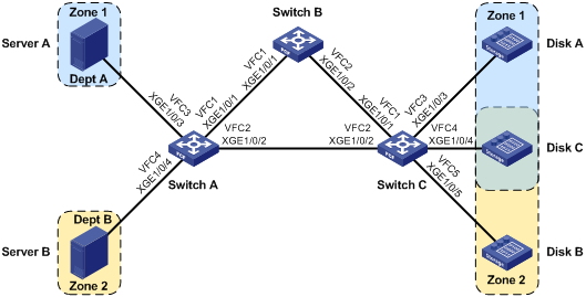

Example: Configuring FC zones
As shown in Figure 3, Disk A is a dedicated disk of Dept A. Disk B is a dedicated disk of Dept B. Disk C is a common disk for Dept A and Dept B. Dept A and Dept B cannot access each other.
Configure FCoE to meet the following requirements:
·          Only Server A can access Disk A.
·          Only Server B can access Disk B.
·          Server A and Server B can access Disk C.
·          Server A and Server B cannot access each other.
Figure 3 Network diagram
Analysis
·          To allow SAN traffic to be transmitted on lossless Ethernet, perform the following tasks:
¡  Configure DCBX and PFC in auto mode on the Ethernet interface connecting a switch to a server.
¡  Configure DCBX, PFC in auto mode, and ETS on the Ethernet interface connecting a switch to a disk.
·          To implement access control in VSAN 1, divide VSAN 1 into two zones:
¡  Zone 1 (containing Server A, Disk A, and Disk C).
¡  Zone 2 (containing Server B, Disk B, and Disk C).
·          Because Zone1 and Zone2 each contain one server and multiple disks, you must enable the Pairwise feature for Zone1 and Zone2. Configure the role of Server A and Server B as initiator, and configure the role of Disk A, Disk B, and Disk C as target.
·          To ensure data consistency across the fabric, configure FC zones on only one switch, activate the zone set, and distribute it to the entire fabric.
Procedures
[SwitchA] save
Slot 1:
[SwitchA] quit
<SwitchA> reboot
2.        Configure DCBX:
# Enable LLDP on interfaces Ten-GigabitEthernet 1/0/3 and Ten-GigabitEthernet 1/0/4, and enable the interfaces to advertise DCBX TLVs.
[SwitchA] interface range ten-gigabitethernet 1/0/3 to ten-gigabitethernet 1/0/4
[SwitchA-if-range] lldp enable
[SwitchA-if-range] lldp tlv-enable dot1-tlv dcbx
# Apply the QoS policy DCBX to the outbound direction of Ten-GigabitEthernet 1/0/3 and Ten-GigabitEthernet 1/0/4.
[SwitchA-if-range] qos apply policy DCBX outbound
3.        Configure PFC:
# Forcibly enable PFC on interfaces Ten-GigabitEthernet 1/0/3 and Ten-GigabitEthernet 1/0/4.
[SwitchA-if-range] priority-flow-control auto
[SwitchA-if-range] priority-flow-control no-drop dot1p 3
[SwitchA-if-range] qos trust dot1p
# Forcibly enable PFC on interfaces Ten-GigabitEthernet 1/0/1 and Ten-GigabitEthernet 1/0/2.
[SwitchA] interface range ten-gigabitethernet 1/0/1 to ten-gigabitethernet 1/0/2
[SwitchA-if-range] priority-flow-control enable
4.        Configure ETS:
a.    Map 802.1p priority 3 to local precedence 1 (corresponding to queue 1).
b.    Map all other 802.1p priorities to local precedence 0 (corresponding to queue 0).
# Enable byte-count WRR on interfaces Ten-GigabitEthernet 1/0/3 and Ten-GigabitEthernet 1/0/4.
[SwitchA-if-range] qos wrr byte-count
[SwitchA-if-range] qos wrr af1 group 1 byte-count 1
[SwitchA-if-range] qos wrr be group 1 byte-count 1
# Assign all other queues on Ten-GigabitEthernet 1/0/3 and Ten-GigabitEthernet 1/0/4 to the SP group.
[SwitchA-if-range] qos wrr af2 group sp
[SwitchA-if-range] qos wrr af3 group sp
[SwitchA-if-range] qos wrr af4 group sp
[SwitchA-if-range] qos wrr ef group sp
[SwitchA-if-range] qos wrr cs6 group sp
[SwitchA-if-range] qos wrr cs7 group sp
5.        Configure FCoE:
# Create VSAN 1.
[SwitchA] vsan 1
[SwitchA-Vfc1] fc mode e
[SwitchA-Vfc1] quit
[SwitchA-Vfc2] quit
# Create interface VFC 3, bind VFC 3 to interface Ten-GigabitEthernet 1/0/3, and assign VFC 3 to VSAN 1 as a trunk port.
[SwitchA-Vfc3] quit
# Create interface VFC 4, bind VFC 4 to interface Ten-GigabitEthernet 1/0/4, and assign VFC 4 to VSAN 1 as a trunk port.
[SwitchA] interface vfc 4
[SwitchA-Vfc4] bind interface ten-gigabitethernet 1/0/4
[SwitchA-Vfc4] port trunk vsan 1
[SwitchA-Vfc4] quit
# Assign interfaces Ten-GigabitEthernet 1/0/1 through Ten-GigabitEthernet 1/0/4 to VLAN 10 as trunk ports.
[SwitchA] interface range ten-gigabitethernet 1/0/1 to ten-gigabitethernet 1/0/4
[SwitchA] vlan 10
[SwitchB] save
Slot 1:
[SwitchB] quit
<SwitchB> reboot
3.        Configure FCoE:
[SwitchB] vsan 1
[SwitchB-Vfc1] quit
[SwitchB-Vfc2] quit
[SwitchB] vlan 10
[SwitchC] save
Slot 1:
[SwitchC] quit
<SwitchC> reboot
2.        Configure DCBX:
# Enable LLDP on interfaces Ten-GigabitEthernet 1/0/3 through Ten-GigabitEthernet 1/0/5, and enable the interfaces to advertise DCBX TLVs.
[SwitchC] interface range ten-gigabitethernet 1/0/3 to ten-gigabitethernet 1/0/5
[SwitchC-if-range] lldp enable
[SwitchC-if-range] lldp tlv-enable dot1-tlv dcbx
# Apply the QoS policy DCBX to the outbound direction of interfaces Ten-GigabitEthernet 1/0/3 through Ten-GigabitEthernet 1/0/5.
[SwitchC-if-range] qos apply policy DCBX outbound
3.        Configure PFC:
# Forcibly enable PFC on the interfaces Ten-GigabitEthernet 1/0/3 through Ten-GigabitEthernet 1/0/5.
[SwitchC-if-range] priority-flow-control auto
# Forcibly enable PFC on the interfaces Ten-GigabitEthernet 1/0/1 and Ten-GigabitEthernet 1/0/2.
4.        Configure FCoE:
# Create VSAN 1.
[SwitchC] vsan 1
[SwitchC-Vfc1] quit
[SwitchC-Vfc2] quit
# Create interface VFC 3, bind it to interface Ten-GigabitEthernet 1/0/3, and assign VFC 3 to VSAN 1 as a trunk port.
[SwitchC-Vfc3] quit
# Create interface VFC 4, bind it to interface Ten-GigabitEthernet 1/0/4, and assign VFC 4 to VSAN 1 as a trunk port.
[SwitchC] interface vfc 4
[SwitchC-Vfc4] bind interface ten-gigabitethernet 1/0/4
[SwitchC-Vfc4] port trunk vsan 1
[SwitchC-Vfc4] quit
# Create interface VFC 5, bind it to interface Ten-GigabitEthernet 1/0/5, and assign VFC 5 to VSAN 1 as a trunk port.
[SwitchC] interface vfc 5
[SwitchC-Vfc5] bind interface ten-gigabitethernet 1/0/5
[SwitchC-Vfc5] port trunk vsan 1
[SwitchC-Vfc5] quit
# Assign interfaces Ten-GigabitEthernet 1/0/1 through Ten-GigabitEthernet 1/0/5 to VLAN 10 as trunk ports.
[SwitchC] interface range ten-gigabitethernet 1/0/1 to ten-gigabitethernet 1/0/5
[SwitchC] vlan 10
Displaying FC SAN establishment
On Switch A
# Display domain information in VSAN 1.
[SwitchA] display fc domain vsan 1
Domain Information of VSAN 1:
  Running time information:
    State: Stable
    Switch WWN:  10:00:00:e0:fc:00:c5:18
    Fabric name: 10:00:00:e0:fc:00:c5:18
    Priority: 1
    Domain ID: 1
  Configuration information:
    Domain configure: Enabled
    Domain auto-reconfigure: Disabled
    Priority: 1
    Domain ID: 1 (preferred)
  Principal switch running time information:
    Priority: 1
    Path               Interface
    Downstream         Vfc1
    Downstream         Vfc2
The output shows that Switch A was selected as the principal switch and assigned itself domain ID 1.
# Display node login information in VSAN 1.
[SwitchA] display fc login vsan 1
Interface VSAN FCID     Node WWN                Port WWN
Vfc3      1    0x010000 21:01:00:1a:32:a0:fa:12 21:01:00:1a:32:a0:fa:11
Vfc4      1    0x010001 21:01:00:1b:32:b0:fb:12 21:01:00:1b:32:b0:fb:11
The output shows that Switch A assigned FC IDs 0x010000 and 0x010001 to Server A and Server B, respectively.
# Display brief information about the name service database in VSAN 1.
[SwitchA] display fc name-service database vsan 1
VSAN 1:
  FCID     Type               PWWN(vendor)                      FC4-type:feature
  0x010000 0x01(N)            21:01:00:1a:32:a0:fa:11           SCSI-FCP:Initiator
  0x010001 0x01(N)            21:01:00:1b:32:b0:fb:11           SCSI-FCP:Initiator
  0x030000 0x01(N)            10:00:00:05:30:00:25:a1           SCSI-FCP:Target
  0x030001 0x01(N)            10:00:00:05:30:00:25:c1           SCSI-FCP:Target
  0x030002 0x01(N)            10:00:00:05:30:00:25:b1           SCSI-FCP:Target
The output shows that all nodes completed name service registrations.
On Switch C
[SwitchC] display fc domain vsan 1
    State: Stable
    Switch WWN:  10:00:74:25:8a:02:4c:00
    Priority: 128
    Domain ID: 3
    Priority: 128
    Domain ID: 3 (preferred)
    Priority: 1
    Path          Interface
    Upstream      Vfc2
The output shows that the principal switch assigned domain ID 3 to Switch C.
[SwitchC] display fc login vsan 1
Vfc3      1    0x030000 10:00:00:05:30:00:25:a1 10:00:00:05:30:00:25:a2
Vfc4      1    0x030001 10:00:00:05:30:00:25:c1 10:00:00:05:30:00:25:c2
Vfc5      1    0x030002 10:00:00:05:30:00:25:b1 10:00:00:05:30:00:25:b2
The output shows that Switch C assigned FC IDs 0x030000, 0x030001, and 0x030002 to Disk A, Disk C, and Disk B, respectively.
[SwitchC] display fc name-service database vsan 1
VSAN 1:
# Enable the enhanced zoning mode in VSAN 1.
[SwitchA-vsan1] zone mode enhanced
The zoning database in this switch would be distributed throughout the fabric. Continue? [Y/N]:y
# Create a zone named Zone1, and enable the Pairwise feature for Zone1. Add FC ID 010000 as its member and specify the role as initiator. Add FC IDs 030000 and 030001 as its members and specify the role as target.
[SwitchA-vsan1] zone name Zone1
[SwitchA-vsan1-zone-Zone1] pairwise-zoning enable
[SwitchA-vsan1-zone-Zone1] member fcid 010000 initiator
[SwitchA-vsan1-zone-Zone1] member fcid 030000 target
[SwitchA-vsan1-zone-Zone1] member fcid 030001 target
[SwitchA-vsan1-zone-Zone1] quit
# Create a zone named Zone2, and enable the Pairwise feature for Zone2. Add FC ID 010001 as its member and specify the role as initiator. Add FC IDs 030001 and 030002 as its members and specify the role as target.
[SwitchA-vsan1] zone name Zone2
[SwitchA-vsan1-zone-Zone2] pairwise-zoning enable
[SwitchA-vsan1-zone-Zone2] member fcid 010001 initiator
[SwitchA-vsan1-zone-Zone2] member fcid 030001 target
[SwitchA-vsan1-zone-Zone2] member fcid 030002 target
[SwitchA-vsan1-zone-Zone2] quit
# Create Zone set 1, and add Zone 1 and Zone 2 as its members.
[SwitchA-vsan1] zoneset name Zoneset1
[SwitchA-vsan1-zoneset-Zoneset1] member Zone1
[SwitchA-vsan1-zoneset-Zoneset1] member Zone2
[SwitchA-vsan1-zoneset-Zoneset1] quit
# Configure zone distribution and merge types as complete distribution and complete merge.
[SwitchA-vsan1] zoneset distribute full
# Activate Zone set 1 as the active zone set, and distribute it to the entire fabric.
[SwitchA-vsan1] zoneset activate name Zoneset1
Verify the configuration on any switch, for example, Switch C.
# Display zone set information for VSAN 1.
<SwitchC> display zoneset vsan 1
VSAN 1:
    zone name Zone1
      fcid 0x010000 initiator
      fcid 0x030000 target
      fcid 0x030001 target
    zone name Zone2
      fcid 0x010001 initiator
      fcid 0x030002 target
The output shows that VSAN 1 was divided into two zones: Zone 1 and Zone 2.
# Display the zones to which FC ID 030001 belongs.
<SwitchC> display zone member fcid 030001
fcid 0x030001
VSAN 1:
    zone Zone1
    zone Zone2
The output shows that Disk C belongs to both Zone 1 and Zone 2 (both Server 1 and Server 2 can access Disk C).
# Display information about the active zone set in VSAN 1.
<SwitchC> display zoneset active vsan 1
VSAN 1:
    zone name Zone1
      *fcid 0x010000
      *fcid 0x030000
      *fcid 0x030001
    zone name Zone2
      *fcid 0x010001
      *fcid 0x030001
      *fcid 0x030002
The output shows that Zone set 1 is the active zone set of VSAN 1.

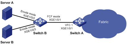

Example: Configuring FIP snooping
As shown in Figure 4, configure FCoE to meet the following requirements:
·          Only successfully registered servers can access the fabric.
Figure 4 Network diagram
Analysis
·          To allow servers to access the fabric, configure the members in the default zone to access each other.
·          To allow only successfully registered servers to access the fabric and to deny access between Server A and Server B, configure FIP snooping on Switch B.
