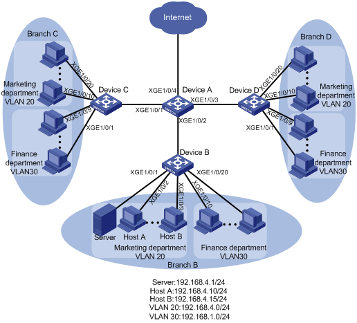

As shown in Figure 1, a company has three branches, each of which has a Marketing department and a Finance department. All Marketing departments belong to VLAN 20. All Finance departments belong to VLAN 30.
Configure traffic filtering to meet the following requirements:
·          HTTP traffic from the Marketing department in each branch is denied.
·          In Branch B, only Host A and Host B can access the server.
·          The Marketing departments in three branches can access one another, and the Finance departments in three branches can access one another.
Figure 1 Network diagram
Analysis
To meet the network requirements, you must perform the following tasks:
·          To deny HTTP traffic from the Marketing departments, use one of the following methods:
¡  Filter outgoing traffic from the subnet 192.168.4.0/24 on the interfaces that connect Device B, Device C, and Device D to Device A.
This method has poor scalability, because new branches require the same configuration on their access switches.
¡  Filter outgoing traffic from the subnet 192.168.4.0/24 on interface Ten-GigabitEthernet 1/0/4 of Device A.
This method wastes processing capabilities of Device A, because Device A must internally forward all incoming traffic to interface Ten-GigabitEthernet 1/0/4.
¡  Configure a QoS policy to deny HTTP traffic from the Marketing departments.
This method can automatically adapt to changing network topologies and also saves hardware resources by denying traffic on the incoming interface. This example uses this method.
·          To allow only Host A and Host B to access the server in Branch B, perform the following tasks:
¡  Configure an ACL on Ten-GigabitEthernet 1/0/1 to allow packets from 192.168.4.10/24 and 192.168.4.15/24.
¡  Set the default packet filtering action to deny to deny packets that do not match the configured ACL.
·          To allow traffic from Marketing departments and Finance departments (except HTTP traffic) to the Internet and to allow access among Marketing departments and among Finance departments, perform the following tasks:
¡  Configure Ten-GigabitEthernet 1/0/1 through Ten-GigabitEthernet 1/0/4 as trunk ports.
¡  Assign these interfaces to VLAN 20 and VLAN 30.
