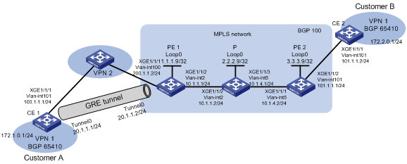

As shown in Figure 1, Customer A and Customer B belong to VPN 1. A network VPN 2 exists between CE 1 and PE 1. Configure MPLS L3VPN for Customer A and Customer B to communicate with each other through VPN.
Figure 1 Network diagram
Analysis
For packets to be transported over the MPLS network, configure an IGP on the MPLS backbone to ensure IP connectivity, and configure LDP to distribute public network labels (outer labels).
To transport VPN routes and distribute private network labels (inner labels), configure MP-BGP and establish BGP peers between the PEs.
For CE1 to access MPLS L3VPN successfully, establish a GRE tunnel between CE 1 and PE 1 to implement logical direct connection between them.
Binding a VPN instance to an interface deletes some configuration (such as the IP address) of the interface. Therefore, bind the VPN instance before configure other settings on an interface.

2.        Configure CE 2:
Configure IP addresses for the CE according to Figure 1. (Details not shown.)

1.        Configure PE 1:
# Configure PE 2 as a BGP peer, and specify interface Loopback 0 as the source interface for TCP connections to the peer.
[PE1] bgp 100
[PE1-bgp-default] peer 3.3.3.9 as-number 100
[PE1-bgp-default] peer 3.3.3.9 connect-interface loopback 0
# Enable BGP VPNv4 route exchange with peer PE 2.
[PE1-bgp-default] address-family vpnv4
[PE1-bgp-default-vpnv4] peer 3.3.3.9 enable
[PE1-bgp-default-vpnv4] quit
[PE1-bgp-default] quit
2.        Configure PE 2:
# Configure PE 1 as a BGP peer, and specify interface Loopback 0 as the source interface for TCP connections to the peer.
[PE2] bgp 100
[PE2-bgp-default] peer 1.1.1.9 as-number 100
[PE2-bgp-default] peer 1.1.1.9 connect-interface loopback 0
# Enable BGP VPNv4 route exchange with peer PE 1.
[PE2-bgp-default] address-family vpnv4
[PE2-bgp-default-vpnv4] peer 1.1.1.9 enable
[PE2-bgp-default-vpnv4] quit
[PE2-bgp-default] quit
3.        Verify that a BGP peer relationship in Established state has been established between the PEs.
[PE1] display bgp peer vpnv4
BGP local router ID: 1.1.1.9
 Local AS number: 100
 Total number of peers: 1                  Peers in established state: 1
  Peer                    AS  MsgRcvd  MsgSent OutQ PrefRcv Up/Down  State
  3.3.3.9                100        8        8    0       0 00:00:08 Established
