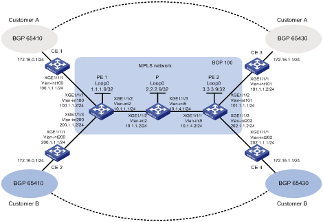

As shown in Figure 1, configure MPLS L3VPN to allow communication between different sites of a customer and to isolate different customers.
Figure 1 Network diagram
Analysis
To generate inner labels, and deliver VPN routing information to the remote PE, configure MP-BGP peers between PEs.
To generate outer labels to tunnel the VPN packets over the MPLS backbone, configure a routing protocol and MPLS LDP on the MPLS backbone.
To identify routing information for different customers on PEs, perform the following tasks on each PE:
·          Create a VPN instance for each customer.
·          Configure an RD and route targets for each VPN instance.
·          Redistribute internal routes of each site to the corresponding VPN instance.
Associating an interface with a VPN instance deletes the IP address of the interface. You must reconfigure the interface's IP address after the association.

4.        Establish EBGP peer relationships between PEs and CEs, and redistribute VPN routes into BGP:
# On PE 1, create BGP process 100.
[PE1] bgp 100
# On PE 1, specify CE 1 as a peer and redistribute direct routes of CE 1 into the BGP routing table of VPN instance customerA.
[PE1-bgp-default] ip vpn-instance customerA
[PE1-bgp-default-customerA] peer 100.1.1.1 as-number 65410
[PE1-bgp-default-customerA] address-family ipv4 unicast
[PE1-bgp-default-ipv4-customerA] peer 100.1.1.1 enable
[PE1-bgp-default-ipv4-customerA] import-route direct
[PE1-bgp-default-ipv4-customerA] quit
[PE1-bgp-default-customerA] quit
# On PE 1, specify CE 2 as a peer and redistribute direct routes of CE 2 into the BGP routing table of VPN instance customerB.
[PE1-bgp-default] ip vpn-instance customerB
[PE1-bgp-default-customerB] peer 200.1.1.1 as-number 65410
[PE1-bgp-default-customerB] address-family ipv4 unicast
[PE1-bgp-default-ipv4-customerB] peer 200.1.1.1 enable
[PE1-bgp-default-ipv4-customerB] import-route direct
[PE1-bgp-default-ipv4-customerB] quit
[PE1-bgp-default-customerB] quit
[PE1-bgp-default] quit
# On PE 2, create BGP process 100.
[PE2] bgp 100
# On PE 2, specify CE 3 as a peer and redistribute direct routes of CE 3 into the BGP routing table of VPN instance customerA.
[PE2-bgp-default] ip vpn-instance customerA
[PE2-bgp-default-customerA] peer 101.1.1.2 as-number 65430
[PE2-bgp-default-customerA] address-family ipv4 unicast
[PE2-bgp-default-ipv4-customerA] peer 101.1.1.2 enable
[PE2-bgp-default-ipv4-customerA] import-route direct
[PE2-bgp-default-ipv4-customerA] quit
[PE2-bgp-default-customerA] quit
# On PE 2, specify CE 4 as a peer and redistribute direct routes of CE 4 into the BGP routing table of VPN instance customerB.
[PE2-bgp-default] ip vpn-instance customerB
[PE2-bgp-default-customerB] peer 202.1.1.1 as-number 65430
[PE2-bgp-default-customerB] address-family ipv4 unicast
[PE2-bgp-default-ipv4-customerB] peer 202.1.1.1 enable
[PE2-bgp-default-ipv4-customerB] import-route direct
[PE2-bgp-default-ipv4-customerB] quit
[PE2-bgp-default-customerB] quit
[PE2-bgp-default] quit
# On CE 1, create BGP process 65410, specify 100.1.1.2 as the peer, and specify the peer's AS number as 100.
<CE1> system-view
[CE1] bgp 65410
[CE1-bgp-default] peer 100.1.1.2 as-number 100
# On CE 1, enable BGP to exchange IPv4 unicast routing information with peer 100.1.1.2.
[CE1-bgp-default] address-family ipv4 unicast
[CE1-bgp-default-ipv4] peer 100.1.1.2 enable
# On CE 1, redistribute the direct route for the site into EBGP.
[CE1-bgp-default-ipv4] import-route direct
[CE1-bgp-default-ipv4] quit
[CE1-bgp-default] quit
# On CE 2, create BGP process 65410, specify 200.1.1.2 as the peer, and specify the peer's AS number as 100.
<CE2> system-view
[CE2] bgp 65410
[CE2-bgp-default] peer 200.1.1.2 as-number 100
# On CE 2, enable BGP to exchange IPv4 unicast routing information with peer 200.1.1.2.
[CE2-bgp-default] address-family ipv4 unicast
[CE2-bgp-default-ipv4] peer 200.1.1.2 enable
# On CE 2, redistribute the direct route for the site into EBGP.
[CE2-bgp-default-ipv4] import-route direct
[CE2-bgp-default-ipv4] quit
[CE2-bgp-default] quit
# On CE 3, create BGP process 65430, specify 101.1.1.1 as the peer, and specify the peer's AS number as 100.
<CE3> system-view
[CE3] bgp 65430
[CE3-bgp-default] peer 101.1.1.1 as-number 100
# On CE 3, enable BGP to exchange IPv4 unicast routing information with peer 101.1.1.1.
[CE3-bgp-default] address-family ipv4 unicast
[CE3-bgp-default-ipv4] peer 101.1.1.1 enable
# On CE 3, redistribute the direct route for the site into EBGP.
[CE3-bgp-default-ipv4] import-route direct
[CE3-bgp-default-ipv4] quit
[CE3-bgp-default] quit
# On CE 4, create BGP process 65430, specify 202.1.1.2 as the peer, and specify the peer's AS number as 100.
<CE4> system-view
[CE4] bgp 65430
[CE4-bgp-default] peer 202.1.1.2 as-number 100
# On CE 4, enable BGP to exchange IPv4 unicast routing information with peer 202.1.1.2.
[CE4-bgp-default] address-family ipv4 unicast
[CE4-bgp-default-ipv4] peer 202.1.1.2 enable
# On CE 4, redistribute the direct route for the site into EBGP.
[CE4-bgp-default-ipv4] import-route direct
[CE4-bgp-default-ipv4] quit
[CE4-bgp-default] quit

5.        Create an MP-IBGP peer relationship between PEs:
# On PE 1, configure 3.3.3.9 as the BGP peer and specify Loopback 0 as the source interface for sending routing updates to the peer.
[PE1] bgp 100
[PE1-bgp-default] peer 3.3.3.9 as-number 100
[PE1-bgp-default] peer 3.3.3.9 connect-interface loopback 0
# On PE 1, enable the peer 3.3.3.9 for the BGP-VPNv4 address family.
[PE1-bgp-default] address-family vpnv4
[PE1-bgp-default-vpnv4] peer 3.3.3.9 enable
[PE1-bgp-default-vpnv4] quit
# On PE 2, configure 1.1.1.9 as the BGP peer and specify Loopback 0 as the source interface for sending routing updates to the peer.
[PE2] bgp 100
[PE2-bgp-default] peer 1.1.1.9 as-number 100
[PE2-bgp-default] peer 1.1.1.9 connect-interface loopback 0
# On PE 2, enable the peer 1.1.1.9 for the BGP-VPNv4 address family.
[PE2-bgp-default] address-family vpnv4
[PE2-bgp-default-vpnv4] peer 1.1.1.9 enable
[PE2-bgp-default-vpnv4] quit
# Verify that a BGP peer relationship in Established state has been established between the PEs.
[PE1] display bgp peer vpnv4
 BGP local router ID: 1.1.1.9
 Local AS number: 100
 Total number of peers: 1                  Peers in established state: 1
  * - Dynamically created peer
  Peer                    AS  MsgRcvd  MsgSent OutQ PrefRcv Up/Down  State
  3.3.3.9                100        8        8    0       0 00:00:08 Established

·          PE 1:
 route-distinguisher 100:1
 vpn-target 111:1 import-extcommunity
 vpn-target 222:1 export-extcommunity
 route-distinguisher 200:1
 vpn-target 333:1 import-extcommunity
 vpn-target 444:1 export-extcommunity
ospf 1
 area 0.0.0.0
  network 1.1.1.9 0.0.0.0
  network 10.1.1.0 0.0.0.255
 mpls lsr-id 1.1.1.9
vlan 2
vlan 100
vlan 200
mpls ldp
interface LoopBack0
 ip address 1.1.1.9 255.255.255.255
interface Vlan-interface2
 mpls enable
 mpls ldp enable
interface Vlan-interface100
 ip binding vpn-instance customerA
 ip address 100.1.1.2 255.255.255.0
interface Vlan-interface200
 ip binding vpn-instance customerB
 ip address 200.1.1.2 255.255.255.0
interface Ten-GigabitEthernet1/1/1
 port link-mode bridge
 port access vlan 100
interface Ten-GigabitEthernet1/1/2
 port access vlan 2
interface Ten-GigabitEthernet1/1/3
 port access vlan 200
bgp 100
 peer 3.3.3.9 connect-interface LoopBack0
  peer 3.3.3.9 enable
   import-route direct
   import-route direct
·          P:
ospf 1
 area 0.0.0.0
  network 2.2.2.9 0.0.0.0
  network 10.1.4.0 0.0.0.255
 mpls lsr-id 2.2.2.9
vlan 2
vlan 5
mpls ldp
interface LoopBack0
 ip address 2.2.2.9 255.255.255.255
 ip address 10.1.1.2 255.255.255.0
 mpls enable
 mpls ldp enable
interface Vlan-interface5
 ip address 10.1.4.1 255.255.255.0
 mpls enable
 mpls ldp enable
 port access vlan 2
 port access vlan 5
·          PE 2:
 vpn-target 111:1 export-extcommunity
 vpn-target 222:1 import-extcommunity
 vpn-target 333:1 export-extcommunity
 vpn-target 444:1 import-extcommunity
ospf 1
 area 0.0.0.0
  network 3.3.3.9 0.0.0.0
 mpls lsr-id 3.3.3.9
vlan 5
vlan 101
vlan 202
mpls ldp
interface LoopBack0
 ip address 3.3.3.9 255.255.255.255
 ip address 10.1.4.2 255.255.255.0
 mpls enable
 mpls ldp enable
interface Vlan-interface101
 ip address 101.1.1.1 255.255.255.0
interface Vlan-interface202
 ip address 202.1.1.2 255.255.255.0
 port access vlan 5
 port access vlan 101
 port access vlan 202
bgp 100
 peer 1.1.1.9 connect-interface LoopBack0
  peer 1.1.1.9 enable
   import-route direct
   import-route direct
·          CE 1:
vlan 100
 ip address 100.1.1.1 255.255.255.0
bgp 65410
  import-route direct
·          CE 2:
vlan 200
 ip address 200.1.1.1 255.255.255.0
bgp 65410
  import-route direct
·          CE 3:
vlan 101
 ip address 101.1.1.2 255.255.255.0
bgp 65430
  import-route direct
·          CE 4:
vlan 202
 ip address 202.1.1.1 255.255.255.0
bgp 65430
  import-route direct
