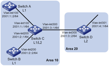

IPv6 IS-IS basic configuration example
Network requirements
As shown in Figure 1, Switch A, Switch B, Switch C, and Switch D, all enabled with IPv6, reside in the same AS. Configure IPv6 IS-IS on the switches so that they can reach each other.
Switch A and Switch B are Level-1 switches, Switch D is a Level-2 switch, and Switch C is a Level-1-2 switch.
Figure 1 Network diagram
Configuration procedure
1.     Configure IPv6 addresses for interfaces. (Details not shown.)
2.     Configure IPv6 IS-IS:
# Configure Switch A.
<SwitchA> system-view
[SwitchA] isis 1
[SwitchA-isis-1] is-level level-1
[SwitchA-isis-1] network-entity 10.0000.0000.0001.00
[SwitchA-isis-1] ipv6 enable
[SwitchA-isis-1] quit
[SwitchA-Vlan-interface100] isis ipv6 enable 1
# Configure Switch B.
<SwitchB> system-view
[SwitchB] isis 1
[SwitchB-isis-1] is-level level-1
[SwitchB-isis-1] network-entity 10.0000.0000.0002.00
[SwitchB-isis-1] ipv6 enable
[SwitchB-isis-1] quit
[SwitchB] interface vlan-interface 200
[SwitchB-Vlan-interface200] isis ipv6 enable 1
[SwitchB-Vlan-interface200] quit
# Configure Switch C.
<SwitchC> system-view
[SwitchC] isis 1
[SwitchC-isis-1] network-entity 10.0000.0000.0003.00
[SwitchC-isis-1] ipv6 enable
[SwitchC-isis-1] quit
[SwitchC] interface vlan-interface 100
[SwitchC-Vlan-interface100] isis ipv6 enable 1
[SwitchC-Vlan-interface100] quit
[SwitchC] interface vlan-interface 200
[SwitchC-Vlan-interface200] isis ipv6 enable 1
[SwitchC-Vlan-interface200] quit
[SwitchC] interface vlan-interface 300
[SwitchC-Vlan-interface300] isis ipv6 enable 1
[SwitchC-Vlan-interface300] quit
# Configure Switch D.
<SwitchD> system-view
[SwitchD] isis 1
[SwitchD-isis-1] is-level level-2
[SwitchD-isis-1] network-entity 20.0000.0000.0004.00
[SwitchD-isis-1] ipv6 enable
[SwitchD-isis-1] quit
[SwitchD] interface vlan-interface 300
[SwitchD-Vlan-interface300] isis ipv6 enable 1
[SwitchD-Vlan-interface300] quit
[SwitchD] interface vlan-interface 301
[SwitchD-Vlan-interface301] isis ipv6 enable 1
[SwitchD-Vlan-interface301] quit

                         Level-1 IPv6 Forwarding Table
 Destination : 2001:1::                                PrefixLen: 64
 Flag        : D/L/-                                   Cost     : 10
 Next Hop    : Direct                                  Interface: Vlan100
 Destination : 2001:2::                                PrefixLen: 64
 Next Hop    : Direct                                  Interface: Vlan200
 Destination : 2001:3::                                PrefixLen: 64
 Next Hop    : Direct                                  Interface: Vlan300
      Flags: D-Direct, R-Added to Rib, L-Advertised in LSPs, U-Up/Down Bit Set
                         Level-2 IPv6 Forwarding Table
 Destination : 2001:4::1                               PrefixLen: 128
 Flag        : R/-/-                                   Cost     : 10
 Next Hop    : FE80::20F:E2FF:FE3E:FA3D                Interface: Vlan300
# Display the IPv6 IS-IS routing table on Switch D.
[SwitchD] display isis route ipv6
                         Route information for IS-IS(1)
 Flag        : R/-/-                                   Cost     : 20
 Next Hop    : FE80::200:FF:FE0F:4                     Interface: Vlan300
 Flag        : D/L/-                                   Cost     : 0
 Next Hop    : Direct                                  Interface: Loop1
